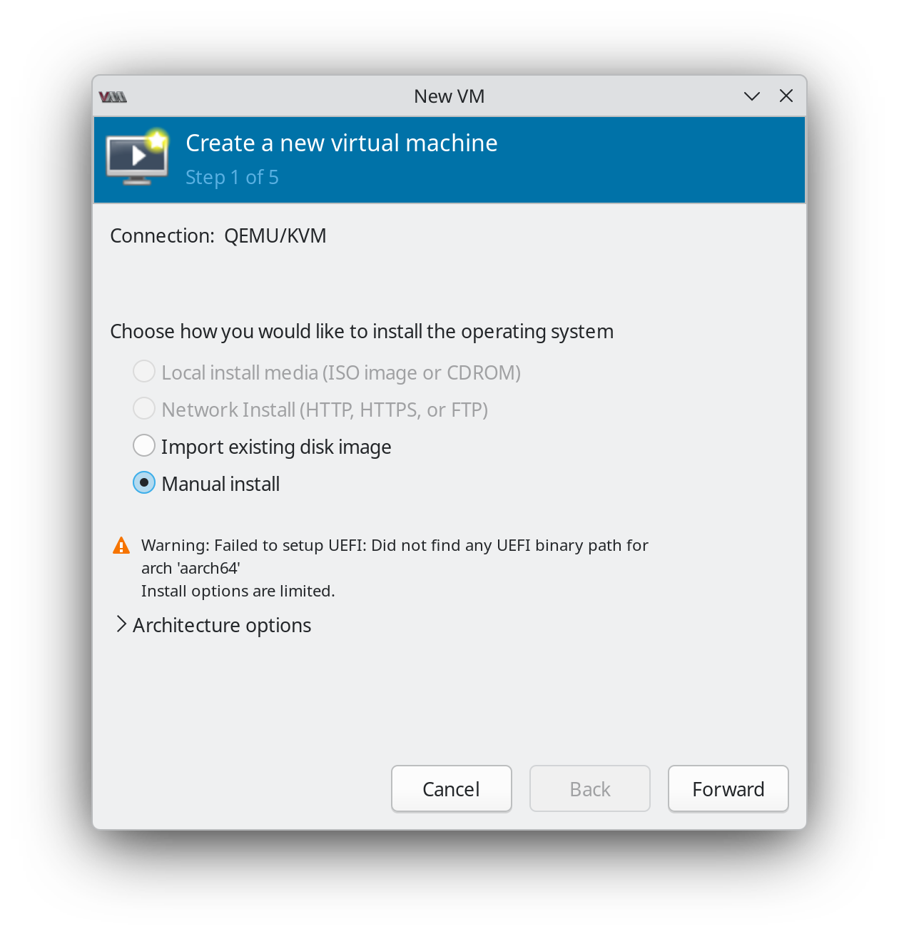

So far its working great, but I struggle with KVM/QEMU related stuff.
While in Incus I run into an issue like this:

With virt-manager it looks a bit different, but maybe its the same?
Looking at the error messages its very likely the have different problems, but who knows maybe both missing some EFI stuff?
The two problems are unrelated.
The problem with Incus is that Colima spawns a virtual machine within which Incus is run. Because M1 Macs don’t support nesting, you can’t run a VM within the Colima VM. Maybe it’s not the problem you’re facing, as I don’t recognize this specific error message…
For the second one, you’ll have to find matching UEFI binaries (can’t help you with that one).
Which distro are you running? I assume you are on Asahi on M1/M2
If you are using Ubuntu or Debian, ensure that you install Incus from Zabbly packages.
Virt-Manager is not happy on Ubuntu, but both Incus and Virt-Manager works fine on Debian.
There are multiple quirks I had to deal to get Incus to work reliably on Fedora Asahi, and I was unable to get Incus to launch virtual machines at all.
In short, from my own experience on Asahi on M1.
  • Fedora - Incus only run containers, Virt-Manager works fine.
  • Ubuntu - Incus runs containers and VMs (if installed via Zabbly), Virt-Manager has issues.
  • Debian - Incus runs containers and VMs (if installed via Zabbly), Virt-Manager works fine.
But if you’re running Incus on macOS with Colima, then you need an M3 or newer device to launch virtual machines.
