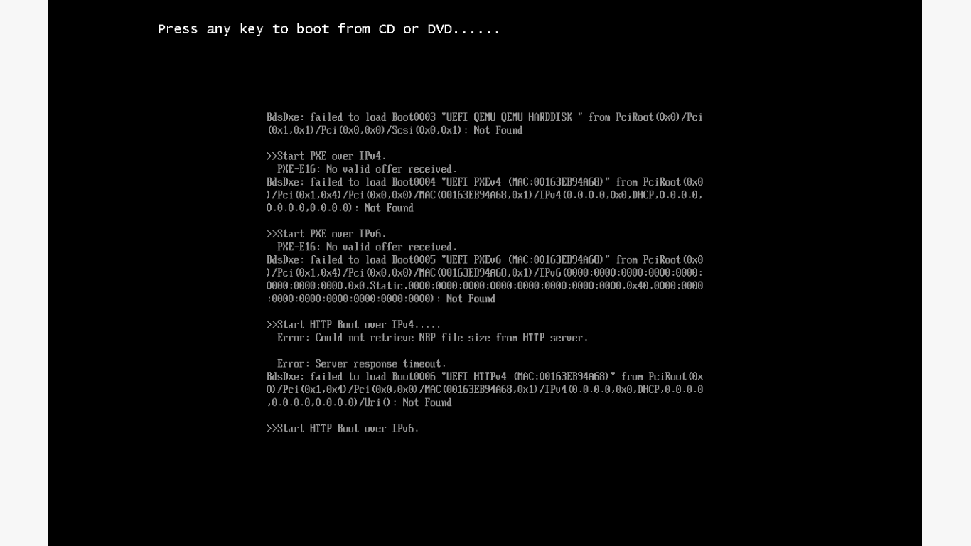

In the end in the virt-viewer I eventually get ’ Failed to start Boot0001 “UEFI QEMU DVD-ROM” Time out’ and the windows setup fails to showup.

Got any assist on the screen/console error message I shared?
Can you show lxc config show <instance> --expanded, it looks like the boot order of the disk device is incorrect.

Hrm, maybe there’s an issue with the ISO.
@monstermunchkin have you experienced this?
The topic title says Windows 11, but this suggests Windows 10.
I run both installations. Just to confirm, but same error. Here’s win11’s;

Your screenshots suggest that you didn’t press a key to boot from CD/DVD. This is necessary to actually install Windows.
Started off nicely, then;
‘Error: websocket: close 1006 (abnormal closure): unexpected EOF’
Can you reconnect to the console?
Installing now. Looking good!
Keeps disconnecting, unfortunately.
Done! Thanks
