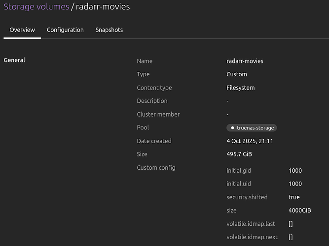

I have somewhat a similar issue, but I think snapshots should not be the cause of my problem.
I’m using one pool with the TrueNAS driver with a single HDD. I have created two volumes to store my media content. However, the size of the volumes seems to be capped way below the actual limit of the pool.
Screenshot_2025-12-17_23-32-47
I tried to change the size parameter in the different volumes, but it doesn’t seem to impact that much
Am I missing something here?
