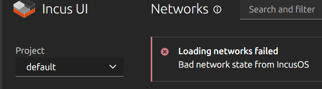

Hi, I’m having problems after installing IncusOS 202511292320 today on an ASUS NUC 15 Pro (Intel Ultra 7 255H with Intel 2.5G igc NIC). The IncusOS networking fails to return any information
When I go to the web UI, and select the networking tab I get:
When I try to show network information via the incus cli commandincus admin os system network show the response is:
Error: open /sys/class/net/_pc84bd6d7eda7/speed: no such file or directory

Sounds like some kind of kernel issue as you’d expect that particular sysfs entry to exist.
Thanks! That PR looks like it matches the error I’m seeing. Once it’s available in an update, I’ll test again and confirm that it is resolved.
Hi again, I’ve updated the OS to the testing channel version 202512022133 that contains the PR merge and I can confirm that I’m now able to see the network info from commandincus admin os system network show along with the web ui networking tab.
