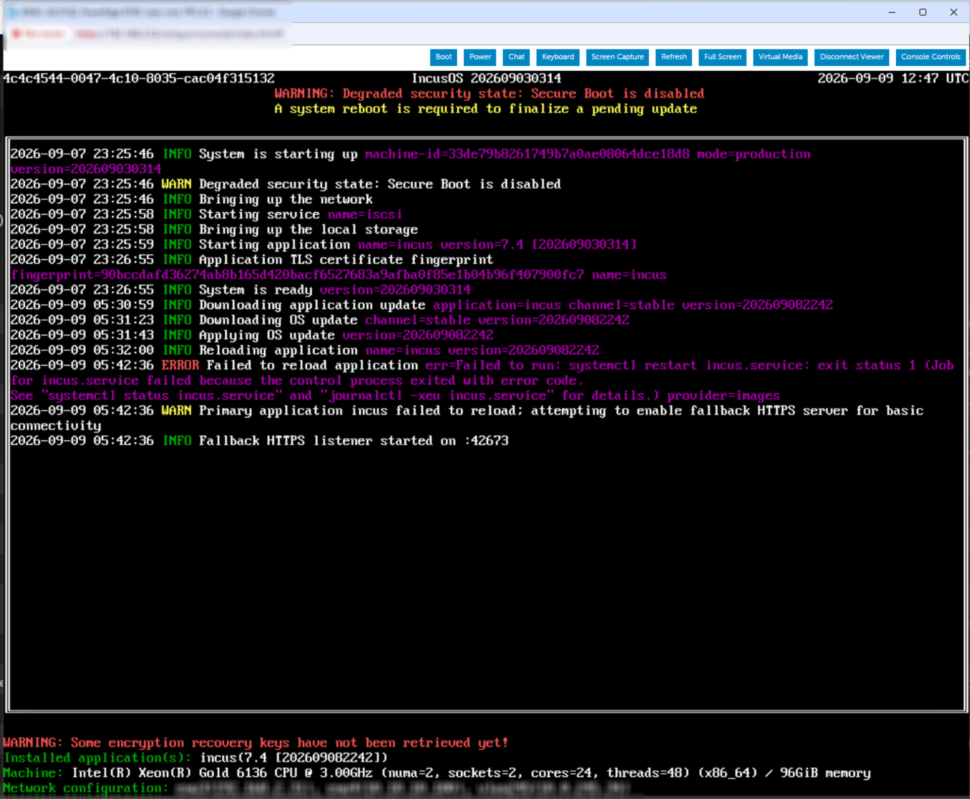

I have a 3 node incusOS cluster. Looked at it this morning and all 3 nodes were down and only responding on the fall back port.
they all looked something like this:
the log is mostly about the cluster breaking - stuff like this:

anyhow I’m just going to reboot all 3 nodes and see what happens
Also the same problem with DELL PowerEdge servers. Check BIOS and storage updates. I had a pending critical BIOS update. After installing updates and updating secure boot certificates, I was able to successfully boot into IncusOS 202609082242.
I’ll look into the crash as that’s the main clue we’ve got in here so far.
The only available update I had was for IDRAC which didn’t fix the issue. I’m just gonna rebuild all 3.
I’ve got an Incus fix for the crash, but if that’s just an Incus race, rebooting the servers should get things back up.
Would be good to do some testing on that if you haven’t wiped them yet as I want to make sure there’s no other issue lingering.

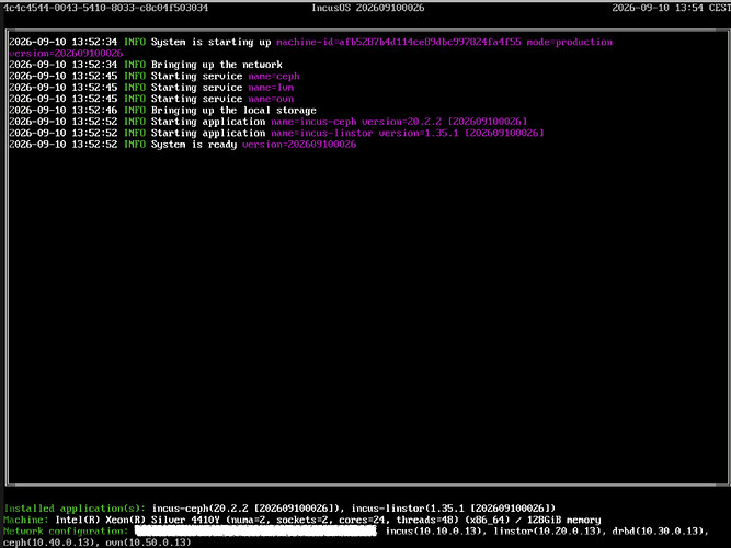

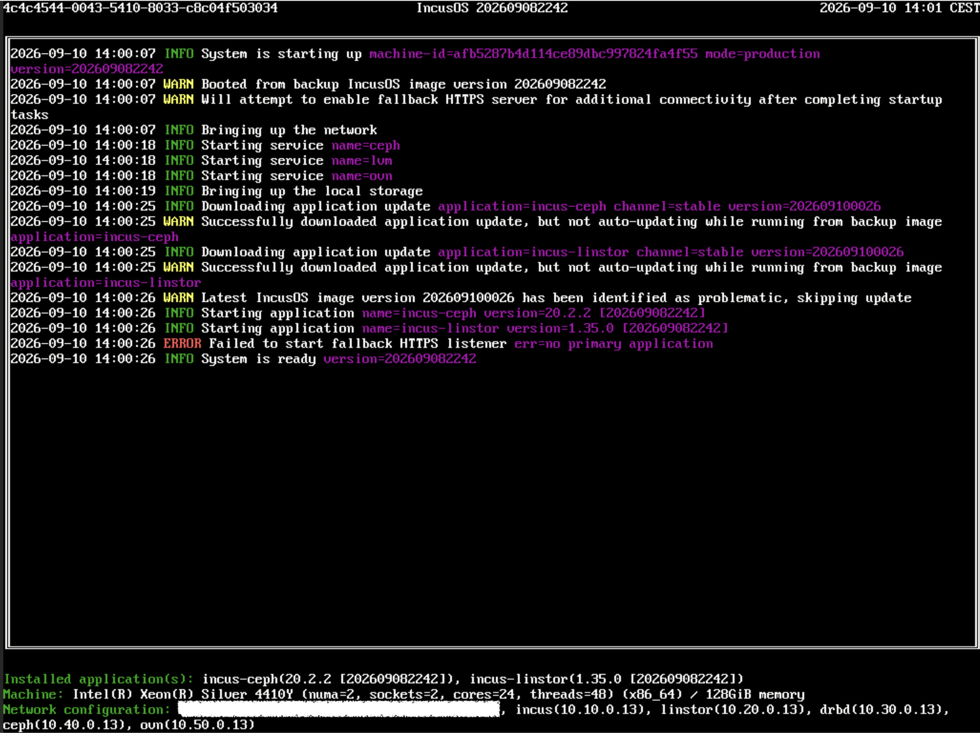

Looks like it is a race. Sometimes IncusOS boots, sometimes not. Unfortunately I cannot start the fallback listener to get the logs. Probably I pasted TLS certificate incorrectly. Is there a way to manually test connection to fallback-listener when the server is operational to test if it is actually working?
Also booting the previous version for me does not get passed the screen “IncusOS is tarting…”.
I’ve got some planned work to fix that part of the fallback listener so we can have it run all the time too.

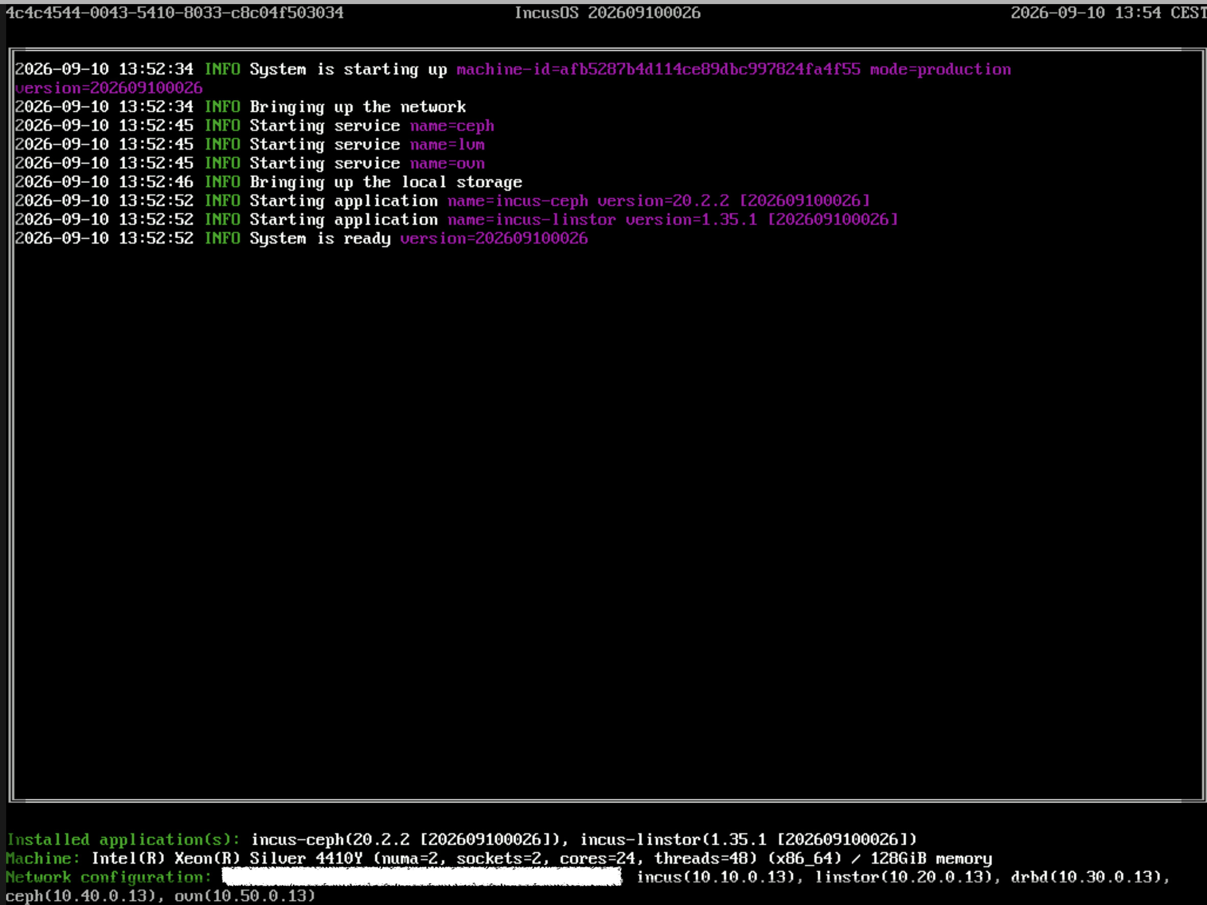

Update:
The fallback server was working fine. The problem was that I tried to add it using incus remote add, and that required the Incus application running. After manually adding the address to ~/.config/incus/config.yml and downloading its TLS certificate to ~/.config/incus/servercerts/ I was able to interact with fallback-listener using incus admin os commands.
I downloaded the logs, but do not see any obvious errors:
[2026/09/10 11:47:50 CEST] incus-osd: 2026-09-10 11:47:50 INFO System is starting up machine-id=afb5287b4d114ce89dbc997824fa4f55 mode=production version=202609082242
[2026/09/10 11:48:56 CEST] incus-osd: 2026-09-10 11:48:56 INFO Starting application name=incus-ceph version=20.2.2 [202609082242]
[2026/09/10 11:48:56 CEST] incus-osd: 2026-09-10 11:48:56 INFO Starting application name=incus-linstor version=1.35.0 [202609082242]
[2026/09/10 11:48:56 CEST] incus-osd: 2026-09-10 11:48:56 INFO Starting application name=incus version=7.4 [202609082242]
[2026/09/10 11:48:56 CEST] systemd: Starting incus.socket - Incus - Daemon (unix socket)...
[2026/09/10 11:48:56 CEST] systemd: Listening on incus.socket - Incus - Daemon (unix socket).
[2026/09/10 11:48:56 CEST] systemd: Starting incus-lxcfs.service - Incus - LXCFS daemon...
[2026/09/10 11:48:56 CEST] systemd: Starting incus-startup.service - Incus - Startup check...
[2026/09/10 11:48:56 CEST] systemd: Started incus-lxcfs.service - Incus - LXCFS daemon.
[2026/09/10 11:48:56 CEST] audit: SERVICE_START pid=1 uid=0 auid=4294967295 ses=4294967295 subj=unconfined msg='unit=incus-lxcfs comm="systemd" exe="/usr/lib/systemd/systemd" hostname=? addr=? terminal=? res=success'
[2026/09/10 11:48:56 CEST] (lxcfs): incus-lxcfs.service: Referenced but unset environment variable evaluates to an empty string: LXCFS_OPTS
[2026/09/10 11:48:56 CEST] systemd: Starting incus.service - Incus - Daemon...
[2026/09/10 11:48:56 CEST] lxcfs: Starting LXCFS at /opt/incus/bin/lxcfs
[2026/09/10 11:48:56 CEST] (incusd): incus.service: Referenced but unset environment variable evaluates to an empty string: INCUS_OPTS
[2026/09/10 11:48:57 CEST] incusd: time="2026-09-10T11:48:57+02:00" level=warning msg="QMP monitor read failed" err="read unix @->/tmp/852717719: use of closed network connection"
[2026/09/10 11:50:22 CEST] incusd: time="2026-09-10T11:50:22+02:00" level=error msg="Failed connecting to global database" attempt=6 err="failed to create cowsql connection: no available cowsql leader server found"
[2026/09/10 11:50:35 CEST] incusd: time="2026-09-10T11:50:35+02:00" level=error msg="Failed connecting to global database" attempt=7 err="failed to create cowsql connection: no available cowsql leader server found"
[2026/09/10 11:50:47 CEST] incusd: time="2026-09-10T11:50:47+02:00" level=error msg="Failed connecting to global database" attempt=8 err="failed to create cowsql connection: no available cowsql leader server found"
[2026/09/10 11:50:59 CEST] incusd: time="2026-09-10T11:50:59+02:00" level=error msg="Failed connecting to global database" attempt=9 err="failed to create cowsql connection: no available cowsql leader server found"
[2026/09/10 11:51:12 CEST] incusd: time="2026-09-10T11:51:12+02:00" level=error msg="Failed connecting to global database" attempt=10 err="failed to create cowsql connection: no available cowsql leader server found"
[2026/09/10 11:51:24 CEST] incusd: time="2026-09-10T11:51:24+02:00" level=error msg="Failed connecting to global database" attempt=11 err="failed to create cowsql connection: no available cowsql leader server found"
[2026/09/10 11:51:37 CEST] incusd: time="2026-09-10T11:51:37+02:00" level=error msg="Failed connecting to global database" attempt=12 err="failed to create cowsql connection: no available cowsql leader server found"
[2026/09/10 11:51:49 CEST] incusd: time="2026-09-10T11:51:49+02:00" level=error msg="Failed connecting to global database" attempt=13 err="failed to create cowsql connection: no available cowsql leader server found"
[2026/09/10 11:52:01 CEST] incusd: time="2026-09-10T11:52:01+02:00" level=error msg="Failed connecting to global database" attempt=14 err="failed to create cowsql connection: no available cowsql leader server found"
[2026/09/10 11:52:14 CEST] incusd: time="2026-09-10T11:52:14+02:00" level=error msg="Failed connecting to global database" attempt=15 err="failed to create cowsql connection: no available cowsql leader server found"
[2026/09/10 11:53:16 CEST] incusd: time="2026-09-10T11:53:16+02:00" level=error msg="Failed connecting to global database" attempt=20 err="failed to create cowsql connection: no available cowsql leader server found"
[2026/09/10 11:54:18 CEST] incusd: time="2026-09-10T11:54:18+02:00" level=error msg="Failed connecting to global database" attempt=25 err="failed to create cowsql connection: no available cowsql leader server found"
[2026/09/10 11:55:20 CEST] incusd: time="2026-09-10T11:55:20+02:00" level=error msg="Failed connecting to global database" attempt=30 err="failed to create cowsql connection: no available cowsql leader server found"
[2026/09/10 11:56:22 CEST] incusd: time="2026-09-10T11:56:22+02:00" level=error msg="Failed connecting to global database" attempt=35 err="failed to create cowsql connection: no available cowsql leader server found"
[2026/09/10 11:57:24 CEST] incusd: time="2026-09-10T11:57:24+02:00" level=error msg="Failed connecting to global database" attempt=40 err="failed to create cowsql connection: no available cowsql leader server found"
[2026/09/10 11:58:26 CEST] incusd: time="2026-09-10T11:58:26+02:00" level=error msg="Failed connecting to global database" attempt=45 err="failed to create cowsql connection: no available cowsql leader server found"
[2026/09/10 11:58:56 CEST] systemd: incus-startup.service: start operation timed out. Terminating.
[2026/09/10 11:58:56 CEST] systemd: incus.service: start-post operation timed out. Terminating.
[2026/09/10 11:58:56 CEST] systemd: incus-startup.service: Main process exited, code=killed, status=15/TERM
[2026/09/10 11:58:56 CEST] systemd: incus-startup.service: Failed with result 'timeout'.
[2026/09/10 11:58:56 CEST] systemd: Failed to start incus-startup.service - Incus - Startup check.
[2026/09/10 11:58:56 CEST] audit: SERVICE_START pid=1 uid=0 auid=4294967295 ses=4294967295 subj=unconfined msg='unit=incus-startup comm="systemd" exe="/usr/lib/systemd/systemd" hostname=? addr=? terminal=? res=failed'
[2026/09/10 11:58:56 CEST] systemd: incus.service: Control process exited, code=killed, status=15/TERM
[2026/09/10 11:59:28 CEST] incusd: time="2026-09-10T11:59:28+02:00" level=error msg="Failed connecting to global database" attempt=50 err="failed to create cowsql connection: no available cowsql leader server found"
[2026/09/10 12:00:30 CEST] incusd: time="2026-09-10T12:00:30+02:00" level=error msg="Failed connecting to global database" attempt=55 err="failed to create cowsql connection: no available cowsql leader server found"
[2026/09/10 12:01:04 CEST] audit: SYSCALL arch=c000003e syscall=257 success=yes exit=5 a0=7 a1=5641afa11ad0 a2=2a0000 a3=0 items=1 ppid=1 pid=4261 auid=4294967295 uid=0 gid=0 euid=0 suid=0 fsuid=0 egid=0 sgid=0 fsgid=0 tty=(none) ses=4294967295 comm="systemd-tmpfile" exe="/usr/bin/systemd-tmpfiles" subj=unconfined key="incus-os-secrets"
[2026/09/10 12:01:04 CEST] audit: SYSCALL arch=c000003e syscall=257 success=yes exit=8 a0=ffffffffffffff9c a1=7fff3a488490 a2=280100 a3=0 items=1 ppid=1 pid=4261 auid=4294967295 uid=0 gid=0 euid=0 suid=0 fsuid=0 egid=0 sgid=0 fsgid=0 tty=(none) ses=4294967295 comm="systemd-tmpfile" exe="/usr/bin/systemd-tmpfiles" subj=unconfined key="incus-os-secrets"
[2026/09/10 12:01:32 CEST] incusd: time="2026-09-10T12:01:32+02:00" level=error msg="Failed connecting to global database" attempt=60 err="failed to create cowsql connection: no available cowsql leader server found"
[2026/09/10 12:02:34 CEST] incusd: time="2026-09-10T12:02:34+02:00" level=error msg="Failed connecting to global database" attempt=65 err="failed to create cowsql connection: no available cowsql leader server found"
[2026/09/10 12:03:36 CEST] incusd: time="2026-09-10T12:03:36+02:00" level=error msg="Failed connecting to global database" attempt=70 err="failed to create cowsql connection: no available cowsql leader server found"
[2026/09/10 12:04:26 CEST] systemd: incus.service: State 'stop-sigterm' timed out. Killing.
[2026/09/10 12:04:26 CEST] systemd: incus.service: Killing process 3236 (incusd) with signal SIGKILL.
[2026/09/10 12:04:26 CEST] systemd: incus.service: Main process exited, code=killed, status=9/KILL
[2026/09/10 12:04:26 CEST] systemd: incus.service: Failed with result 'timeout'.
[2026/09/10 12:04:26 CEST] systemd: Failed to start incus.service - Incus - Daemon.
[2026/09/10 12:04:26 CEST] audit: SERVICE_START pid=1 uid=0 auid=4294967295 ses=4294967295 subj=unconfined msg='unit=incus comm="systemd" exe="/usr/lib/systemd/systemd" hostname=? addr=? terminal=? res=failed'
[2026/09/10 12:04:26 CEST] systemd: incus.service: Consumed 3.825s CPU time, 270.6M memory peak.
[2026/09/10 12:04:26 CEST] incus-osd: 2026-09-10 12:04:26 ERROR Failed to run: systemctl start incus.socket incus-lxcfs.service incus-startup.service incus.service: exit status 1 (Job for incus-startup.service failed because a timeout was exceeded.
[2026/09/10 12:04:26 CEST] incus-osd: See "systemctl status incus-startup.service" and "journalctl -xeu incus-startup.service" for details.
[2026/09/10 12:04:26 CEST] incus-osd: Job for incus.service failed because a timeout was exceeded.
[2026/09/10 12:04:26 CEST] incus-osd: See "systemctl status incus.service" and "journalctl -xeu incus.service" for details.)
[2026/09/10 12:04:26 CEST] incus-osd: 2026-09-10 12:04:26 WARN Primary application incus failed to start; attempting to enable fallback HTTPS server for basic connectivity
[2026/09/10 12:04:26 CEST] incus-osd: 2026-09-10 12:04:26 INFO System is ready version=202609082242

I noticed that there was an update 202609100026 avaiable and tried to install it using incus admin os system update check. That took some time. Looks like IncusOS was trying to restart the failing incusd service and download of updates took only between these restarts (each with 10 min timeout).
After the restart, the system lacked primary Incus application:
After booting back to version 202609082242 the primary application was missing as well. Possibly the update 202609100026 was pulled back in the middle of the process (because it took very long).
Other cluster members managed to update to 202609100026 but similarly failed to start incusd with the same errors failed to create cowsql connection: no available cowsql leader server found.
@gibmat any idea what’s going on with the missing primary application?
I suspect we’re going to need to look at the state file as somehow having incus-ceph and incus-linstor but no incus is very unexpected…
@ykazakov any chance you can boot into a live environment and use the recovery key to unlock the root disk and then pull /var/lib/incus-os/state.txt?
So I re-installed (got secureboot working this time. yay) and the same thing happened to me. But - it worked initially.
I think the iso puts version 202609030314 on . And then I get upgraded to 202609100026.
You’d think that when I reboot I could pick 202609030314 and then it’d work but that version just hangs at IncusOS is starting…
