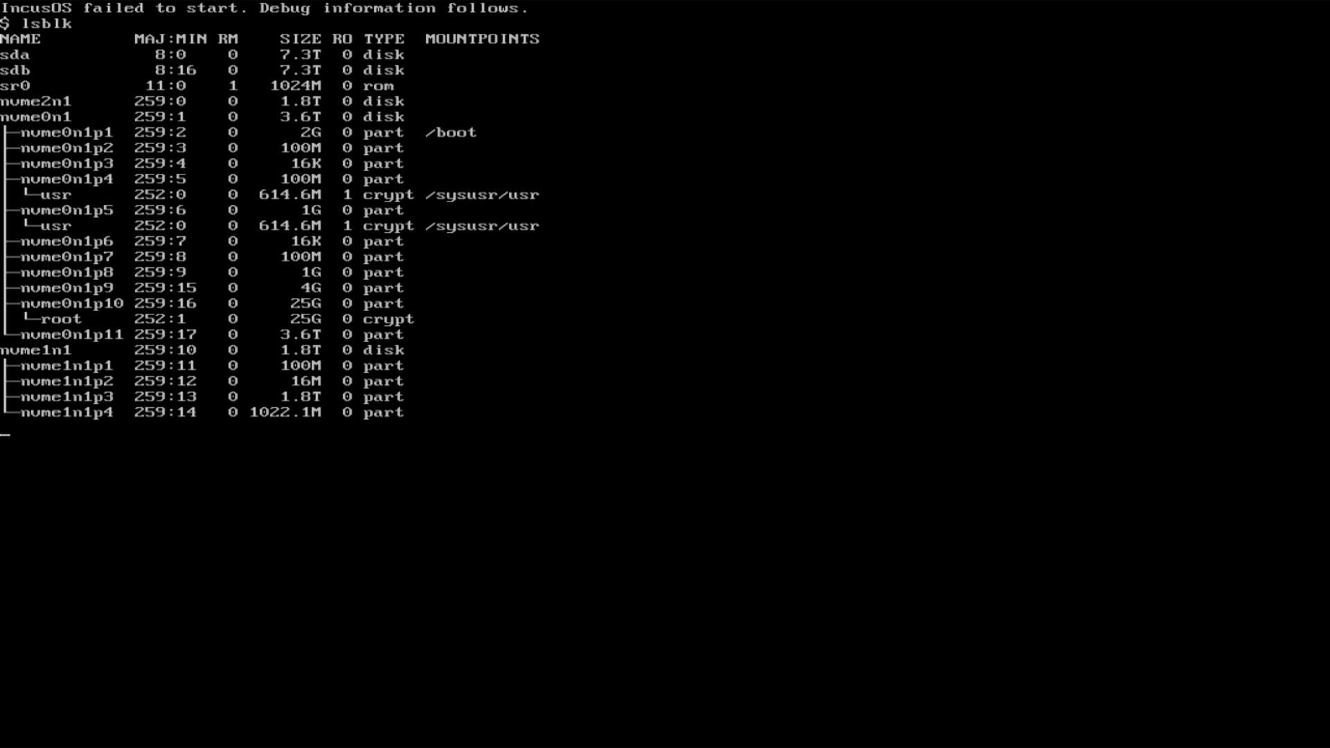

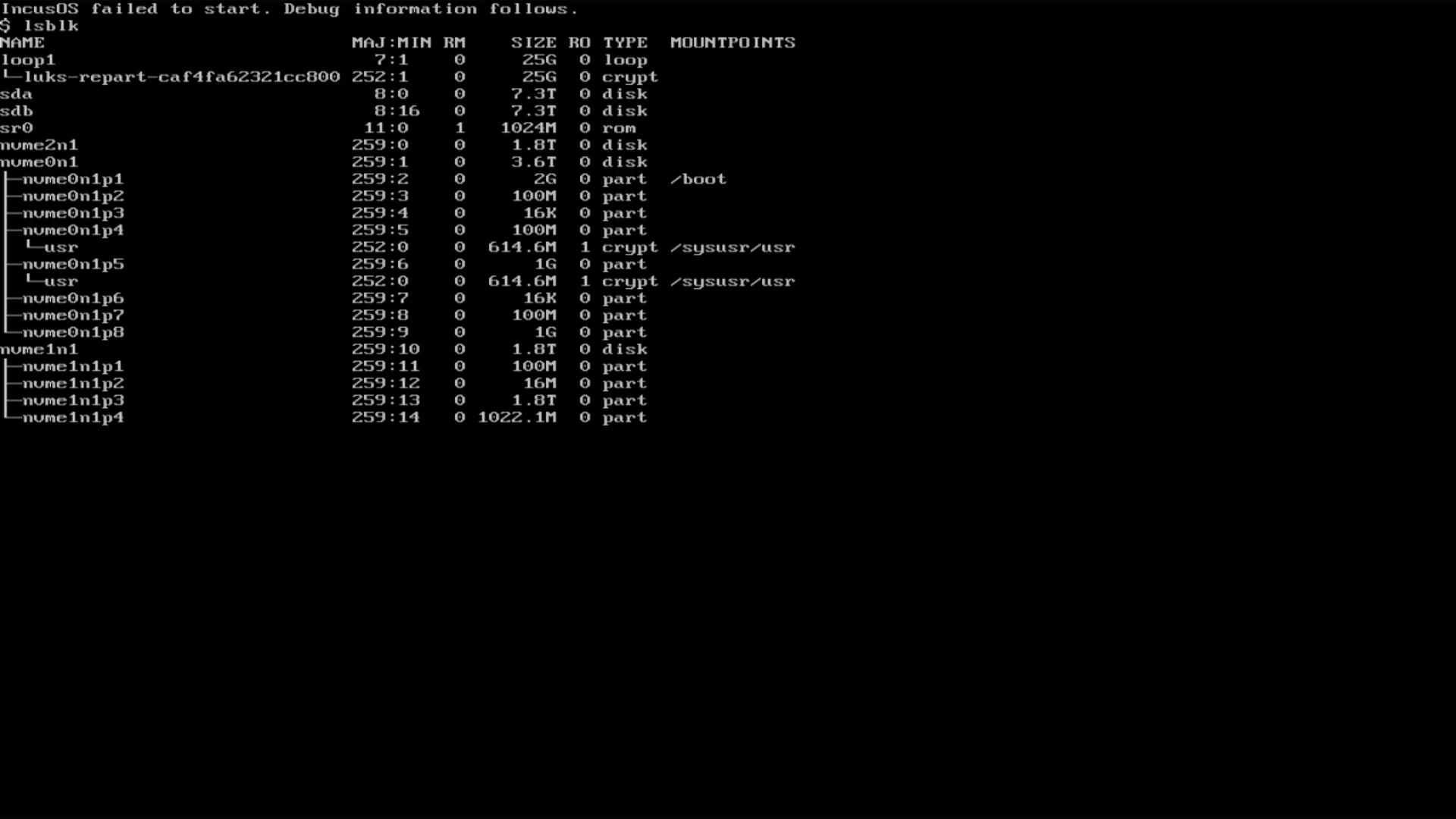

If I install IncusOS on a different NVMe SSD (in the machine at the same time, I wiped the other install), it gets stuck at “IncusOS is starting” for many minutes. Then I was watching the “IncusOS failed to start. Debug information follows.” messages go by… and noticed the boot drive appears in lsblk output with 8 partitions… but I waited longer and it seems like the disk partitioning finished in the background (?) and lsblk switched after a minute be all 11 partitions! It then hangs indefinitely showing debug output.
I rebooted manually, and subsequent boots work fine now.
Here’s the two lsblk messages:

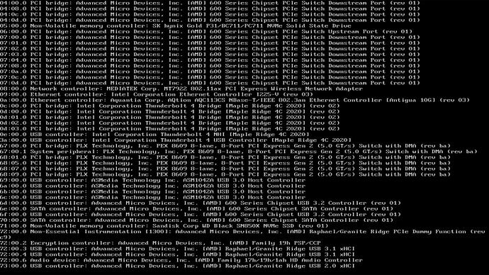

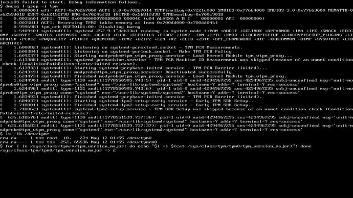

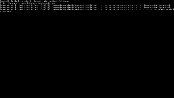

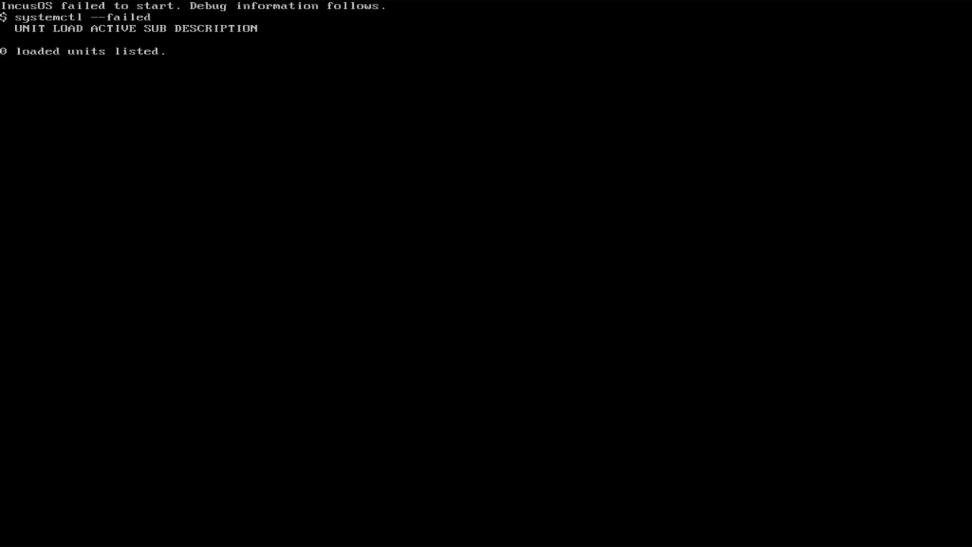

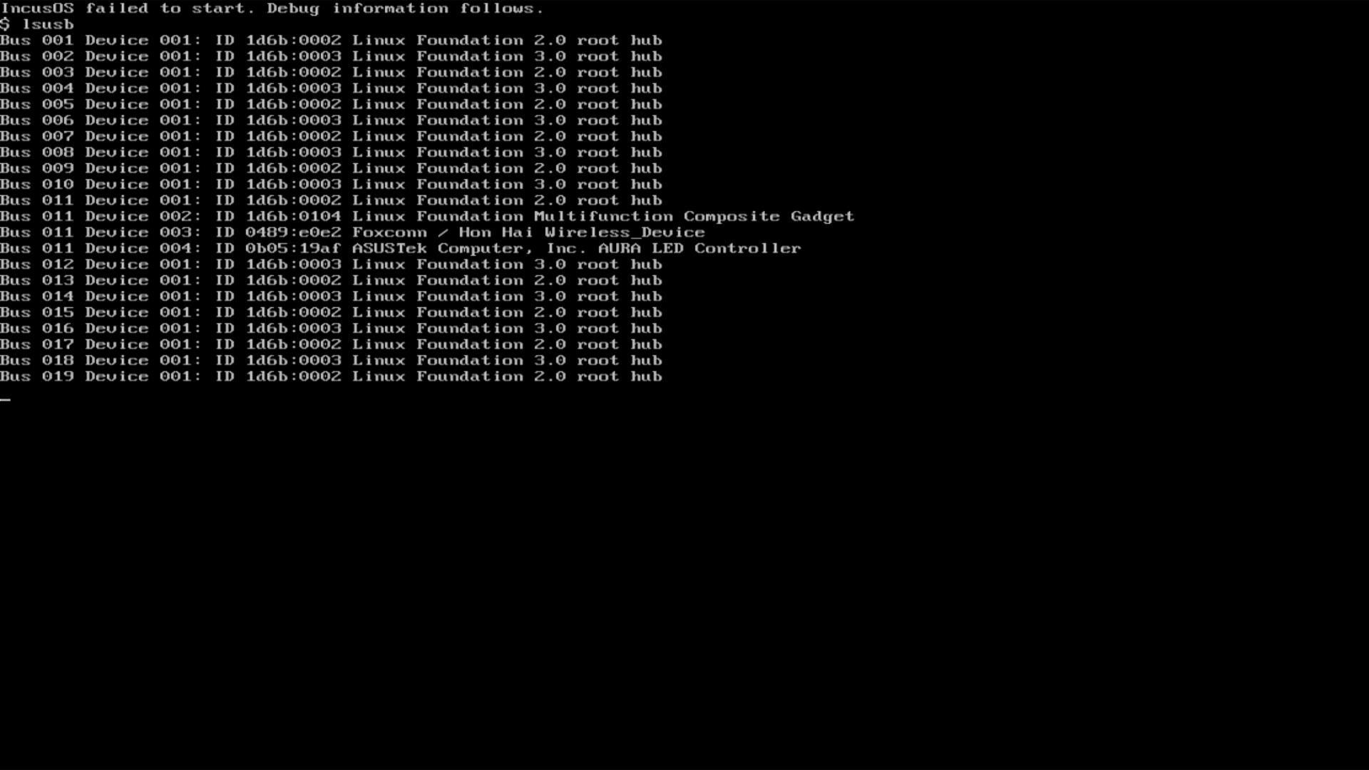

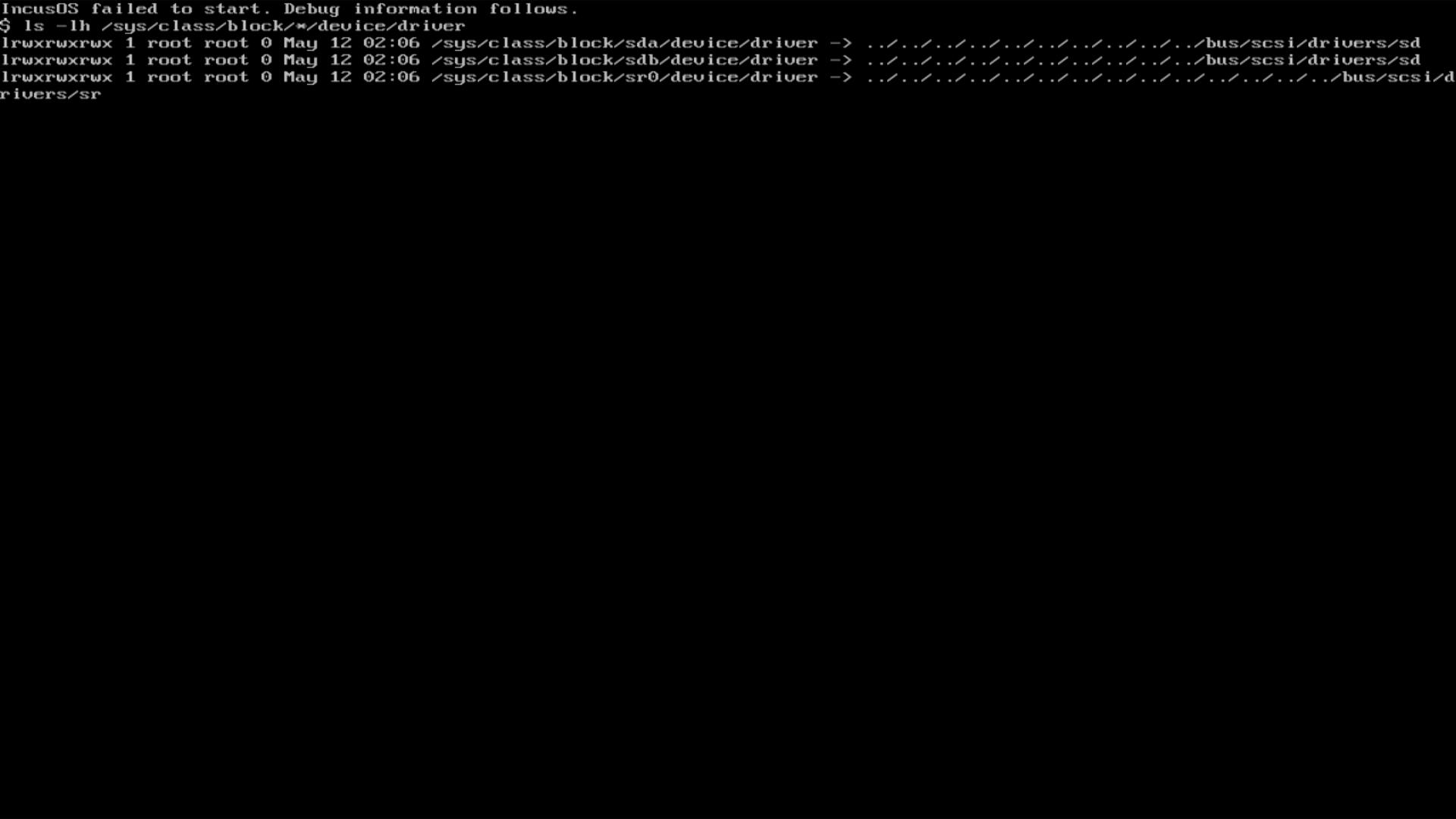

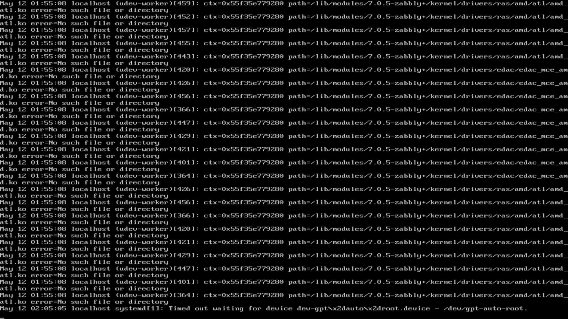

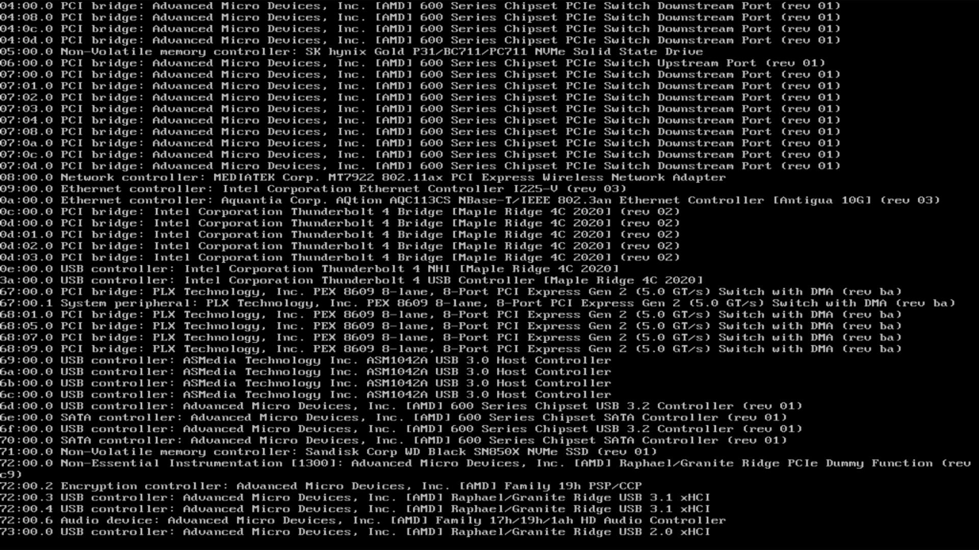

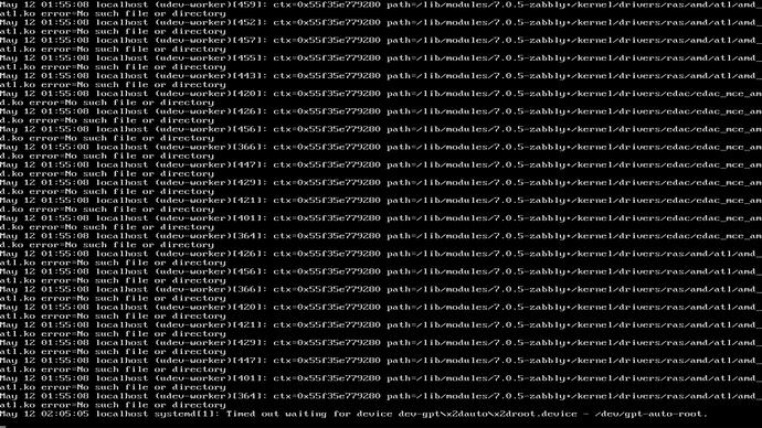

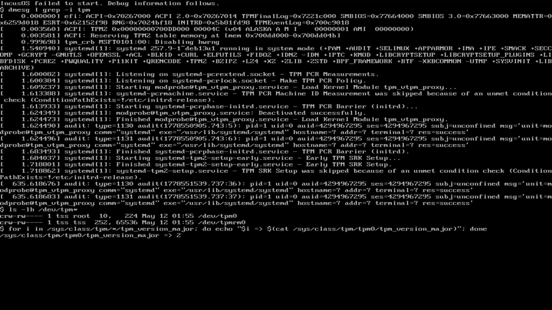

And here’s screenshots of all the other debug info if you need them:
Screenshots: “IncusOS failed to start. Debug information follows.”
No idea why this issue only affects one SSD (CT400T705SSD3), and not the other. I can give full hardware specs if you need them, but the above screenshots have a lot of info.

IncusOS relies on systemd-repart to create the final three partitions on first boot after install. Partitions 9 and 10 are LUKS-encrypted bound to the TPM and the final one fills all remaining space for the local ZFS pool.
Given you eventually saw all 11 expected partitions and rebooting the system then worked, I would be very suspicious of the 4TB disk. The amount of data required to be written when creating the final three partitions is quite small, and even on spinning disks shouldn’t take more than a second or two. How long did the actual install and copying of data take?
I’m not sure if the journal logs would have been properly persisted to disk on that first boot, but if you could try to grab the systemd-repart logs there might be something useful there to help pinpoint what the issue was.

The only other thing I can think of that would slow down the initial partitioning so much is if your fTPM is super slow. But the only time we’ve encountered really slow TPMs has been in a few VMware-specific virtualization cases.
The strange part is that it boots near instantly when I install to the other SSD, so I doubt it’s the fTPM?

I don’t have a 2nd computer to test with easily, but I did remove all other drives, and the issue persists. I almost wonder if it’s like… slow to enumerate? but I’ve never seen that with PCIe before. With all of my additional tests, it actually looked like all 11 partitions were present the first time lsblk appears on screen. I think it may be only one time I’ve seen partitioning be incomplete, and I think it finished partitioning within ~1min by the 2nd time the lsblk info showed on screen.
A guess, but I wonder if the debug info triggers some kind of reenumeration that unblocks systemd-repart? I’ll look around in my BIOS settings for any PCIe settings, maybe it somehow isn’t waiting long enough before booting the OS.

IncusOS sets a 10 minute timeout for devices to become available. That’s way overkill for most systems. :slightly_smiling_face: In your fourth screenshot I do see the final entry being “Timed out waiting for device dev-gpt\x2dauto\x2droot.device …”, which indicates the root partition hadn’t become available. (IncusOS relies on partition labels to automatically discover and mount the appropriate devices.) On first boot, systemd-repart will create and then automatically unlock the root partition, but that didn’t happen for some reason in your case.
The debug info is a simple service and script that activate if the system reaches the emergency.target, such as being unable to mount a root file system. It running shouldn’t affect/change any system state.
