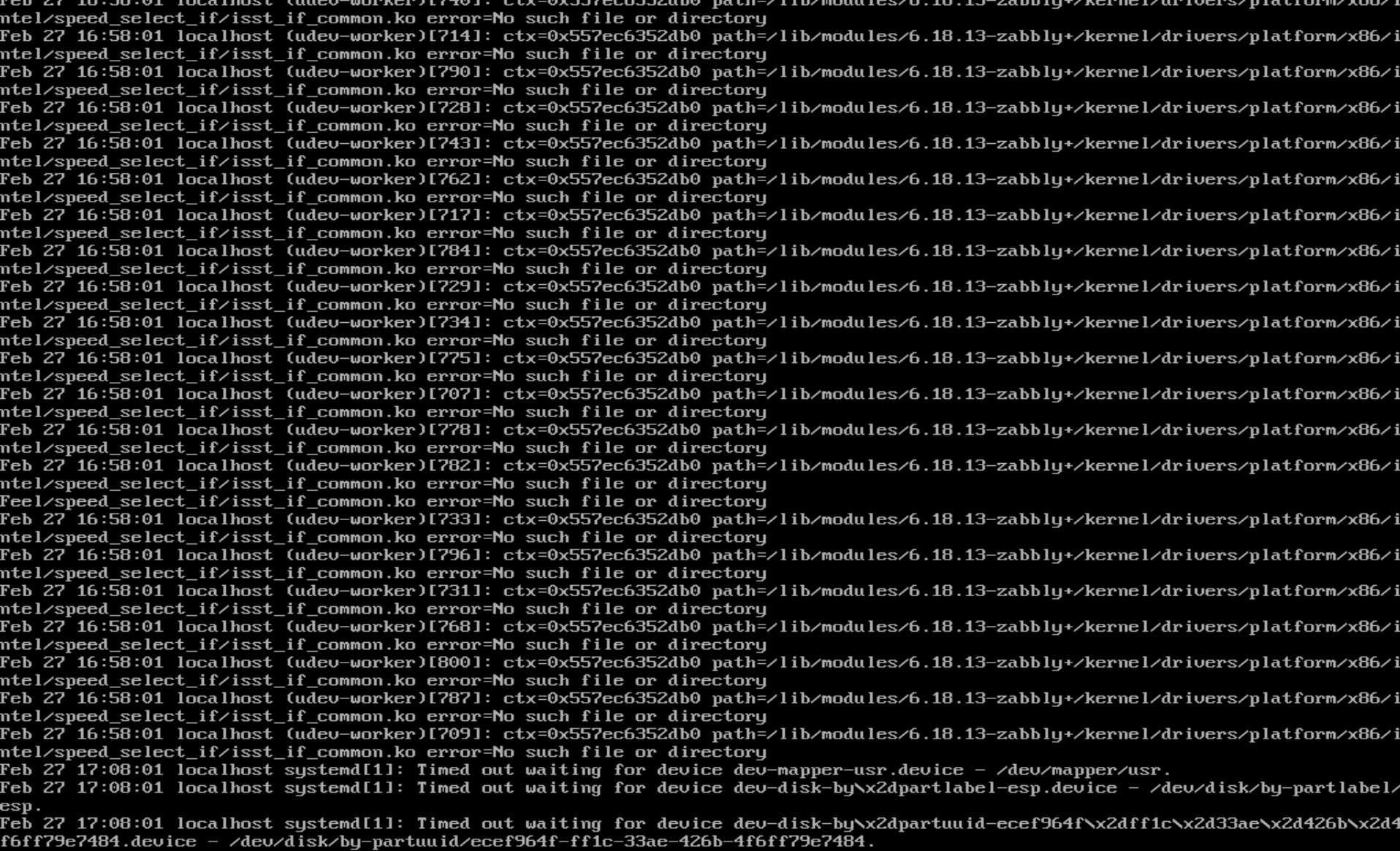

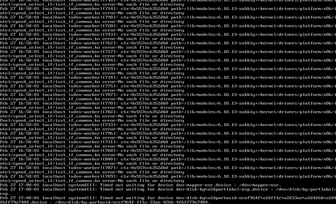

Booting into the OS is hanging for 10-15 minutes and then gives messages like this:
(A bunch of no such file or directory messages)
timed out waiting for device dev-mapper-usr.device -/dev/mapper/usr.
timed out waiting for device dev-disk-by/x2dpartlabel-esp.device - /dev/disk/by-partlabel/esp.
timed out waiting for device dev-disk-by/2 .....................
timed out waiting for edevice dev-gpt/x2dauto/x2droot.device - /dev/gpt-auto-root
Followed by information about devices and my TPM.

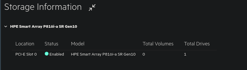

  • The server has smart array which could be causing problems, but I currently only one drive inserted and the port is in “mixed mode” which should mean if it’s not part of an array it should be passed through with HBU. I’ve tried installing to this and to a logical drive in a smart array and neither have made a difference.

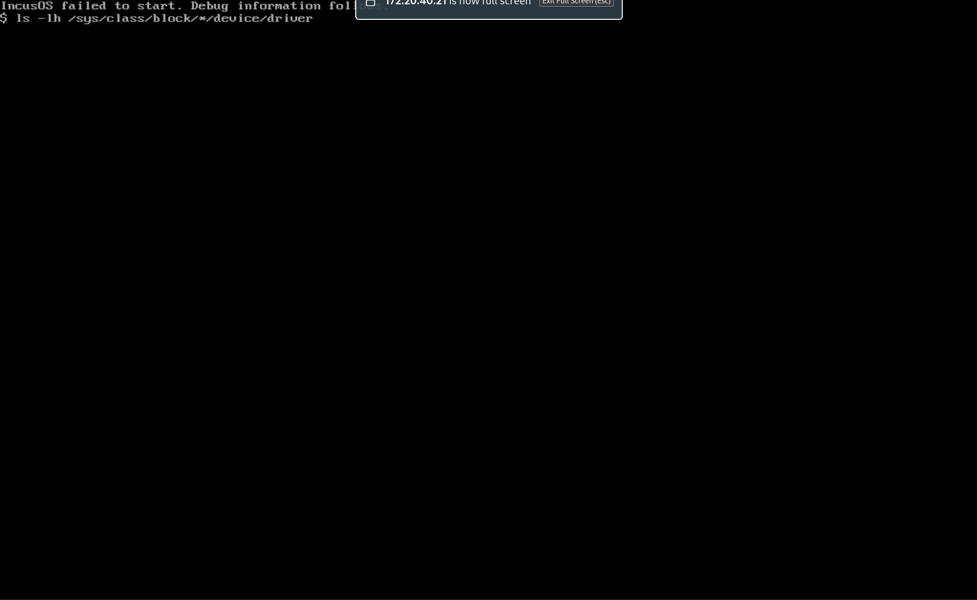

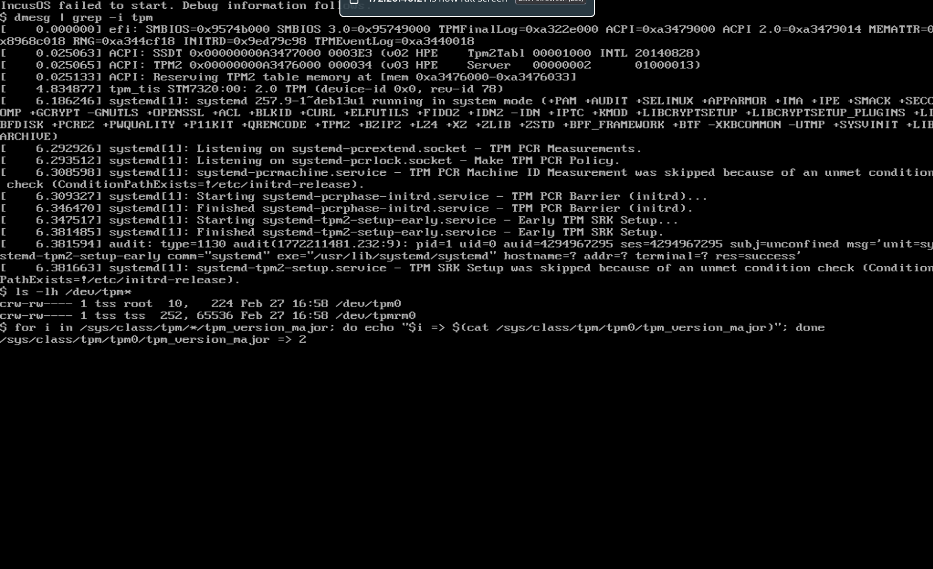

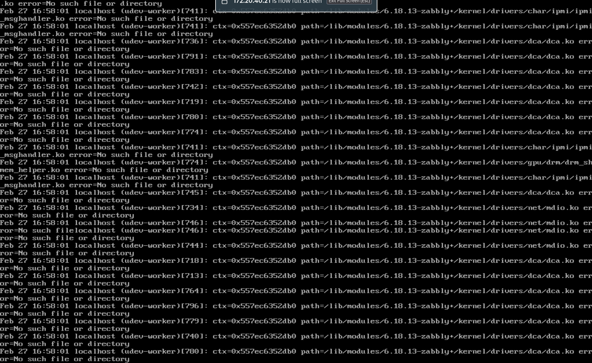

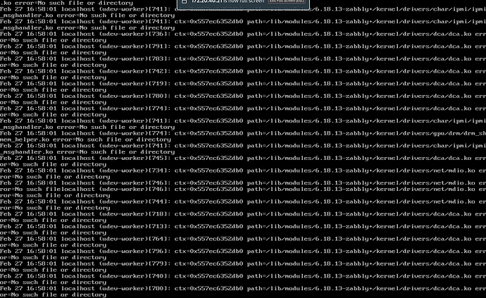

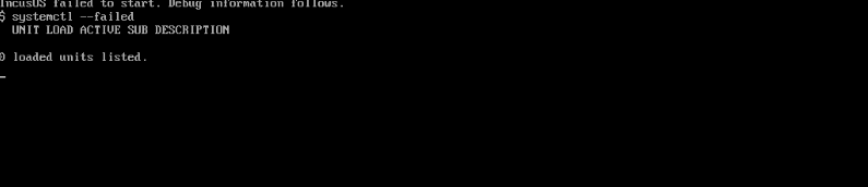

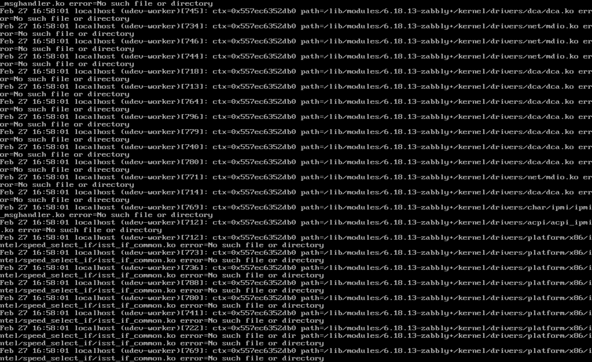

Can you take photos or screenshots of each of the debug screens that are shown after the 10 minutes timeout? There usually is enough information on those for us to figure out what driver may be missing.

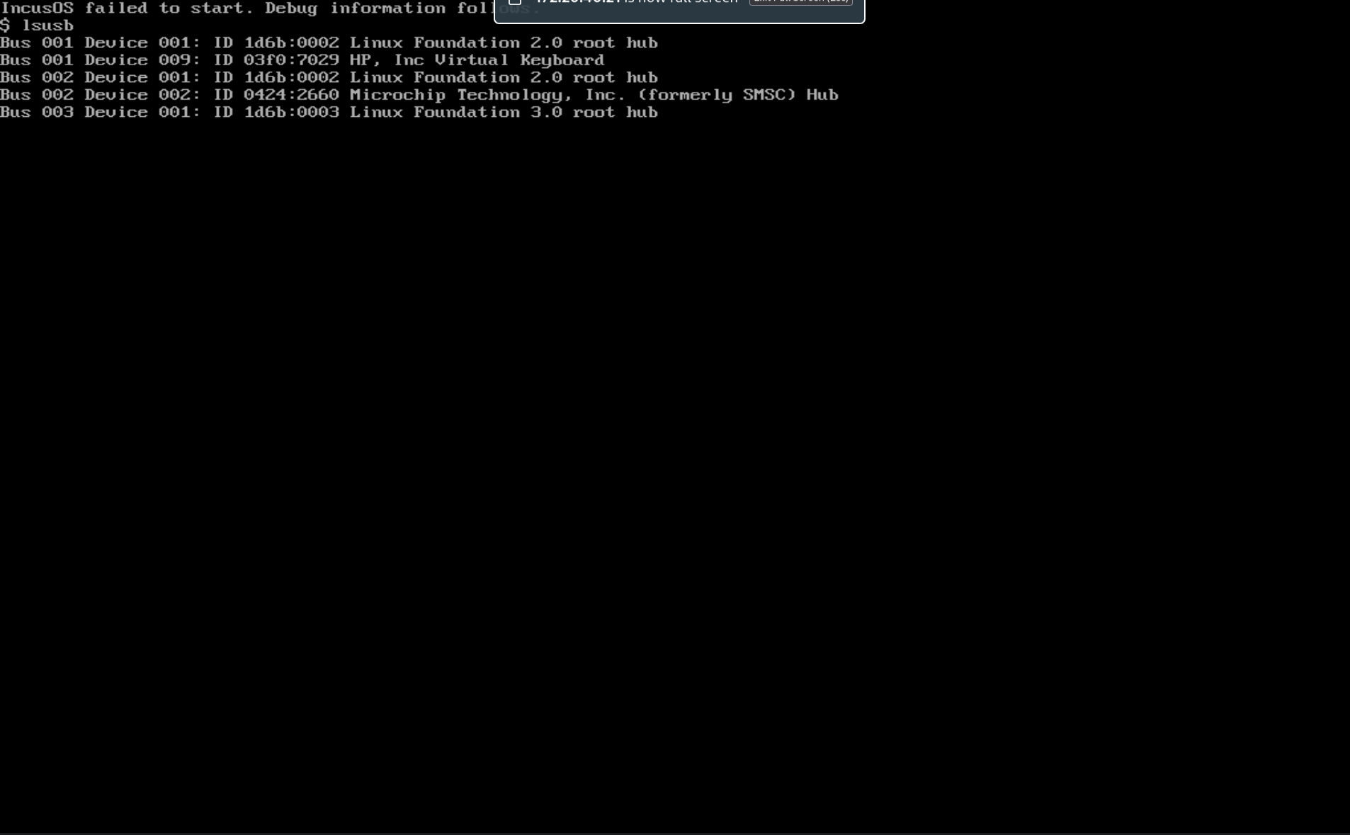

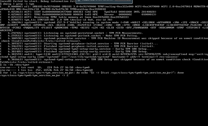

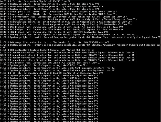

Here are some screenshots of what I’m seeing. Let me know if there’s any other helpful information I can provide.
Image used: IncusOS_202602240349.img
Do you know exactly what storage controller is in that server?
We preload the hpsa driver, but since you’re not seeing any disks, I’m guessing your server needs something different.

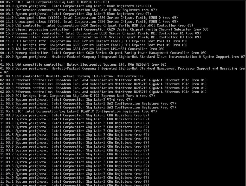

Here are the outputs of some commands I ran, looks like it uses megaraid_sas.
lspci |grep -i raid
12:00.0 RAID bus controller: Broadcom / LSI MegaRAID SAS-3 3324 [Intruder] (rev 01)

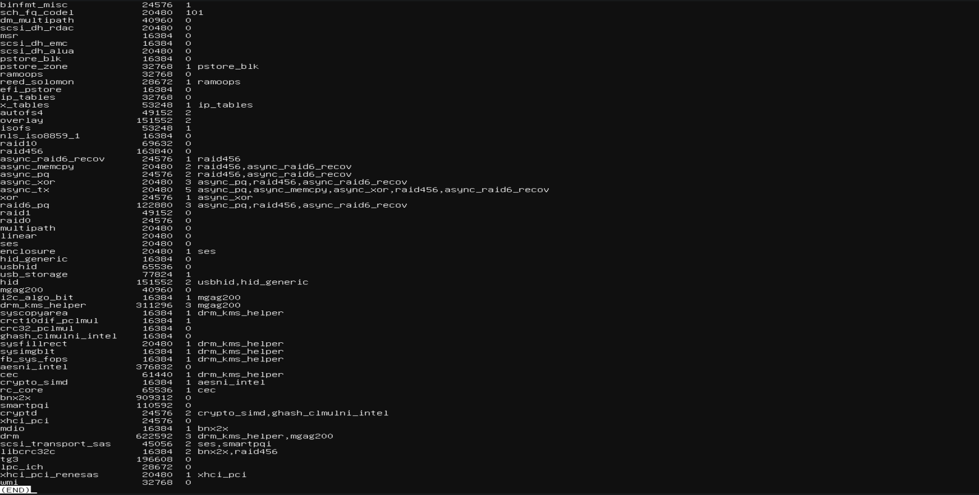

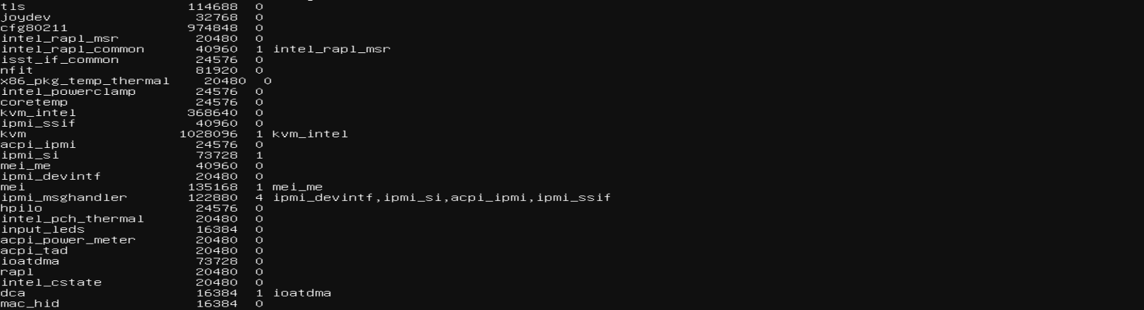

Sorry, I made the incorrect assumption that my DL360 uses the same controller as my DL380. Looking at the 360, here is what I’m seeing with an lsmod:
It seems to be using smartpqi
Ah, great, that makes a lot more sense!
We’re planning another stable image build of IncusOS later today so you should have something to try tomorrow.
