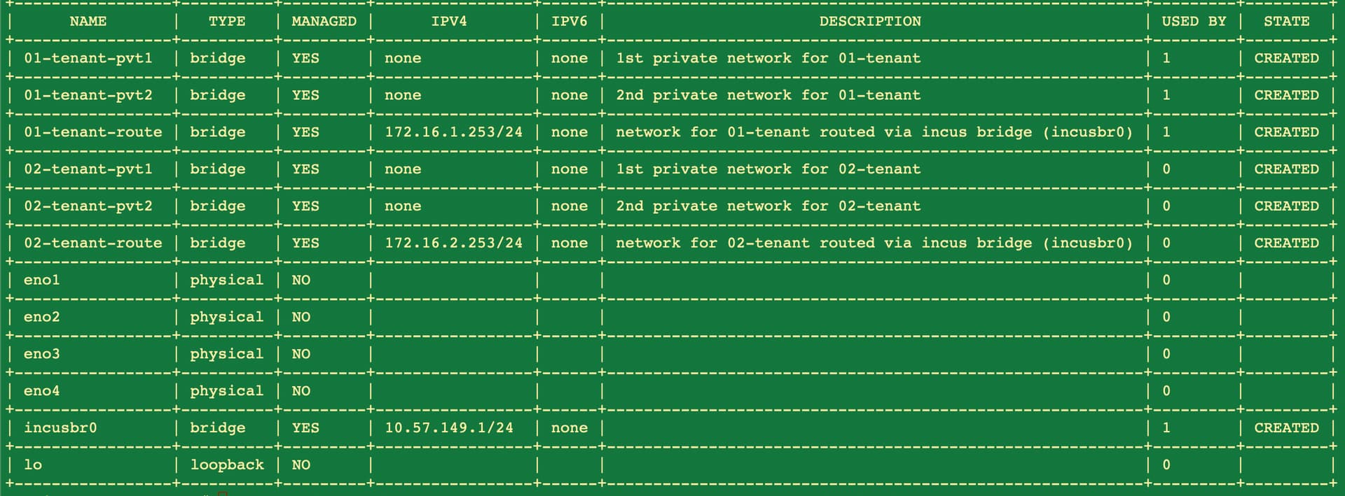

Just to give a backdrop, I was trying to understand how to build a minimal multi-tenant system with 2 tenants (01-tenant and 02-tenant shown below are nothing but 2 different projects). If I go this way then I need to keep track of the subnets assigned to each tenant. It was not only getting complicated when I grow tenants but what I noticed is that even if I run a container in one. tenent, it can actually ping the network which I was hoping to keep it exclusive for the second tenant. Since all the networks are exposed to all the tenants, there is no true isolation from the networking aspect. I then realized I was on the wrong path.
