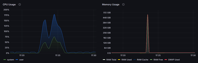

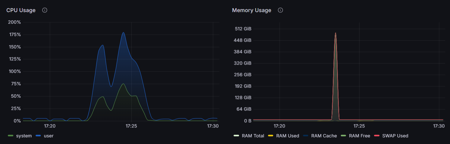

The monitoring graph for the instance on grafana clearly shows overcommitment:
  • CPU Usage: Spikes up to around 200% (with user and system components), despite the limit of 4 CPUs. There are multiple peaks between 17:20 and 17:30.
  • Memory Usage: RAM/SWAP Used starts high (around 500 GiB) and drops sharply to near 0 by 17:30, with RAM Total at 512 GiB. This seems odd since the limit is only 8 GiB—could this be showing host-level stats instead of container-specific? RAM Cache, Free, and Swap Used are also tracked, with Swap Used minimal.
From what I’ve read in the docs, limits.memory should cap the container at 8 GiB, and limits.cpu=4 should restrict it to 4 cores. However, the usage appears to exceed these, possibly due to soft limits or caching/swap behavior.

CPU usage is correct. 4 CPUs means it should not go above 400%.

Am I setting the RAM and CPU limits correctly via profile?
What about the RAM in Shared picture?
I wouldn’t base my understanding of the situation on one picture. You should test your setup and measuring software. Run stress tests on your containers and measure through different means and check if they all match and if they respect your limits. If they don’t, post back here about it.

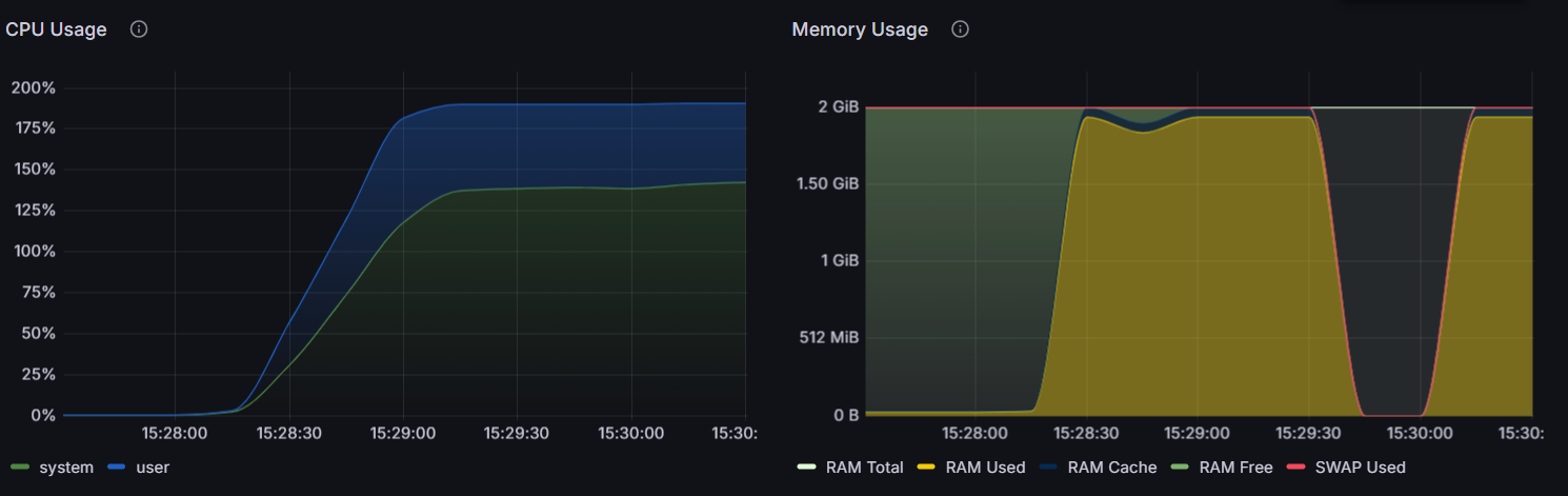

Thanks, Victor. I’ve already performed stress testing using stress-ng inside the test container, but it seems that the CPU limit isn’t being enforced.

Here’s what I observed:
  • The container was configured with limits.cpu=2.
  • During the stress test, both the container and host load averages increased simultaneously, which indicates that the container is consuming CPU beyond its defined limit.
  • The RAM usage is not increasing, since the CPU limit isn’t being enforced — meaning the container isn’t being throttled and system resources are freely used.
  • Ideally, a container’s CPU usage should not impact the host’s overall CPU load beyond its assigned limit if cgroup CPU constraints are properly enforced.

My Grafana Graph During Stress Testing:

From my point of view, your CPU and RAM resources are enforced from the grafana graphs. Why would you say they are not enforced when grafana is clearly showing exactly that?
Contrary to your previous grafana image, this is not just a spike, which could be some measurement error.
Thanks, Victor. My main concern is that I want to restrict my container like a VM — meaning the container’s internal load average shouldn’t impact the host’s load.
Right now, when I run a stress test inside a single container, both the container and the host show the same spike in load average, even though I’ve applied CPU limits. I’d like the container to be fully isolated so that its load doesn’t appear on the host — similar to how a virtual machine behaves.
Is there any way to achieve that kind of isolation with Incus, or is this simply a limitation of how Linux containers share the host kernel and scheduler?
