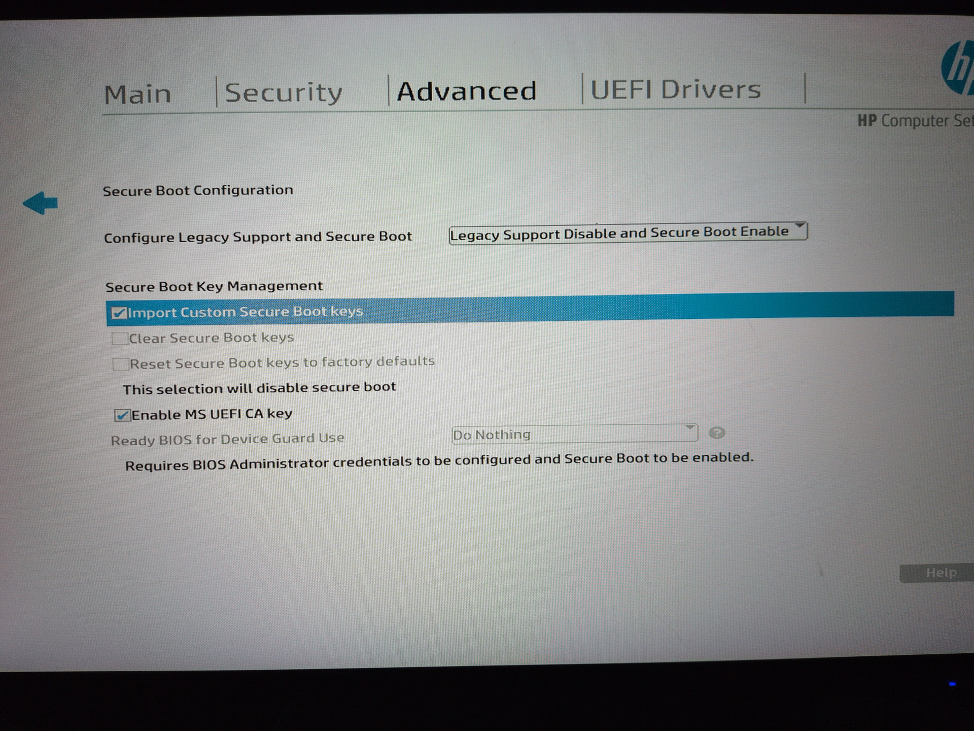

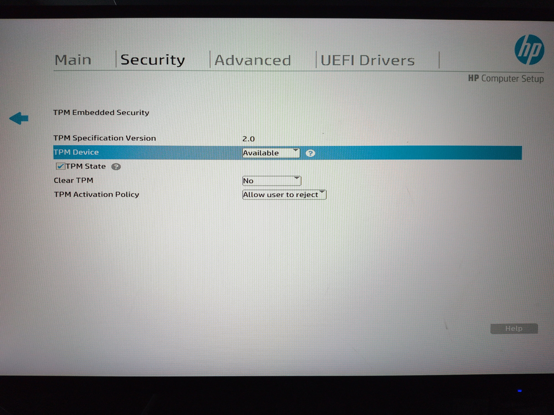

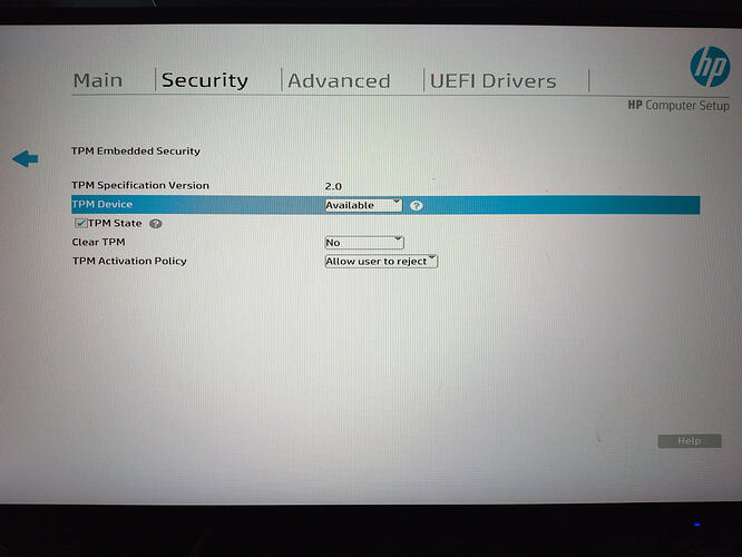

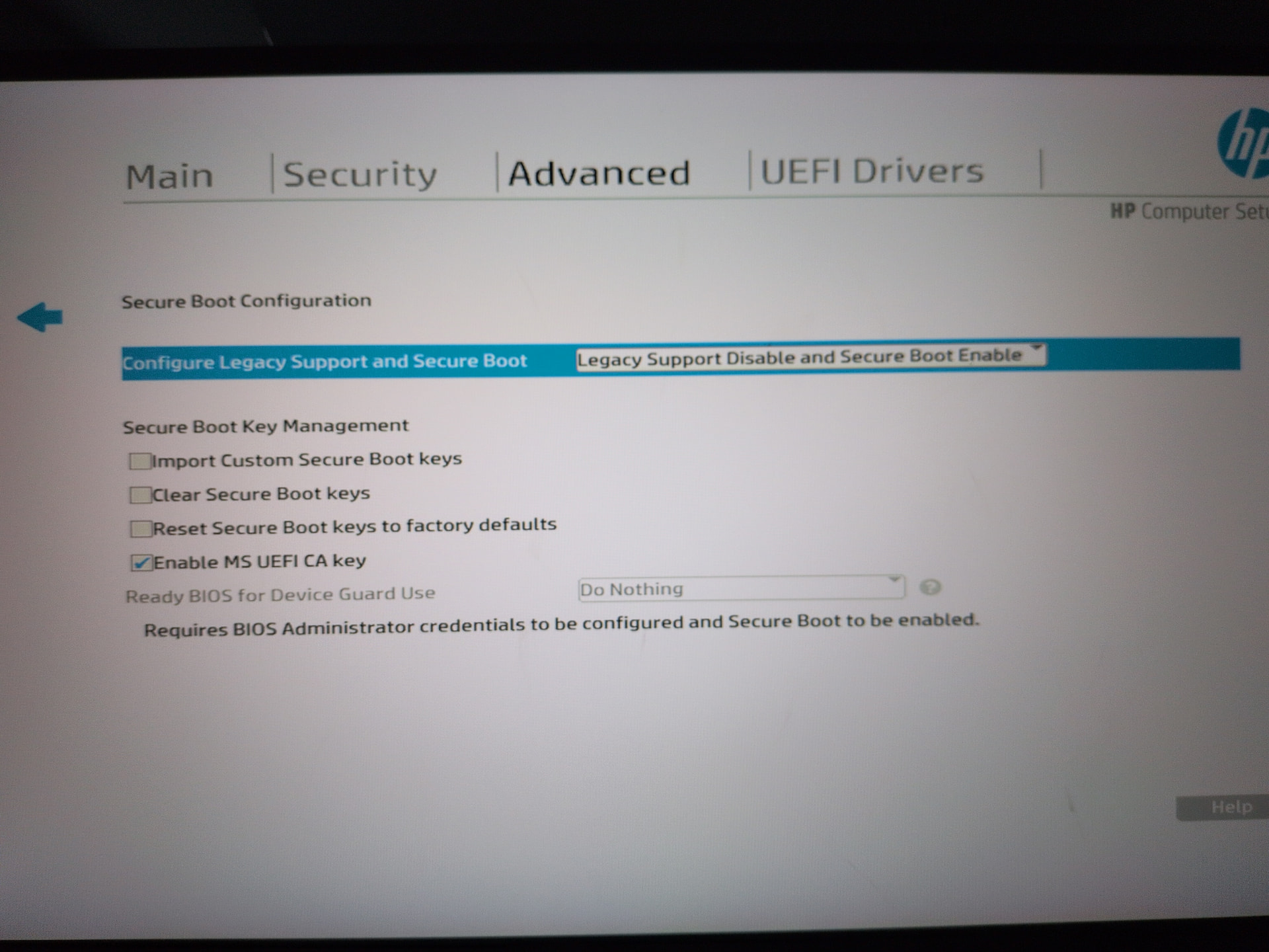

Following the hardware installation instructions, I have downloaded the IncusOS USB image, and set the recommended BIOS settings. See images.

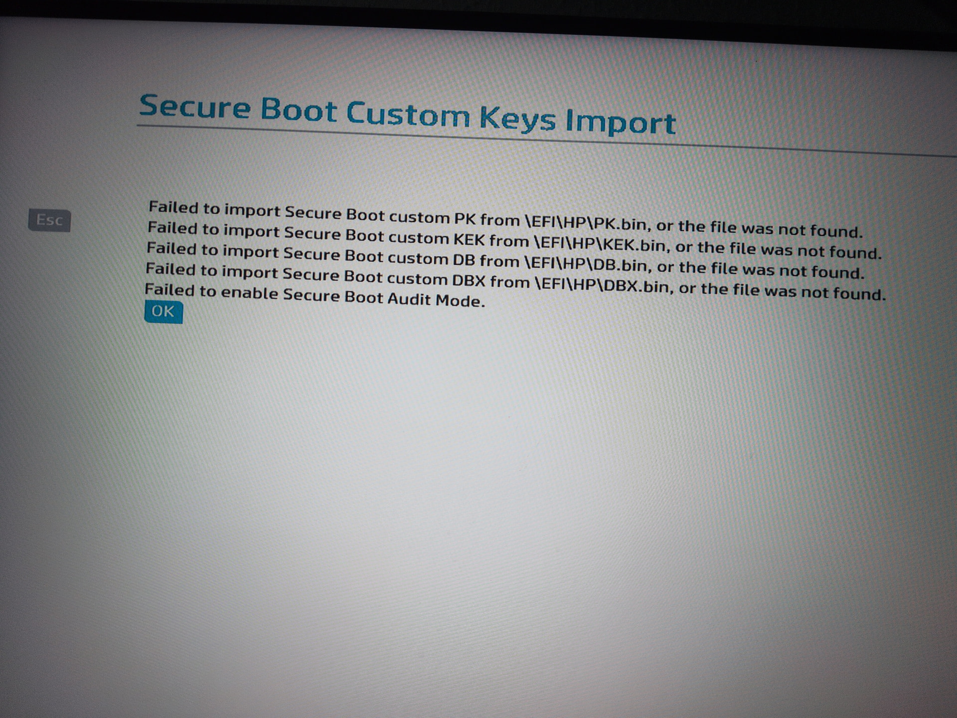

I then checked the manual, page 28, Section 4.5 Secure Boot Configuration Menu.
The manual states
[…] custom secure boot keys are imported from the EFI\HP directory […]
The custom keys consist of PK, KEK, DB, and DBx .bin files.
When import succeds or fails, a preboot prompt shows the results of each key bin file.
Following the manuals advice, I moved the keys/ directory into <efi-partition>/HP as well as <efi-partition>/EFI/HP.
I was not shown this preboot prompt in either of these three cases.
The keys/ folder only contains .der files of KEK, PK, and DB. Looking around online I did not find the source of these files, or their .bin equivalents.

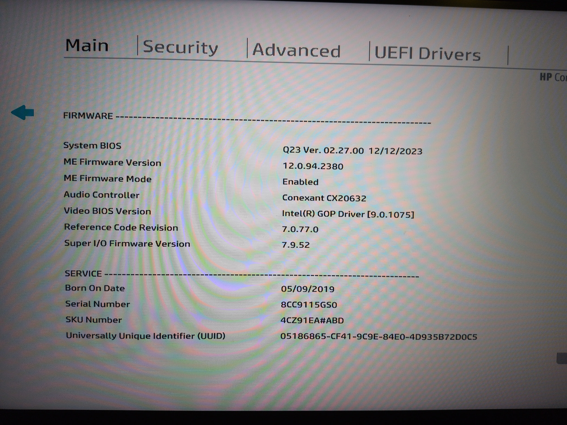

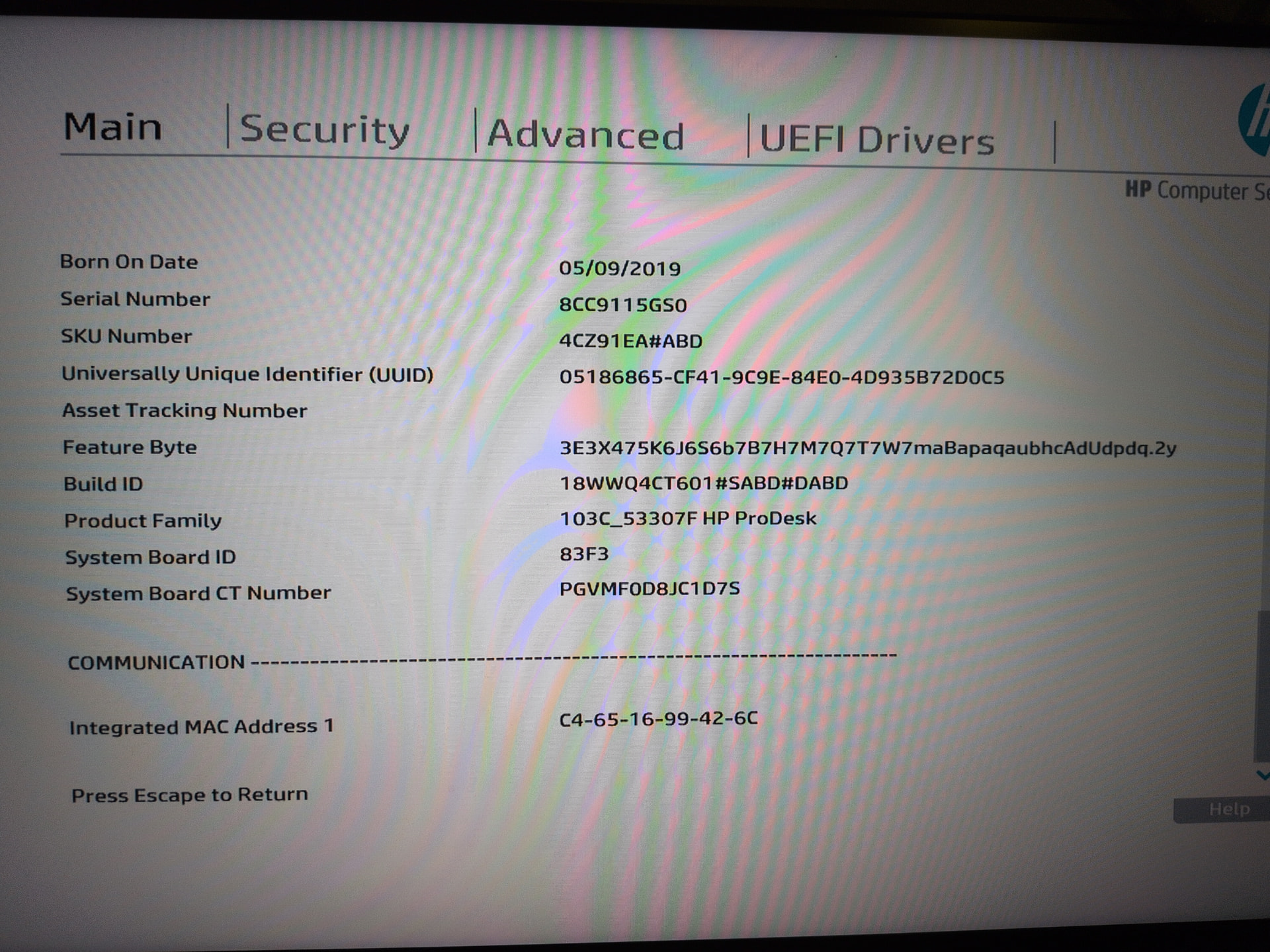

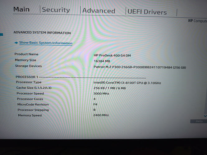

I’m following the same installation path and the missing Secure Boot prompt makes this look like a firmware-specific issue rather than a simple IncusOS setting. The exact BIOS version and whether the machine is using legacy or UEFI-only boot would be useful details when comparing this model with known working installs.

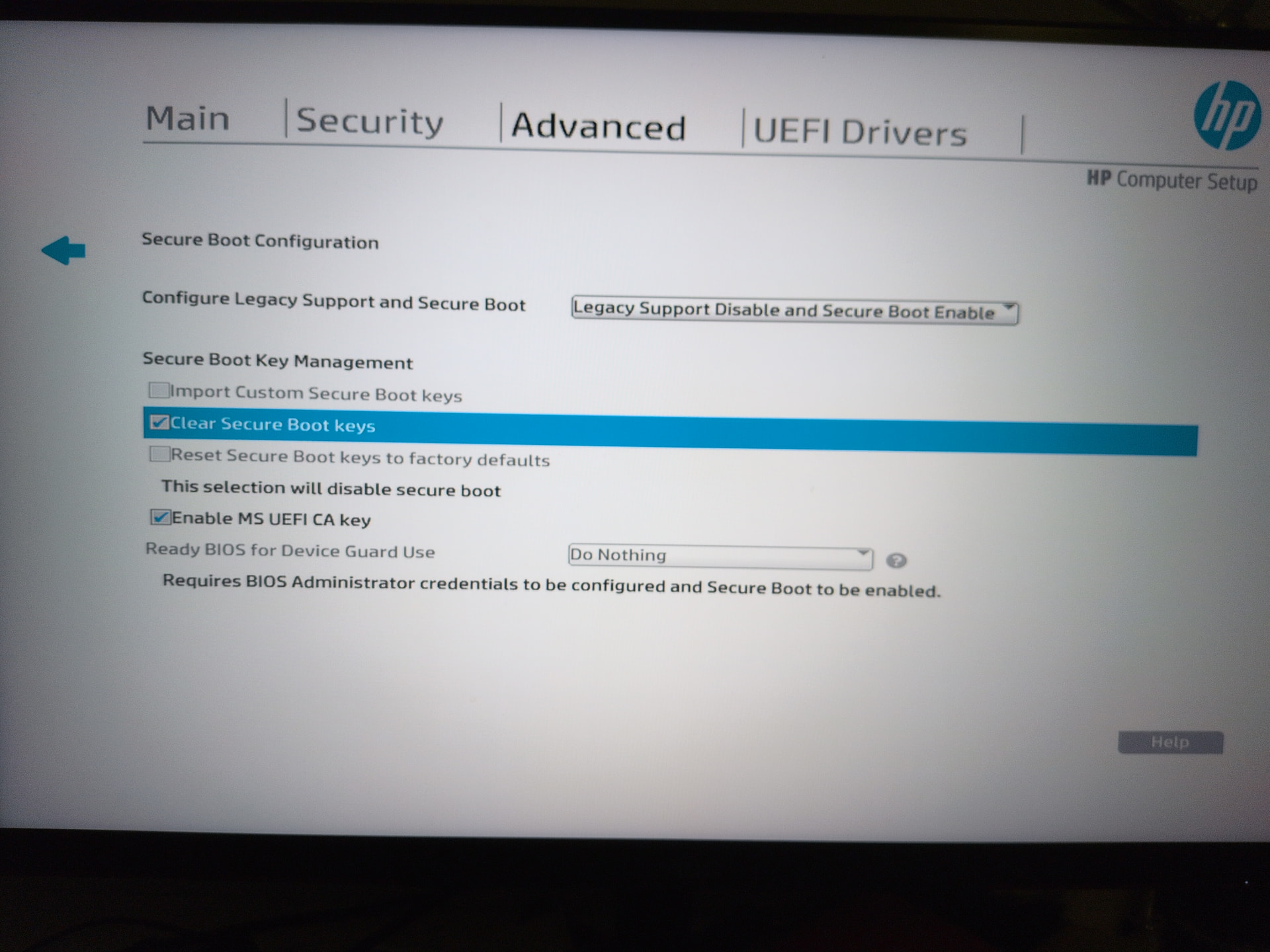

Might be worth trying the Clear SecureBoot keys option. That may be a way to get Secure Boot into Setup mode, which would then provision the keys when you boot from the install media.

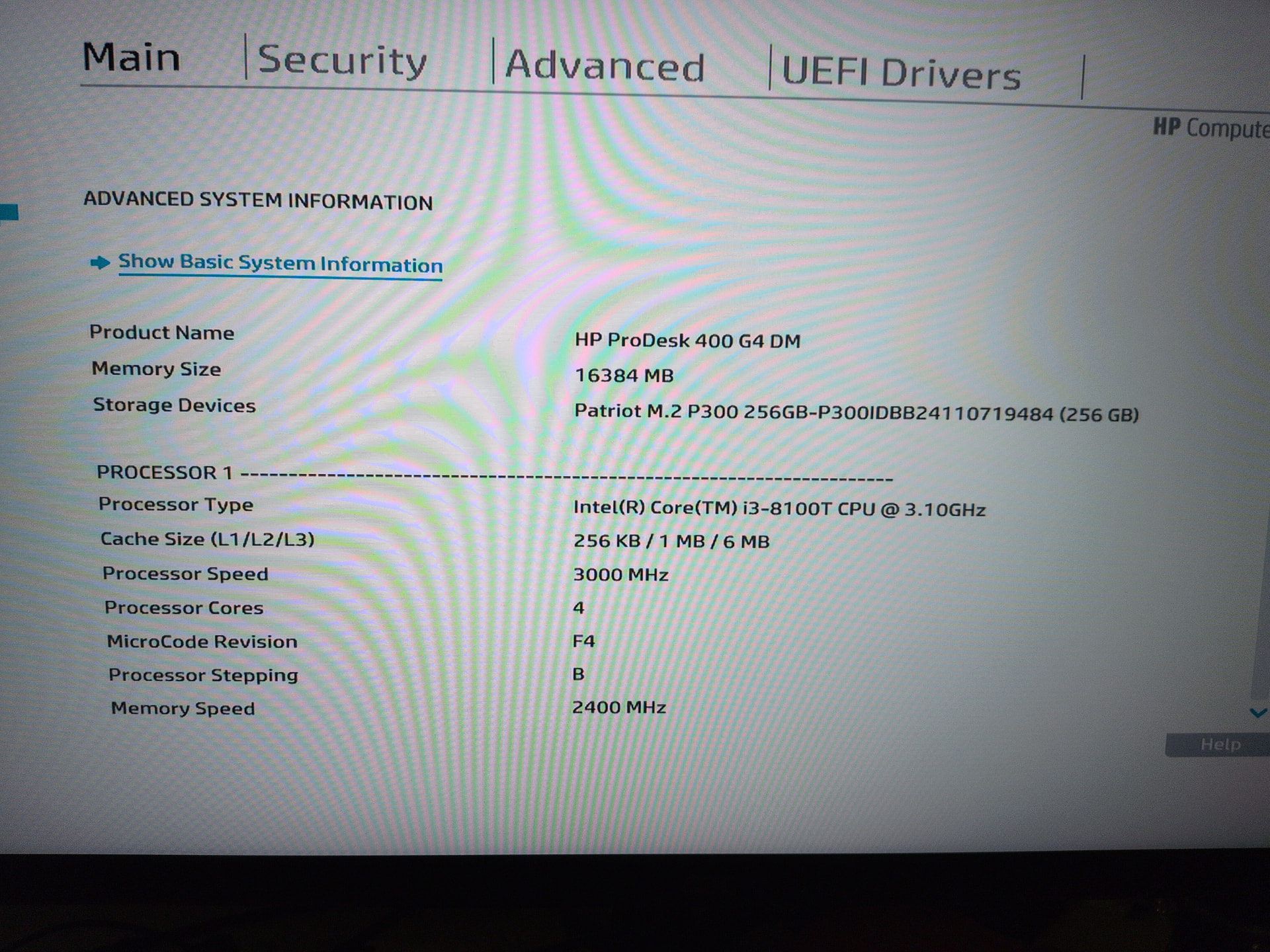

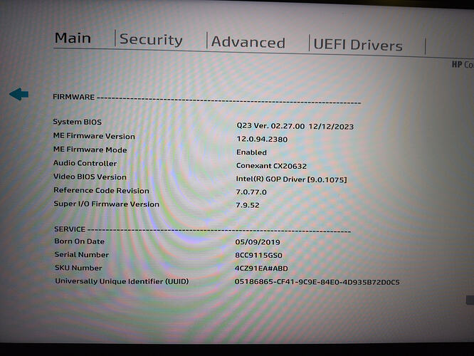

As requested, firmware information:
After Clear SecureBoot keys:

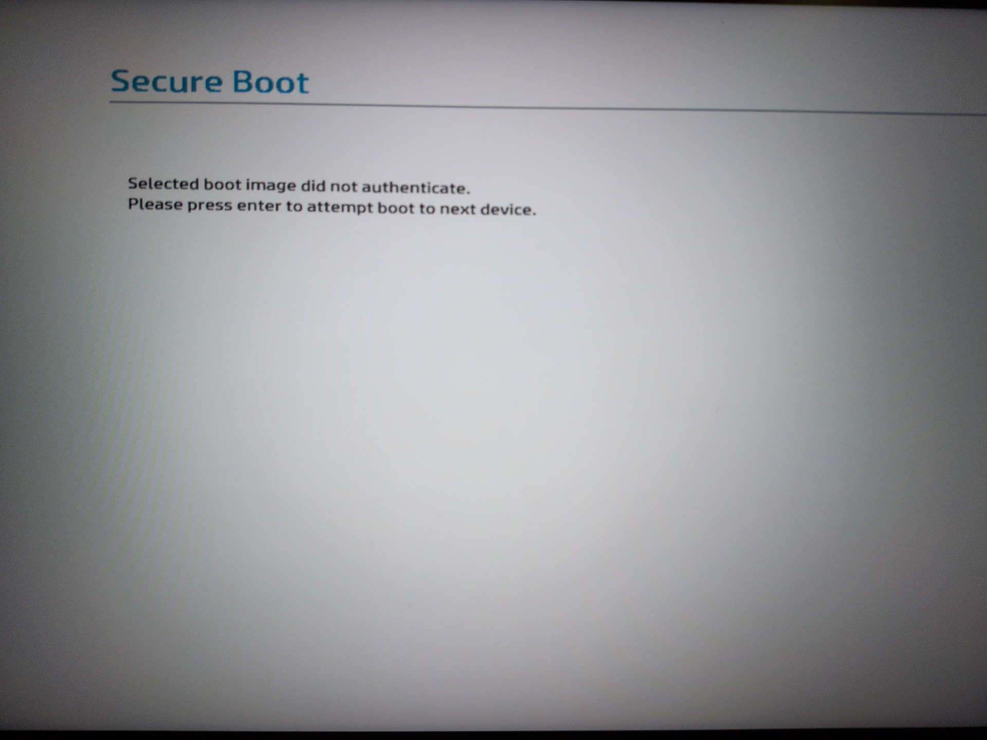

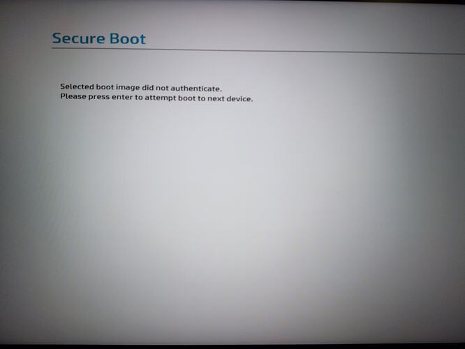

Attempting to boot the Incus image, with Import Custom Secure Boot keys set results in `boot image did not authenticate:
In an attempt to follow the HP manual, I moved the .ders from the keys/ into a HP folder, and renamed them into .bins.
This seems to have been more successful, at least the “You are importing a custom secure boot key” screen appeared.
Booting the modified image did not work.
Booting the original image also did not work.
Both got the Selected boot image did not authenticate message.

Seems like the way to go is setup mode, but setup mode is weird on this one and needs:
  1. F10 setup → Security (or Advanced on some layouts) → Secure Boot Configuration.
  2. Disable Secure Boot, and make sure “Import Custom Secure Boot keys” is unchecked. Save & exit, and confirm the 4-digit code prompt at reboot.
  3. Re-enter F10, check “Clear Secure Boot keys”, save & exit, confirm the code prompt again.
  4. Boot the IncusOS USB. The firmware is now in Setup Mode, so systemd-boot on the media shows the key-enrollment countdown and enrolls PK/KEK/DB itself.
  5. Re-enter F10 and re-enable Secure Boot (“Legacy Support Disable and Secure Boot Enable”), confirming the code prompt once more.

  1. “Clear Secure Boot keys” , Reboot
  2. “Legacy Support Disable and Secure Boot Disable”, Reboot
  3. “Import Custom Secure Boot keys”, Reboot
produced the Import Success/Fail screen described in the manual:
I will try the modified image with a HP folder containing {PK,KEK,DB}.bin, with the original keys folder intact.
EDIT:
Moving the keys into a HP folder did not work. Result as above.
3. Boot into IncusOS
This set steps is necessary because “Clear Secure Boot keys” implicitly sets Secure Boot to Enabled
