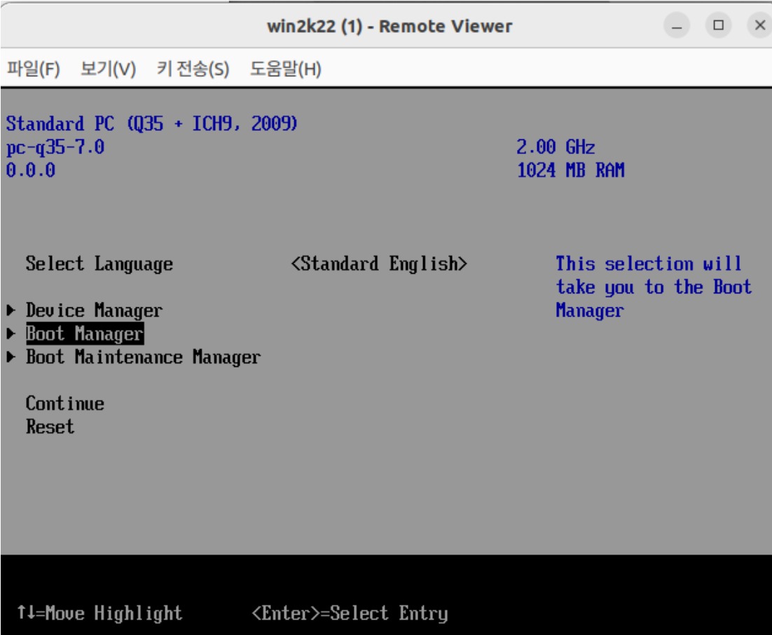

The vm’s bios looks like the screen below.
Where do I set the time? Can’t seem to find it.
I have set the time in the BIOS of the laptop, but it is still not correct.
You can’t. Firmwares never really did timezones and virtual machines never did clocks.
