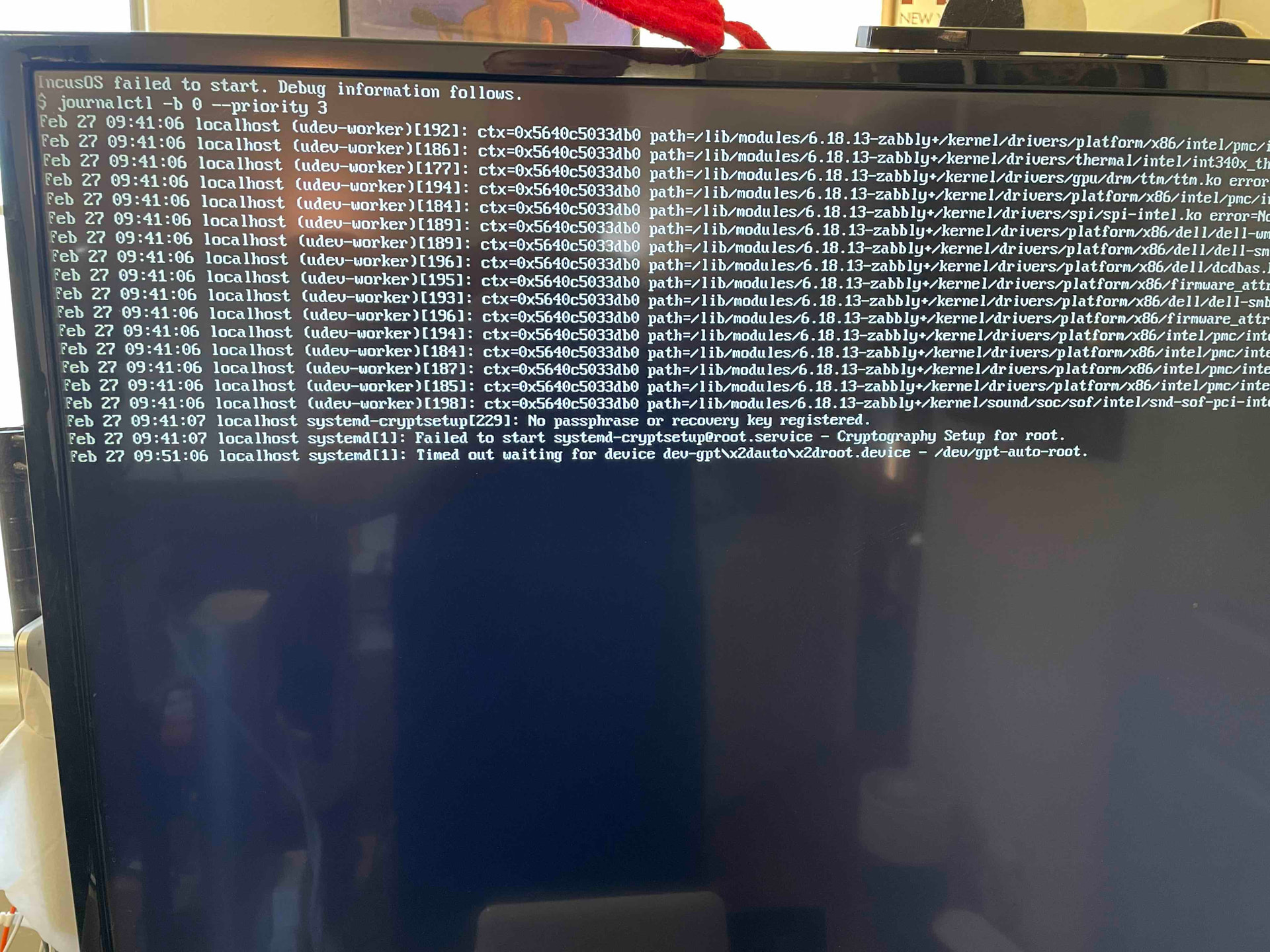

I’ve got two of these units happy installed with IncusOS but another two units fail install with:
systemd-cryptsetup[238]: Failed to unseal secret using TPM2: state not recoverable
and
times out waiting for dev-gpt\x2droot.device - //dev/gpt-auto-root
I’ve tried resetting the TPM on these systems, upgrading BIOS, resetting everything to defaults without luck. I can pxe install Alpine on them without issue when secure boot is disabled but I can’t seem to get an incusOS install on them.

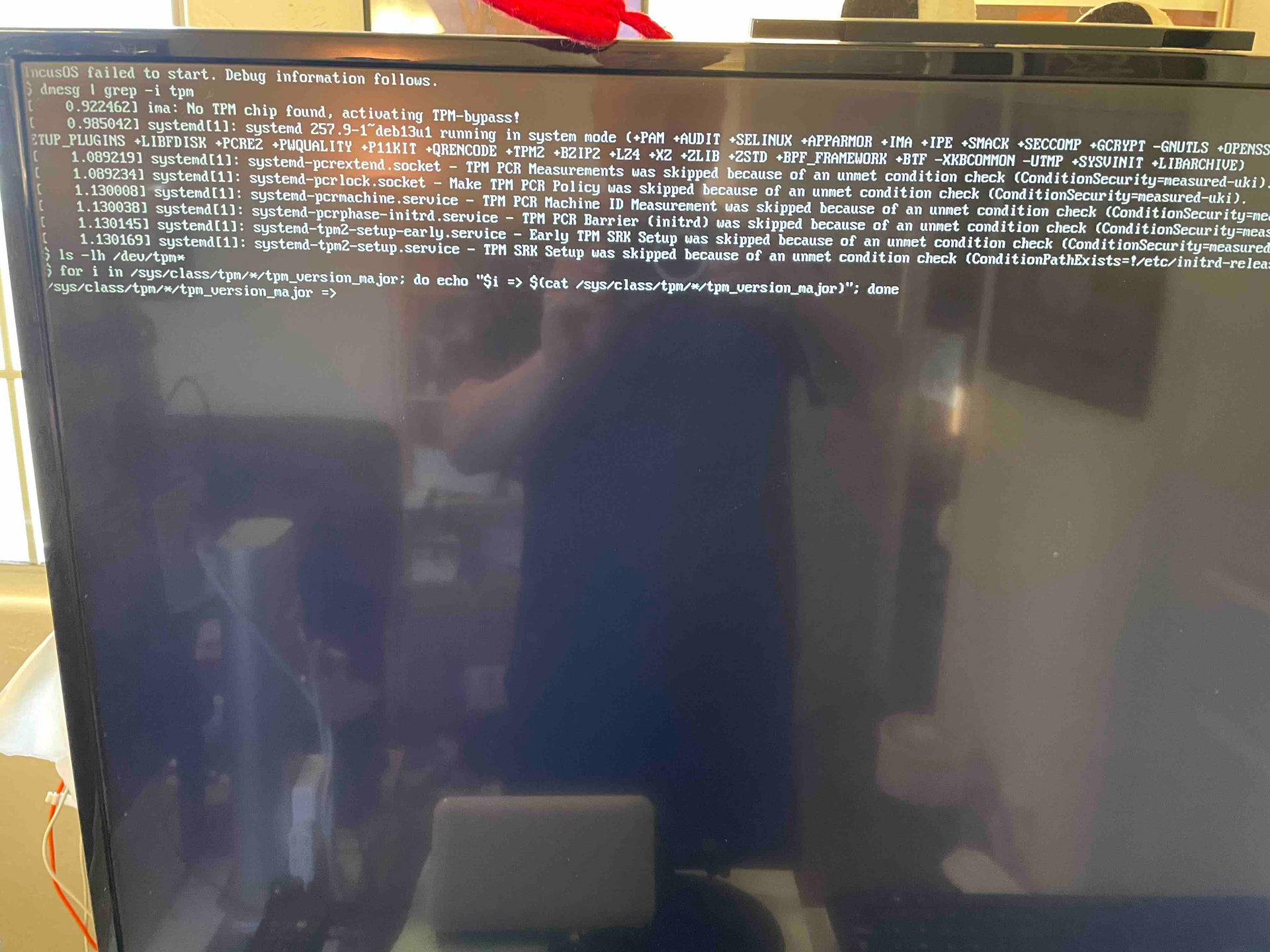

Look at the advanced section when downloading an image, you can get an image with a software TPM for systems without a TPM 2.0 module. In your case, you’ll need to turn off the hardware TPM in the BIOS.
Thanks!

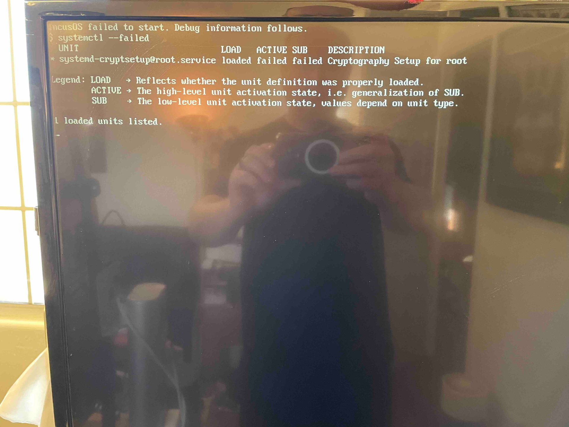

I grabbed my TLS off my cluster and generated a USB key. I forgot to disable the TPM hardware and it booted up to the curses screen and told me it was detected and couldn’t continue. I disabled the TPM in BIOS and tried again and at the ‘booting incus’ banner, it mentioned that it was falling back and hung there for a while and then dumped debug that it had failed with systemd-cryptsetup
Really strange….. I made a new USB key with a download from a couple weeks ago and it works. I suspect that the file I used for the stick had was asserting nvme. Not sure but either way, my difficult systems are almost up now.
