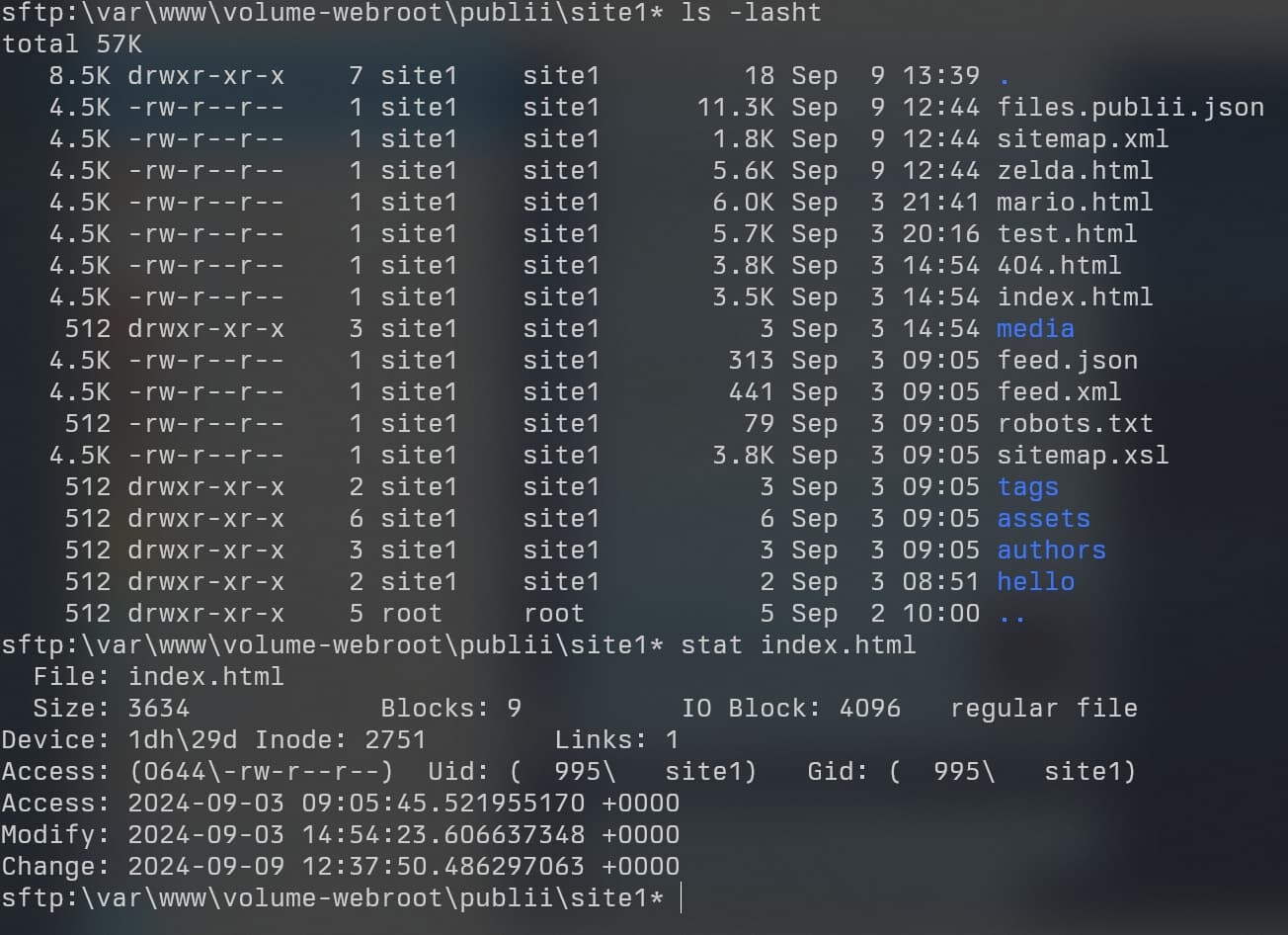

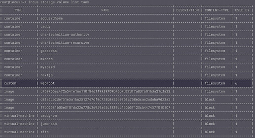

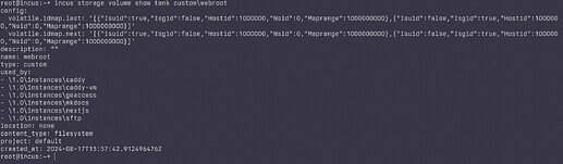

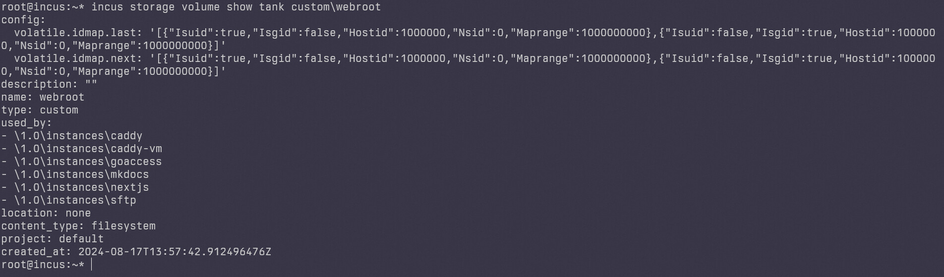

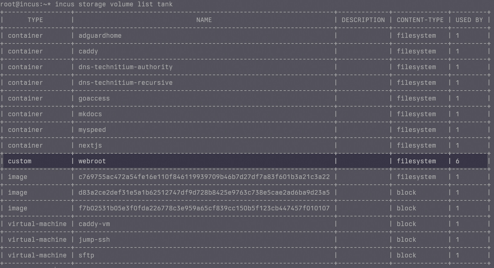

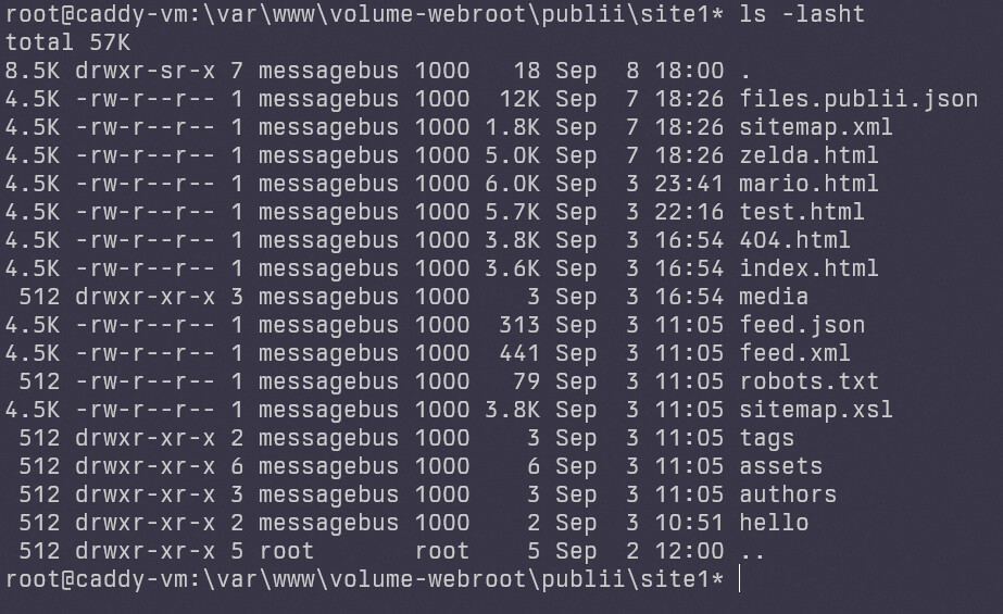

I’m using a volume that is shared between my SFTP VM and a Caddy VM.

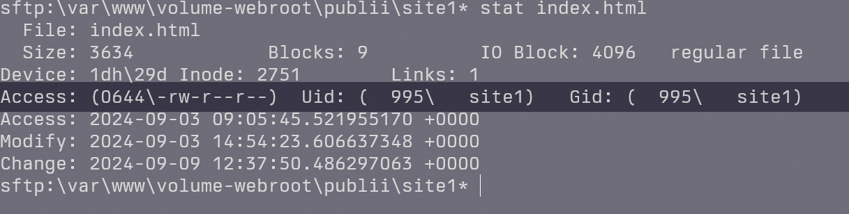

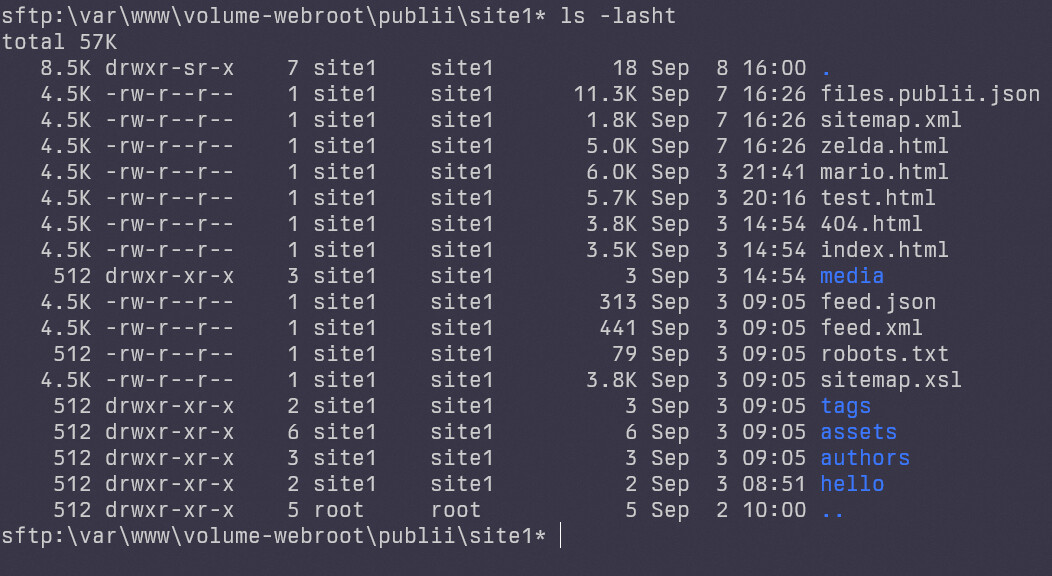

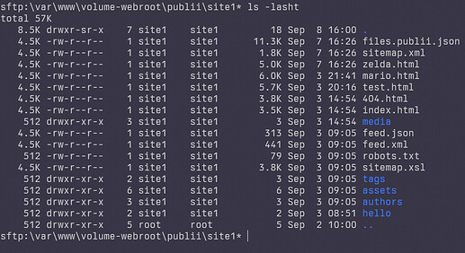

In the SFTP VM, I have a user named ‘site1’ with a group ‘site1’.

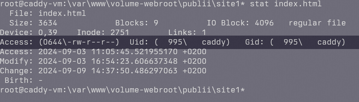

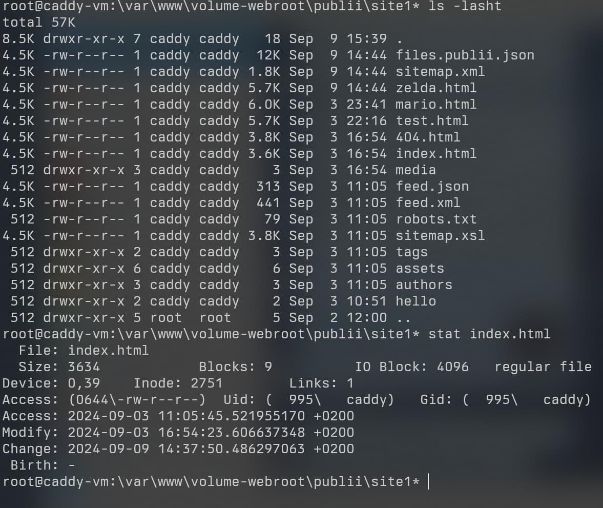

However, when I run ls -lasht, I end up with a different user name and group into Caddy VM.
Luckily, Caddy is able to read the files and I can display them on my web page.
But it’s not ideal. It would be cool to have the ‘caddy’ user/group from the Caddy VM
and the ‘site1’ user/group in the SFTP VM.
How do you handle chown when sharing a volume between multiple containers and VMs?
In my case, I have an SFTP server where I upload static files for my website (index.html, page1.html, main.css, etc…) and a server to display them, Caddy.

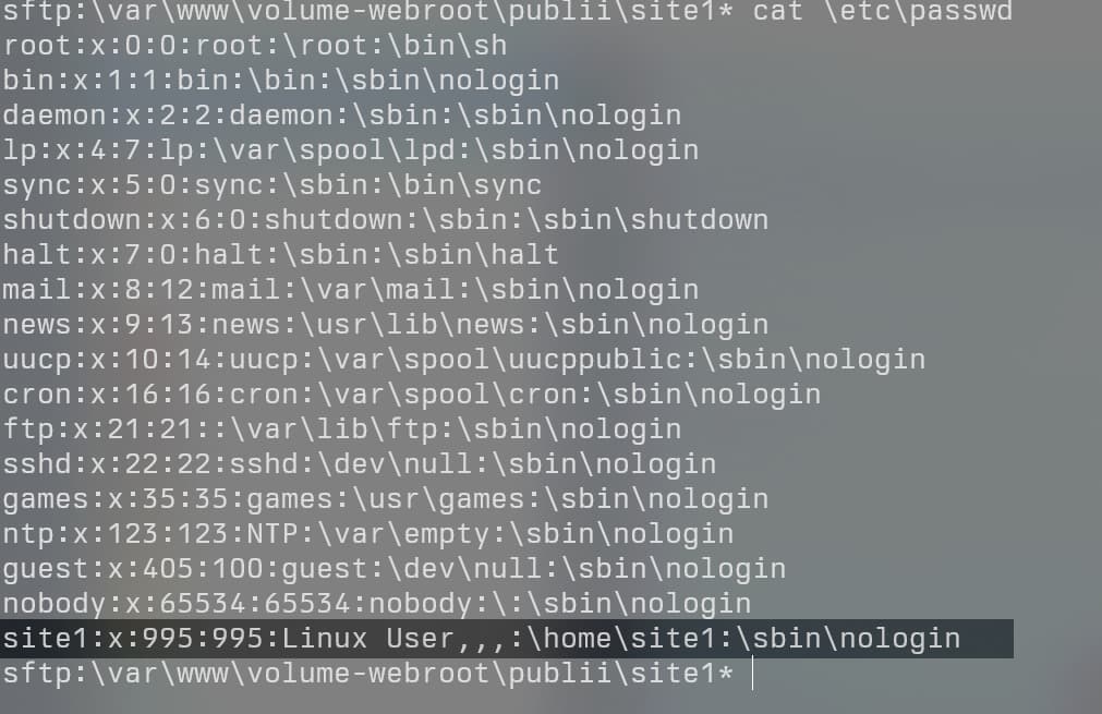

What I did, and it works.

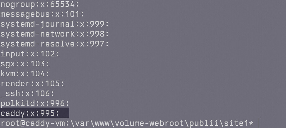

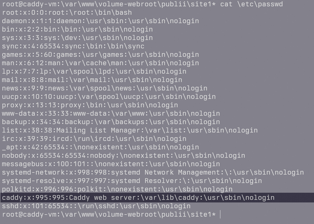

Caddy has a system user ID below 1000 when installing the package.
The default ID is 995, and the group is also 995 for the caddy user.

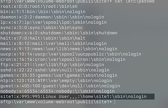

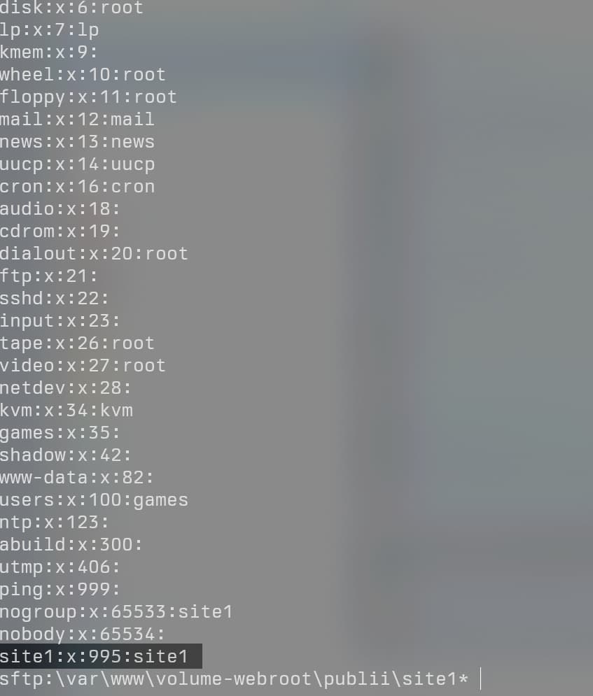

In the SFTP container, I created a user with an arbitrary ID, the same as Caddy’s, which is 995.
addgroup -g 995 site1
adduser -u 995 -G site1 -s /sbin/nologin site1
The match occurs when reading the /etc/passwd file.
Caddy can read the web files, and the SFTP server user can upload files successfully.

The ls command has a parameter --numeric-uid-gid (or -n). This parameter shows the numeric UID and GID. When your system performs access control checks, it uses the numeric UID and GID. Therefore, if the output of ls -lashtn matches one container with another, then you are fine.
Indeed, if you have several user account (i.e. different UIDs), and want them to access the same share, but you want to have an idea which account is adding which file, then you use a common GID for all those accounts.
Therefore,
  1. if you match the UIDs (or GIDs), then it works fine between the containers. It’s the UID/GID that matter in filesystem access controls.
  2. if you have a share and you would like to have an idea which container created a file, then you can use a common GID and change the group ownership accordingly of the files/directories so that all accounts on the same group have access.
