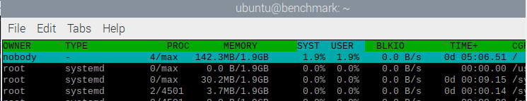

So what am doing is I first run the Apache Benchmark tool on my benchmark LXD container which sends 5000000 data packet request to the other Web Server LXD Container. And while I am running this, I run the ctop command on benchmark container, and here is what it shows
Command for ctop after installing it is: ctop
Command for Apache Bench: image
Alternately, are there some good benchmarking tools for LXD?
And what are you expecting to see?
I am expecting to see LXD container instances in CGROUP field whereas this is what I am getting:
I’m not sure ctop supports LXD, does it say it does? Are you running ctop on the host?
oh no, I haven’t checked that yet. I am running ctop on benchmark container
The benchmark container wont be able to see other containers either.
