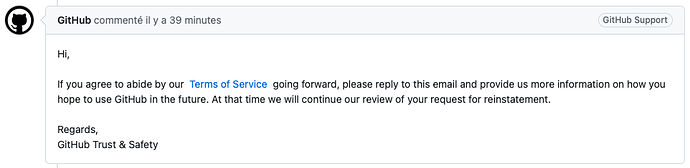

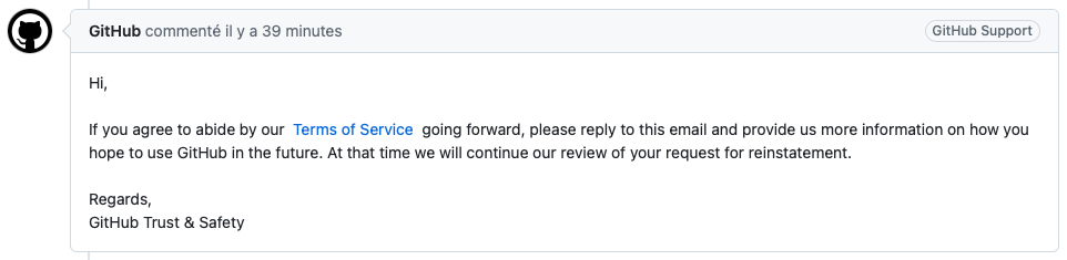

Looks like it’s up again, with a very confusing message from the support.
This is absolutely ridiculous.
Random spitball, but I’m curious if someone mistakenly flagged your repo/org for potential violation of Apple’s EULA and/or ToS since you aren’t allowed to run macOS VMs outside of Apple hardware; and they didn’t look close enough to see that you aren’t distributing prebaked VM images or OS install images.
This is probably it, although OpenCore itself is on GitHub. The thing is, nothing in the repos suggests to run macOS outside of macOS (as you can definitely run Incus with Colima on macOS and use my repositories to get macOS running, although I haven’t tried it). I think it’s the same rationale with OpenCore: you do what you want with it, but it doesn’t violate the ToS per se.
I also thought it could be related to the logo.
But anyway, the organization has been reinstated, all good.
