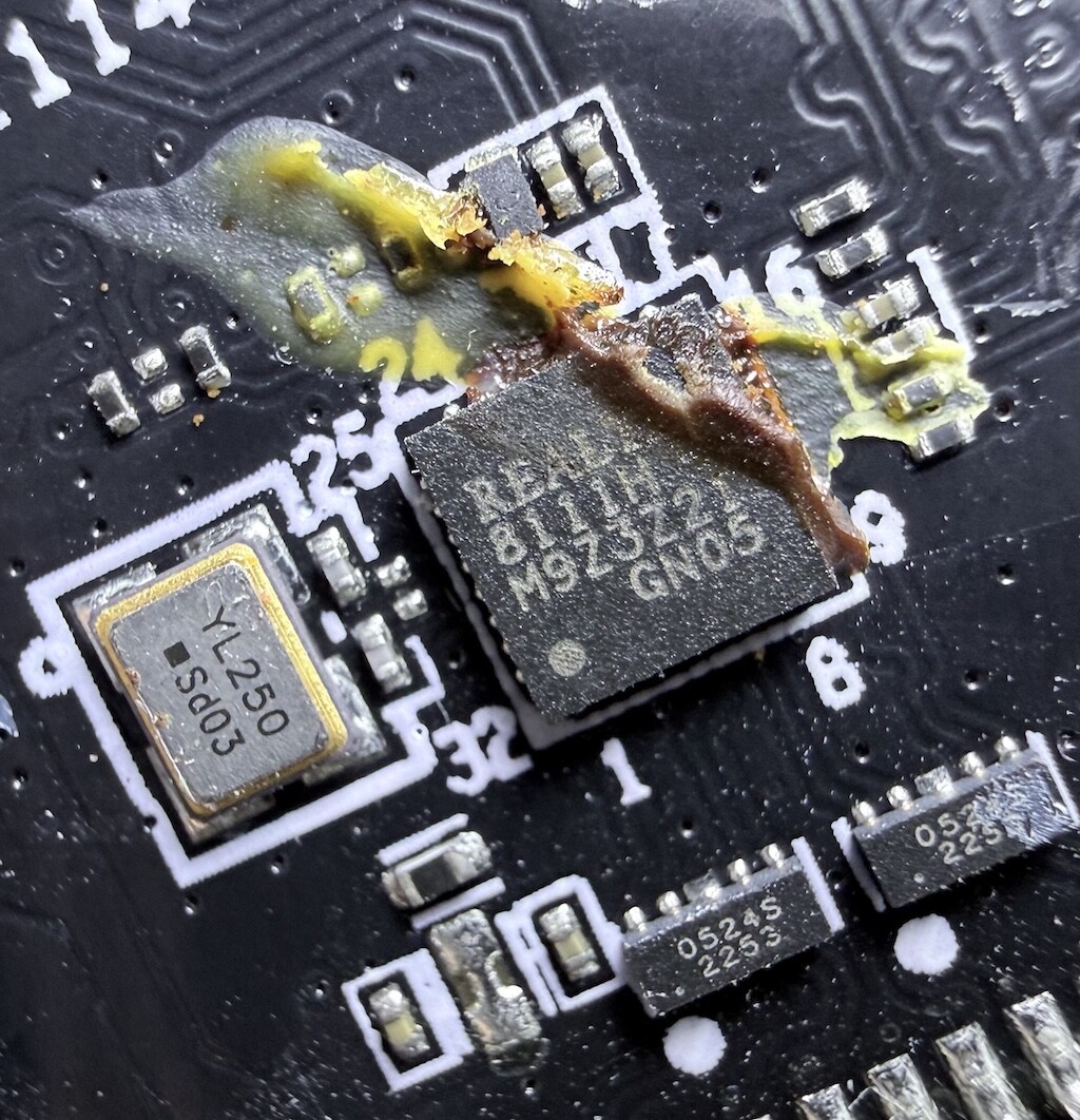

I opened the machine and found a CMOS battery with burnt glue right next to the Realtek chip :smiling_face_with_tear:. I tried to clean it using isopropyl alcohol and contact cleaner, but the chip died for good. The burnt glue was probably acting as a bridge and keeping it alive at 10M.
What a terrible coincidence. At least installing IncusOS and setting everything up from scratch helped me discover this. The machine had probably been suffering from a degraded network for a while. Thankfully the machine is still alive, I will disable this from BIOS attach an USB-Ethernet adapter and move back to IncusOS.

Ouch, that doesn’t look too good :frowning:
You won’t believe it and I have no idea how, but after cleaning it up, the chip went back to normal at full speed today :scream:! The God of electronics operates in mysterious ways.

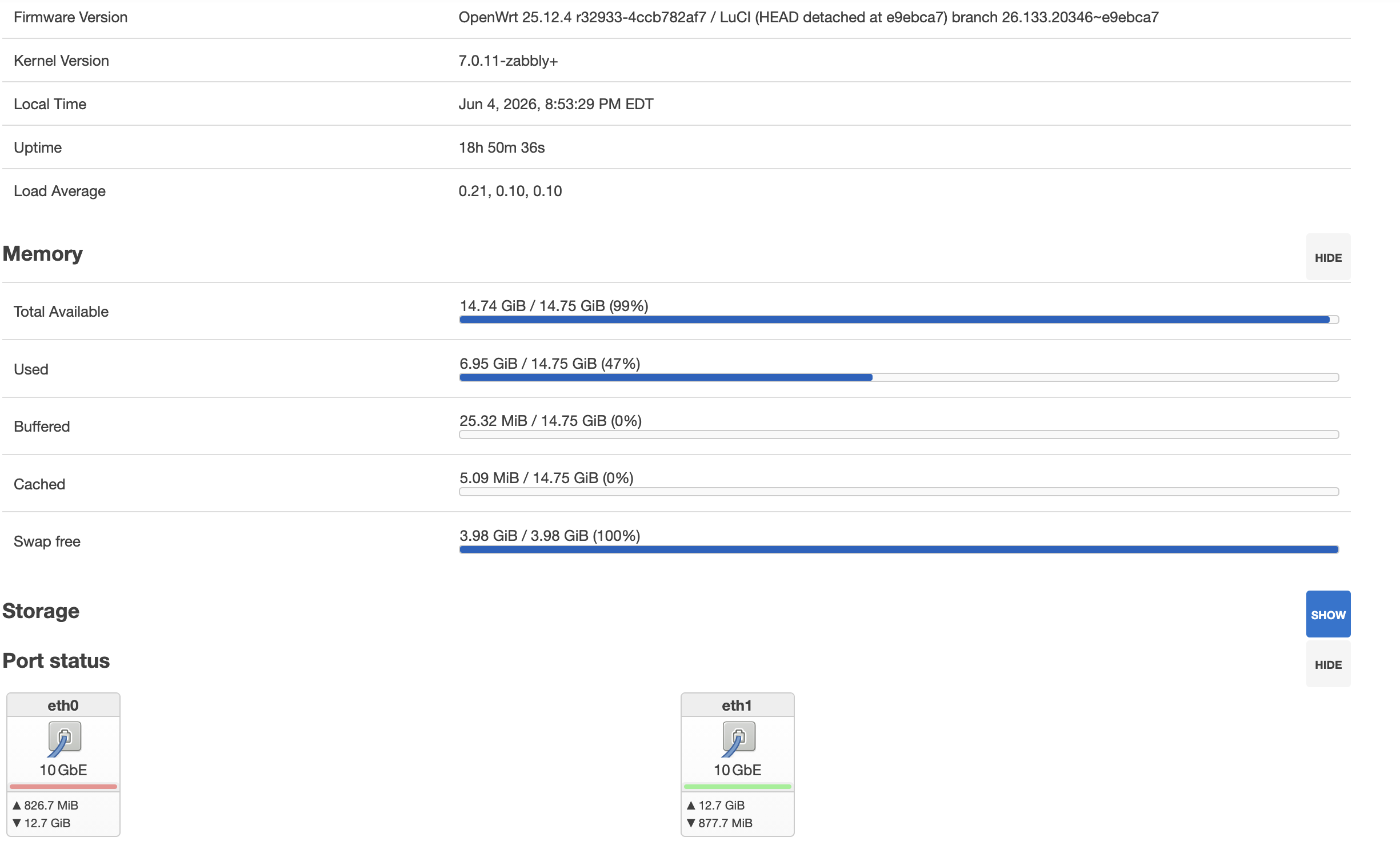

This gives you an idea what the container looks like running OpenWRT:
