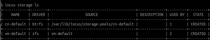

I ​decided on a hybrid ​solution to satisfy both Incus CNs and VMs storage in a COW filesystem:
My only real driver for looking into zfs ​in the 1st place was to ​plan for any future ​increased
use of Incus VMs.
​To date, I use far more Incus Containers than VMs but I ​initially thought I ​should see how to
install/config/manage zfs ​to do my work​ so I posted this question on the forum.
After reading​ the various responses and after many related search results & answers
to questions​ I’d had, I decided to keep​ using Ubuntu on BTRFS w a flat-subvolume structure
​utilizing a flat subvol structure (@, @home, @incus, @container, @opt, @var etc)​, w Incus
and ​continued use of Snapper ​& the​ gui btrfs-assistant to manage/utilize the BTRFS
snapshot/restore for system and subvolumes.
​So ​I adopted a hybrid storage approach.
​On a separate 2TB nvme I created a 1TB zvol and a 1 TB btrfs partition
I reinstalled Incus and during init named the storage pool “cn-default” on the btrfs partition of that 2nd NVME.
Then used Incus to create an Incus ZFS pool for Incus VMs​ using the 1TB zvol:
$ incus storage create vm-default zfs source=/dev/nvme1n1 zfs.pool_name=vm-default
Additional decision input for me came from reading several of stgraber’s comments in this 2025 thread resulting from a question someone posted ​who seemingly had ​similar goals as ​myself:
BTRFS OS Disk Subvolume for /var/lib/incus
​In my use, this hybrid solution​ should provide the best of both worlds w support​ing:
  • minimal learning curve as I’ve been using btrfs for years now and since btrfs is
    in-kernel, I can continue use of common linux tools and the snapper & btrfs assistant
    application combination
  • continue using current grub-btrfs to allow boot from snapshots at system boot
    Yes I know there is a similar functionality for zfs but I don’t have to make that change
  • importantly, my use gets the benefit of Incus:
    CN snapshot/restore on btrfs
    VM snapshot/restore on ZFS (minimizing impact of COW w VMs)
