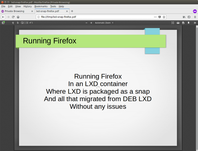

Here is my post about migrating from PPA to snap package,
