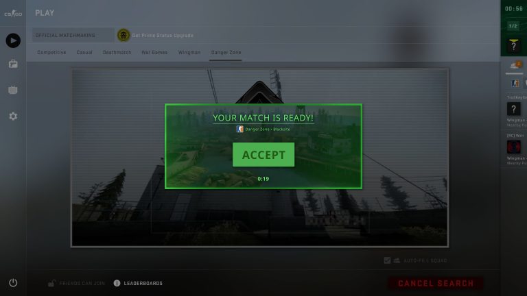

Added the following tutorial,
It is a dedicated tutorial on getting Steam to work inside a LXD container.
The reason I wrote it, was that there are many Steam github issues on getting Steam to work on Linux.
The audience is Steam users that do not need to learn too much about LXD and want to get their job (game) done quickly.

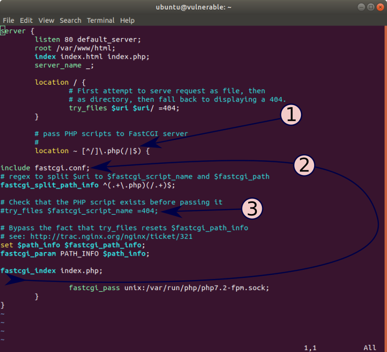

Added tutorial on how to test the recent php-fpm security vulnerability.
It is a security vulnerability that affects nginx+php-fpm, when nginx is configured in a very specific way for php-fpm. Sadly, the Nextcloud documentation describes that very bad configuration.

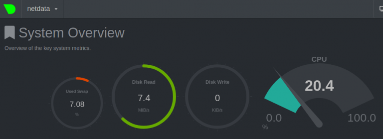

Netdata is a real-time monitoring tool for servers. As a tool, it is really big (popular) in the real-time monitoring business. You get more than 2000 metrics presented to you in real-time in order to figure out if your server is misbehaving.
In this post we install it in a LXD container
  1. in order to test-drive how it works in a safe environment (not on the host)
  2. and get a feeling of the separation between the host and a LXD container. For example, in the container, Netdata does show only the load for the container.
Netdata understands containers (LXC and LXD), and can show metrics when you install it on the host. We will install on the host in a future tutorial.
