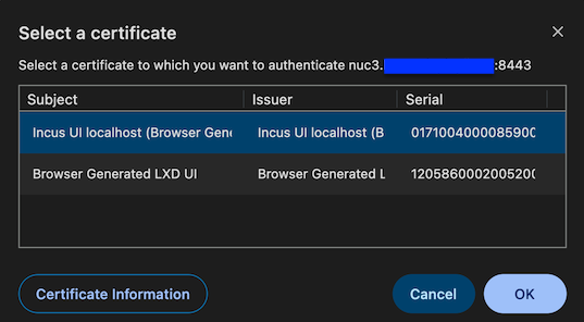

If I use my browser to connect directly to the incus host, nuc3.example.com:8443, the browser prompts me to choose between two certificates:
That in itself is OK - I’ve migrated from lxd to incus in the past. And if I choose the lxd one the incus UI works.
