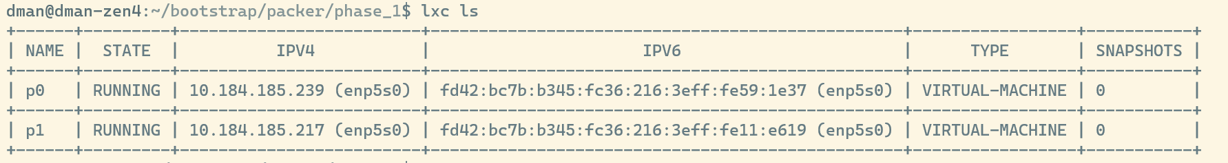

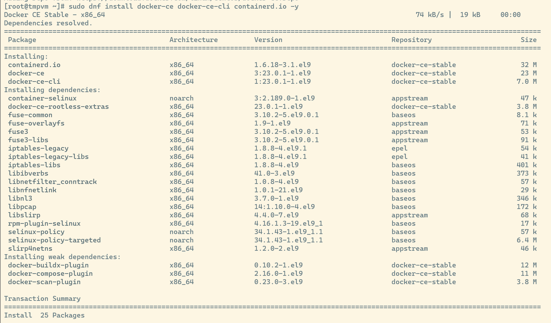

I then use packer to create an image called phase0 from rocky9-cloud-amd64-vm as a source. phase0 is able to boot successfully and get an ipv4 address. This involves booting the vm, waiting for it to get an ip, then running a sequence of exec calls using lxc ExecInstance api to modify the running instance (ie installing some packages using dnf, copying some files in). Finally I save the instance to a vm called phase1 using lxc CreateImage api.

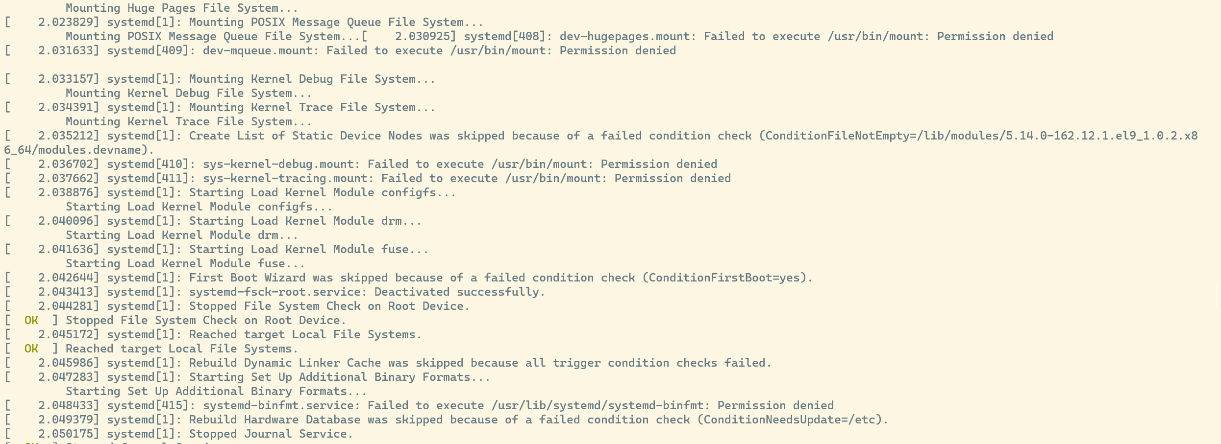

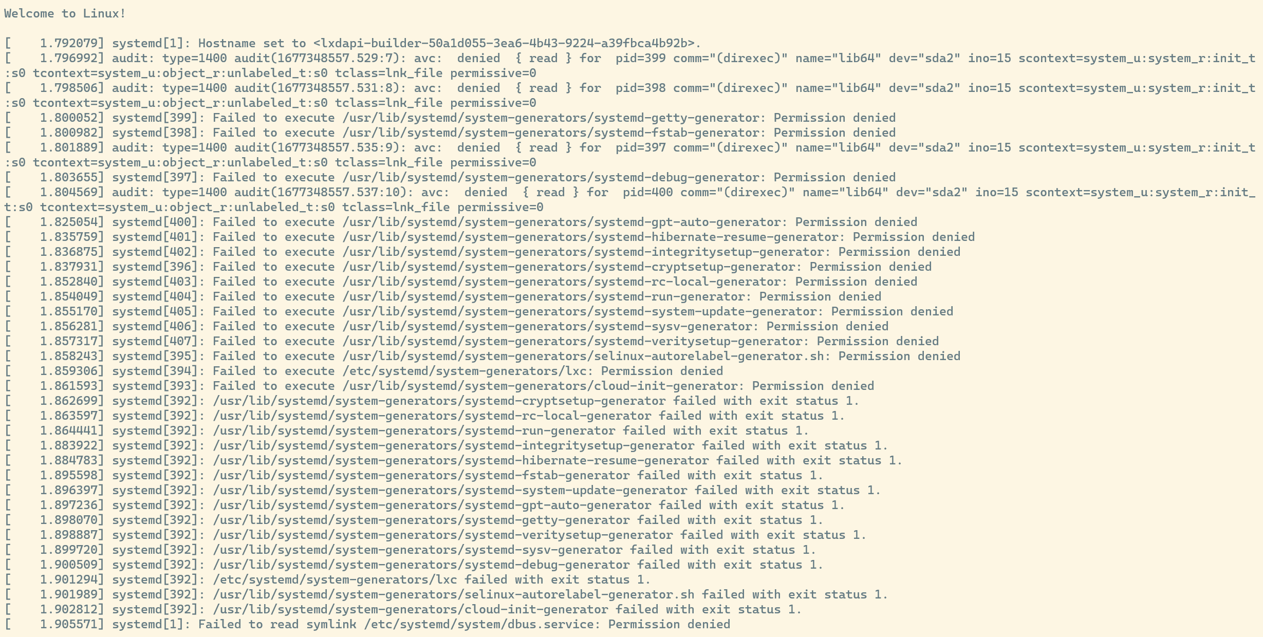

When I try to boot phase1 I run into issues. The vm never gets an ipv4 address. Looking into the boot console I see some issues (possibly selinux related).

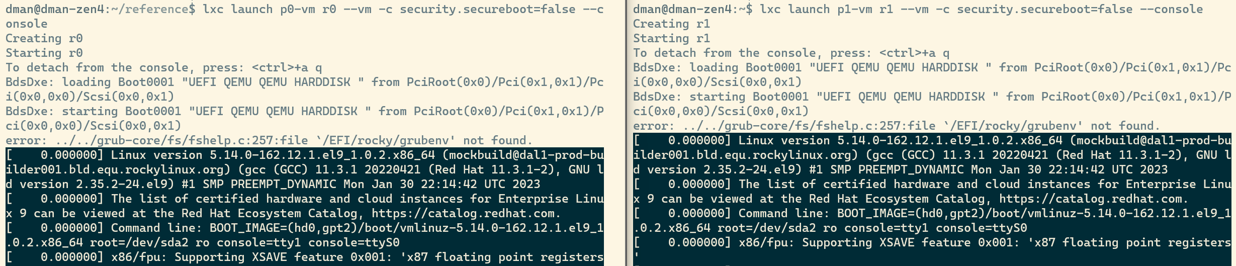

Here is a screenshot showing the issue. On the left is phase0 vm which boots successfully, on the right is phase1 vm which fails
Further permission errors also appear to be selinux related
Just for reference I tried to see if the kernel versions were different or were being booted by different arguments but looks like the arguments are the same
