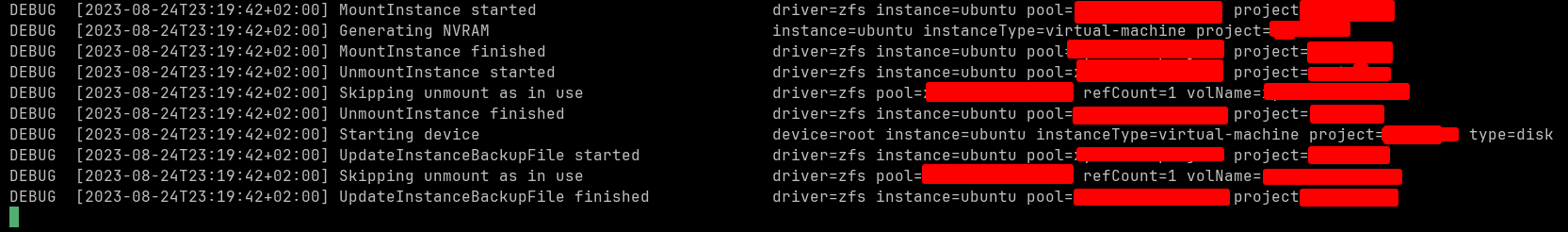

Hi there I am having this exact same problem
I installed LXD via snap, my host machine is running rocky linux 8
Any virtual machine I create does not start and gets stuck on trying to start up
No logs are shown when i do “lxc info vm --show-log”
Here are the logs from starting the VM, after that last log it still hangs on the start command
I just checked did some of the steps above @JannisBush mentioned when trying to figure out what the problem is, im having the exact same problems
@tomp hey, is there any previous reports a side from this one of situations like this?
Should I just make a new thread of my own about it?
