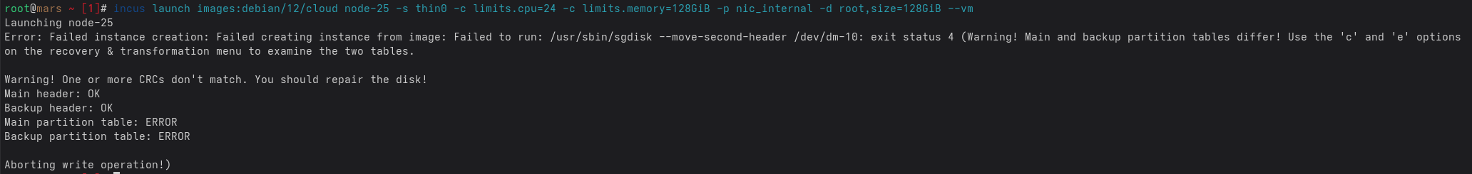

$ incus launch images:alpine/3.20/cloud testthin0 -s thin0 -c limits.memory=2GiB -c limits.cpu=8 --vm
I get this output:
Launching testthin0
Error: Failed instance creation: Failed creating instance from image: Failed to run: /usr/sbin/sgdisk --move-second-header /dev/vg0/images_6dc6e0522da81db5c254e14e038860636e1e26edd3e6748d4a5f1d32df7c16aa.block: exit status 4 (Warning! Main and backup partition tables differ! Use the ‘c’ and ‘e’ options
on the recovery & transformation menu to examine the two tables.
Warning! One or more CRCs don’t match. You should repair the disk!
Main header: OK
Backup header: OK
Main partition table: ERROR
Backup partition table: ERROR
Aborting write operation!)

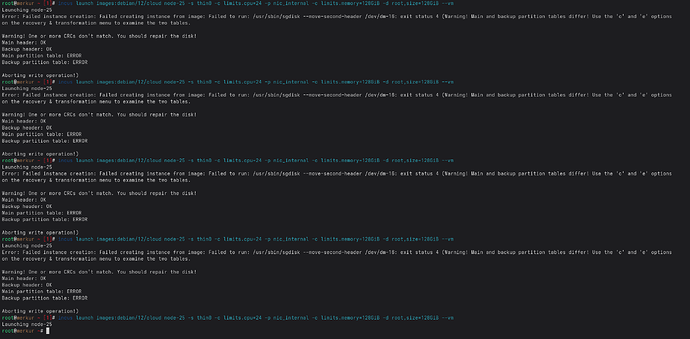

I would like to open this thread again because the problem is back and I think something is wrong with the VM images or LVM thinpool driver.
If you use thinpool as a VM image storage can you please try this command?
incus launch images:debian/12/cloud testvm -s thin0 -c limits.cpu=2 -c limits.memory=8GiB -d root,size=128GiB --vm
And check if your VM boots up?
I can’t see this issue with Btrfs pool.
What I also noticed is that incus export successfully exported an instance and when I imported it on another machine the disk image was unbootable and data damaged. I would say it’s hardware problem but I experience the first or the other issue on five different machines with Fedora and Debian. Both issues always occurs on LVM thinpool.
One more thing I noticed. I tried to run incus launch multiple times in row and ended up with running instance that’s stack in the boot sequence.
