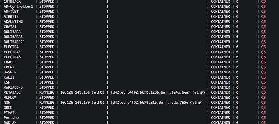

I have a server that previously fine containers are misbehaving.
The running container suddenly loses its IP4, then If I stop it with force and do incus network set incusbr0 ipv4.dhcp true and restart it then IP4 will work for a while.
Thankfully, it is only one server.
Any ideas what is going on or how to fix it.

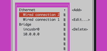

I faced same issue and appear the issue that I have incusbr0 twice in Network Manager, I removed (using nmtui) both of incusbr0 from Network Manager and restart the system then everything back to normal

After a forced shutdown, I start it again... Everything fine for 10 minutes
root@METABASE:~# ip a
    inet6 ::1/128 scope host
48: eth0@if49: <BROADCAST,MULTICAST,UP,LOWER_UP> mtu 1500 qdisc noqueue state UP group default qlen 1000
    link/ether 10:66:6a:4a:6e:a7 brd ff:ff:ff:ff:ff:ff link-netnsid 0
    inet 10.126.149.138/24 metric 100 brd 10.126.149.255 scope global dynamic eth0
       valid_lft 3580sec preferred_lft 3580sec
    inet6 fd42:ecf:4f02:b679:1266:6aff:fe4a:6ea7/64 scope global mngtmpaddr noprefixroute
    inet6 fe80::1266:6aff:fe4a:6ea7/64 scope link
Then after a few... it loses IP4
46: eth0@if47: <BROADCAST,MULTICAST,UP,LOWER_UP> mtu 1500 qdisc noqueue state UP group default qlen 1000
