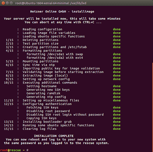

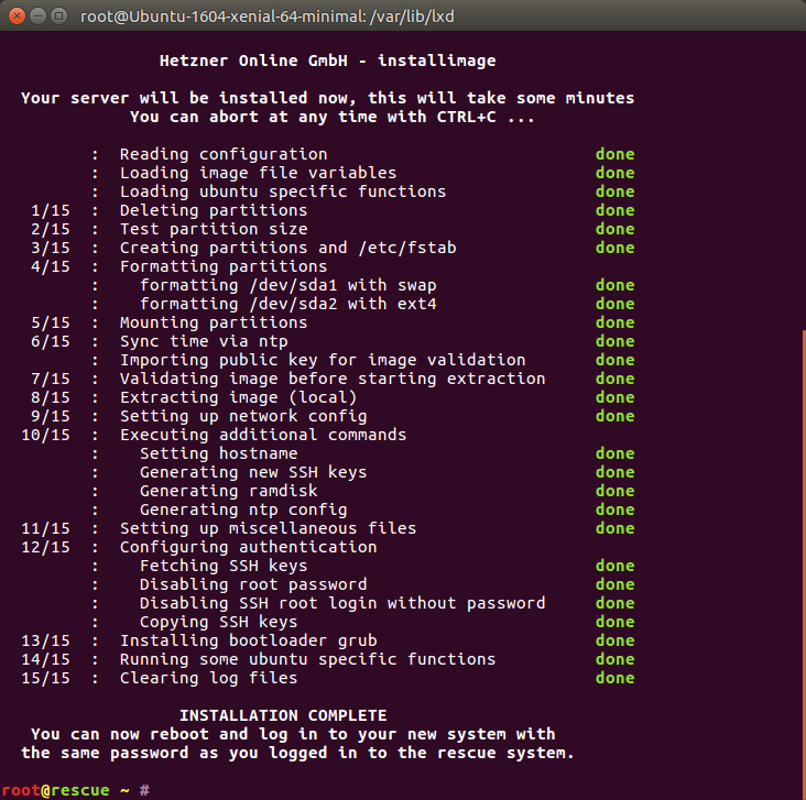

With hetzner, there is this trick that allows you to repartition the VPS disk so that with the basic package you can keep ZFS happy with direct access and all. Note that ZFS is more than just a mere filesystem, so there is some extra benefit as well.
Hetzner also offers now the option to attach block storage to a VPS. That would be an alternative if you do not want to go into repartitioning. In this case, you will be paying a bit extra for that additional storage.
