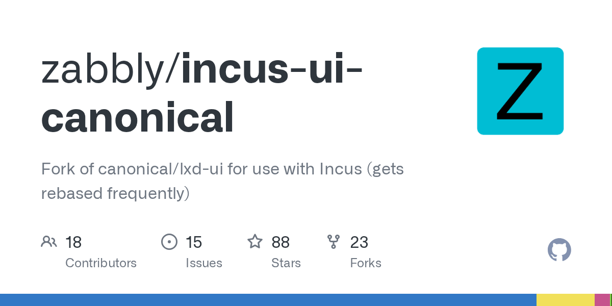

I’m kind of confused here. So when I look at the readme here:
…it would have me install straight up lxd:
sudo snap install lxd
So what I’m hearing is that a “switcheroo” is later on done, so now that ui uses incus as the backend, not lxd?
But I don’t see mention of a “switcheroo” anywhere in that README. What I see is that in step 3, we are “Done”. No further mention of incus. The end of the line, so to speak, is reached with lxd. :man_shrugging:
Here’s the jist I gathered: owing to Caninocal’s highly distasteful design choice of Node.js (and to a lesser degree, Typescript), it’s extremely hard to ever make a proper Debian package of incus-ui-canonical (called more generically, “incus-ui”). At best, we might hope for some hero-like person to provide an unofficial Debian source for it.
More likely, but even worse security-wise, someone will make a Docker container, where the 600ish (risky-for-suppply-chain-attacks) Node.js library dependencies will be “muck-shovelled” into, so to speak.
Updating a README is pretty low priority. :wink: With the Zabbly repo enabled, you can run apt install incus-ui-canonical to get the web UI.
