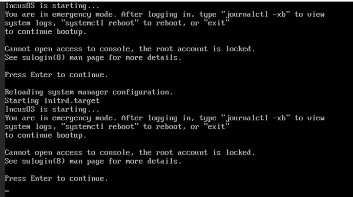

Is there a way to get a shell both in initramfs and on the fully-booted system in case the system gets into emergency mode to debug things? I’m stuck in initramfs for now and could do with a bit of information. I couldn’t find anything in the doc there (no obvious seed option). I’m using the latest image.

However I’m stuck on first boot (after successful secure registration followed by first boot install).
This is on a Dell Poweredge R650, clean install from IncusOS_202507032049. The system is not far enough in boot to dump emergency keys, AFAICT.
This is a clean install.
Okay, so just to confirm, you managed to boot from the install ISO, it did the secure boot enrollment and then you saw the install screen showing the data being copied and asking for you to remove the install media?
Then after you removed the install media and rebooted, you got this boot failure?
Precisely: custom ISO, SB enrollment, install screen, removing the virtual disk and reboot.

But I got it installed and booting in the end, it installed, but failed after reboot, as shown above.

The only reason I can think of for failing at that boot stage would be an issue locating the installed system…
It does get into initramfs though, so the EFI partition is found. Then whether Incus does something smart with the disk ID provided in the seed or just rely on systemd’s DDI logic, it should work (DDI should only look for rootfs on same disk as EFI AFAIK). Hence my puzzlement.
I’ll wipe all the other disks however and report back: who knows what might still be on there.
