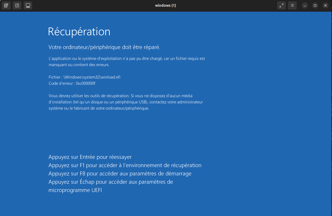

But here is my error when i try to relaunch the VM (which was working perfectly before i removed the install device :
sorry it’s in french but i think you’ll understand whats is going on, if not tell me

Can you show the full incus config show --expanded Windows?
I’d generally expect Windows to behave that way if the storage driver changed somehow or if there’s something odd going on with the devices.

Okay, so that looks like a correct copy, nothing got dropped/changed as far as I can tell.
What storage backend are you using?
And what version of Incus on what distro would be useful too.
We’ve had some issues with copies and handling of sparse data that could explain this.

Okay, using dir, it shouldn’t be the sparse storage issue and 6.10.1 on 24.04 would have had the fix for that anyway.
I found the error !
Here :
Inside the Windows VM, run
C:\Windows\System32\Sysprep\Sysprep.exe
Choosed “Enter System Out-of-Box Experience (OOBE)”, tick “Generalize”, and set shutdown.
You need to untick the “Generalize” option
Sysprep with “Generalize” can sometimes strip drivers or break the boot config if the Windows install didn’t fully complete setup. Some folks recommend not generalizing in certain VM environments. Try a test VM without Generalize (just OOBE + Shutdown).
After this you still need to configure your Windows setup and you have some errors in the terminal of opentofu that i need to look, but it work just fine
Ah, interesting, so it basically broke itself by removing required drivers, oops :wink:
