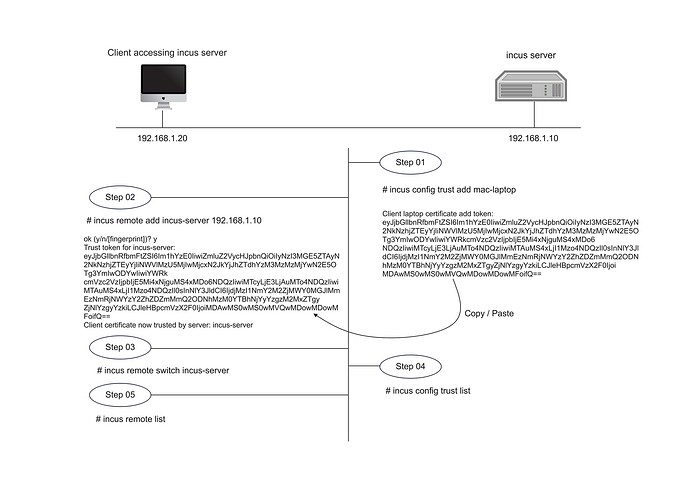

I have been spending time in writing simple notes on incus for beginners (like myself). Let me know if this image helps to explain the steps involved.
