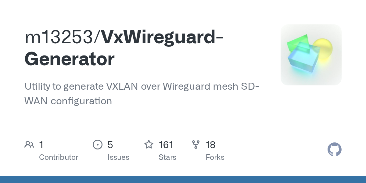

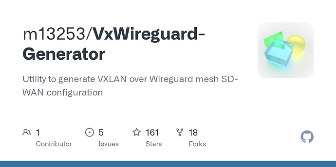

Just saw this thread…
This might interest you…
m13253/VxWireguard-Generator: Utility to generate VXLAN over Wireguard mesh SD-WAN configuration
Run Wireguard on host “in-kernel”
Configure VXLAN in containers to build the mesh for each separate VNID.
The Wireguard VPN provides the encyption
