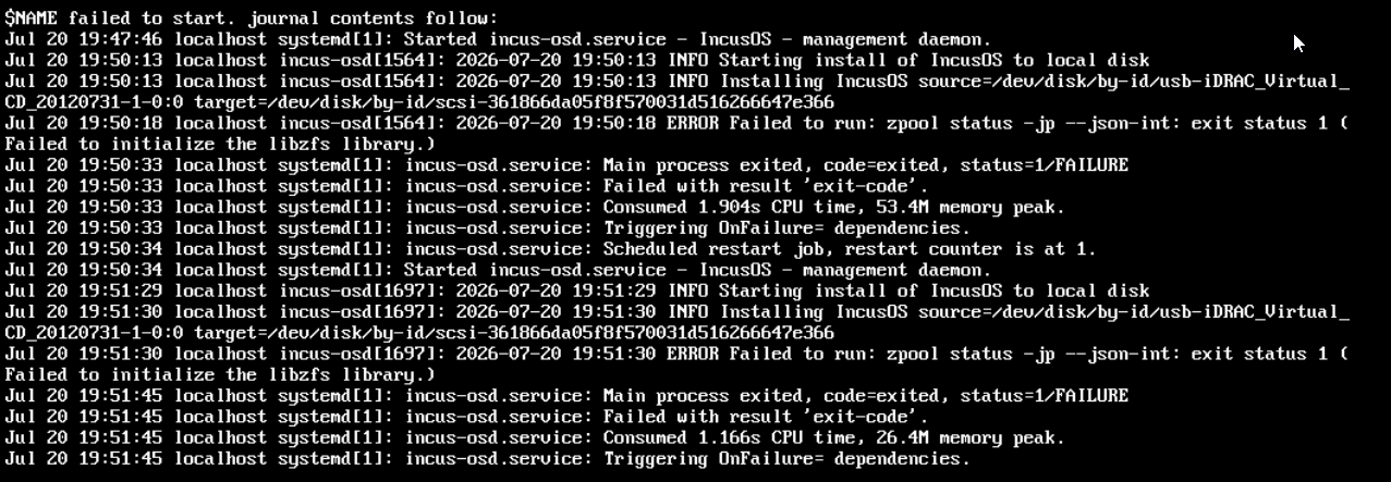

ERROR Failed to run: zpool status -jp --json-int: exit status 1
the installation fails with this error
Thank you for your help.
Regards Roger
IncusOS_202607192224.iso
I did a quick test install to rule out a bad ISO or something on our end, but it’s working fine here.
The error could be coming from a temporary issue (virtual media is glitchy somehow) or because one of the disks in the system is somehow making ZFS very unhappy.
@gibmat does that ring a bell? Also, I just noticed the $NAME in the error above, looks like a bad handling of the IncusOS/HypervisorOS logic.
I’ve never seen that error (Failed to initialize the libzfs library) on IncusOS. Looks like something corrupted the loading of the user-space zfs library, or less likely the kernel module. As @stgraber has ruled out a bad install media, it’s probably something with the virtual media device.
