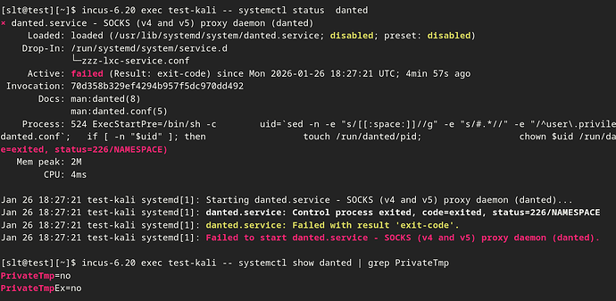

I’m facing an error with the dante-server package on a privileged container and I don’t have this error on an unprivileged container.
Jan 26 18:15:55 test-kali (sh)[510]: danted.service: Failed to set up mount namespacing: Permission denied
Jan 26 18:15:55 test-kali (sh)[510]: danted.service: Failed at step NAMESPACE spawning /bin/sh: Permission denied

[slt@test][~]$ incus-6.20 exec test-kali -- journalctl -u danted
Jan 26 18:15:55 test-kali systemd[1]: Starting danted.service - SOCKS (v4 and v5) proxy daemon (danted)...
Jan 26 18:15:55 test-kali systemd[1]: danted.service: Control process exited, code=exited, status=226/NAMESPACE
Jan 26 18:15:55 test-kali systemd[1]: danted.service: Failed with result 'exit-code'.
Jan 26 18:15:55 test-kali systemd[1]: Failed to start danted.service - SOCKS (v4 and v5) proxy daemon (danted).
Jan 26 18:27:21 test-kali systemd[1]: Starting danted.service - SOCKS (v4 and v5) proxy daemon (danted)...
Jan 26 18:27:21 test-kali systemd[1]: danted.service: Control process exited, code=exited, status=226/NAMESPACE
Jan 26 18:27:21 test-kali systemd[1]: danted.service: Failed with result 'exit-code'.
Jan 26 18:27:21 test-kali systemd[1]: Failed to start danted.service - SOCKS (v4 and v5) proxy daemon (danted).
I search the internet and found about setting PrivateTmp=false in the systemd override, but from what I can see, this is already set by /run/systemd/system/service.d/zzz-lxc-service.conf:
Any idea on how to debug this?

Privileged containers have much stronger AppArmor and similar security profiles to try and prevent them causing a bunch of damage to the host system, whether intentionally or by accident.
This does pretty negatively affect some of the newer security features of systemd.
You may want to run systemctl cat on the unit to see what it sets and what’s overriden, you may need to override additional keys to get things going.
You could also try setting security.nesting=true which makes your privileged container even less safe by having to relax some of those namespacing features.
I tried overriding additional keys but haven’t found the “missing” ones.
However, setting security.nesting to true allowed me to start the service as expected. That’s a work around I can live with for the time being!
Thank you! :slight_smile:
