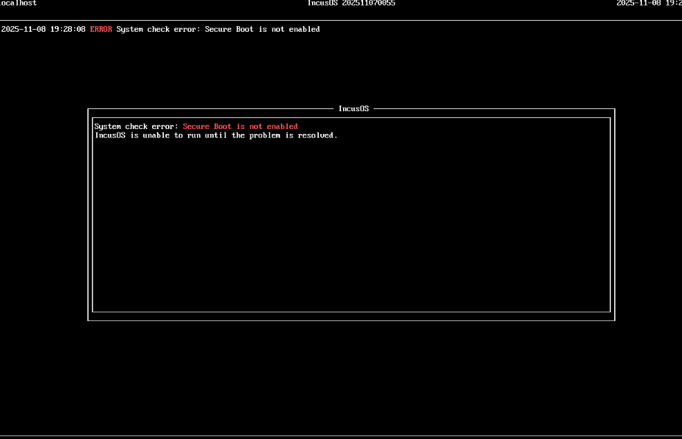

i followed the instructions to run IncusOS inside incus, but it won’t work
system check error: secure boot is not enabled
Incus version 6.17 on VoidLinux.

There’s likely some issue with the OVMF firmware on VoidLinux.

Yeah, the edk2 driver is selecting a non-Secure Boot OVMF file: incus/internal/server/instance/drivers/edk2/driver_edk2.go at main · lxc/incus · GitHub
This works for me as a temporary hack:
mv /usr/share/qemu/edk2-x86_64-code.fd /usr/share/qemu/edk2-x86_64-code.fd.bak
ln -s /usr/share/qemu/edk2-x86_64-secure-code.fd /usr/share/qemu/edk2-x86_64-code.fd
Yeah, most likely scenario is that this distribution doesn’t ship a Secure Boot enabled firmware at all.
It should be possible to confirm that theory by doing:
  • incus launch images:debian/13 test-d13 --vm -c security.secureboot=true
  • Wait for VM to boot
  • incus exec d13 -- dmesg | grep -i secure
This should normally show:
stgraber@castiana:~$ incus exec test-d13 -- dmesg | grep -i secure
[    0.000000] Kernel is locked down from EFI Secure Boot; see man kernel_lockdown.7
[    0.000000] secureboot: Secure boot enabled
[    1.229895] integrity: Loaded X.509 cert 'Debian Secure Boot CA: 6ccece7e4c6c0d1f6149f3dd27dfcc5cbb419ea1'
If it doesn’t, then your distribution either doesn’t ship a Secure Boot firmware at all, or it ships it under a name which Incus doesn’t recognize. If the latter, it’s an easy fix to the Incus code to make it work.

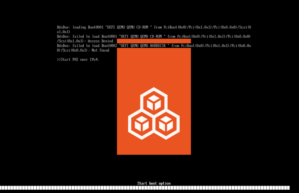

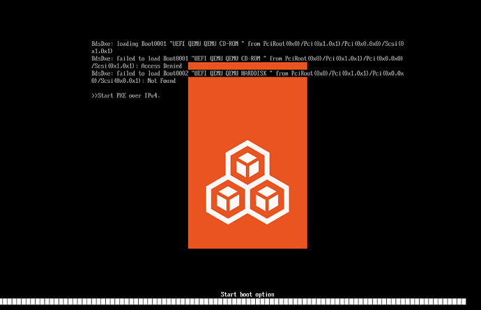

I did experiment with both 5.X and 6.X with the settings in various states;
I either get this;
or with security.secureboot=false
Then
Then when “reboot into firmware” (secureboot is disabled, but prety confused at this point)
(sidenote: Incus docs say “requires secure boot” then your VM docs are like “disable secureboot”, im sure technically there is a difference between the two- but its somewhat confusing for the layman)
Yeah, security.secureboot controls whether the default keys (Microsoft’s) are loaded or not. So we need it set to false to give us a clean slate that we can populate with our keys (therefore preventing any other OS from being booted).

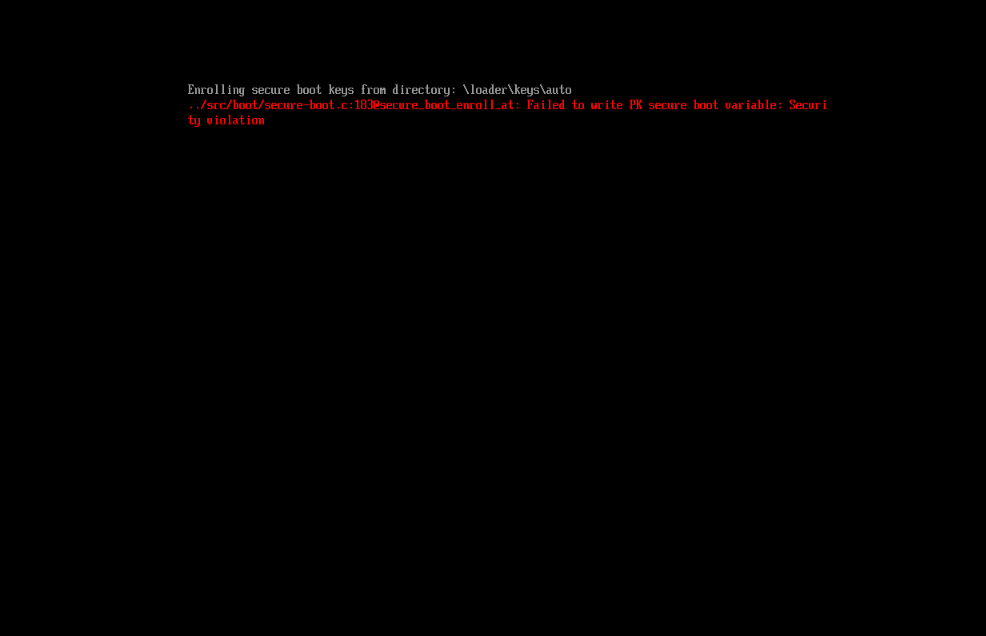

The PK failure you see on screen is pretty odd, there’s definitely something different and quite likely wrong with the firmware build over there…
Short version, with LXD’s current firmware, you need to do the enrollment completely by hand, similar to what you have to do on a physical server.
For that, follow the Incus instructions but hit ESC early in boot so you can get in the UEFI firmware menu, then go to the Secure Boot section, select Custom mode and then import all the keys from the install media one by one.
