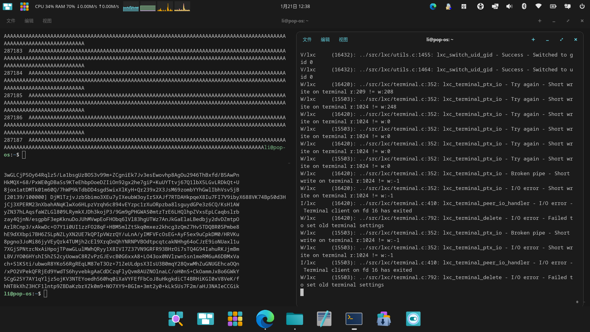

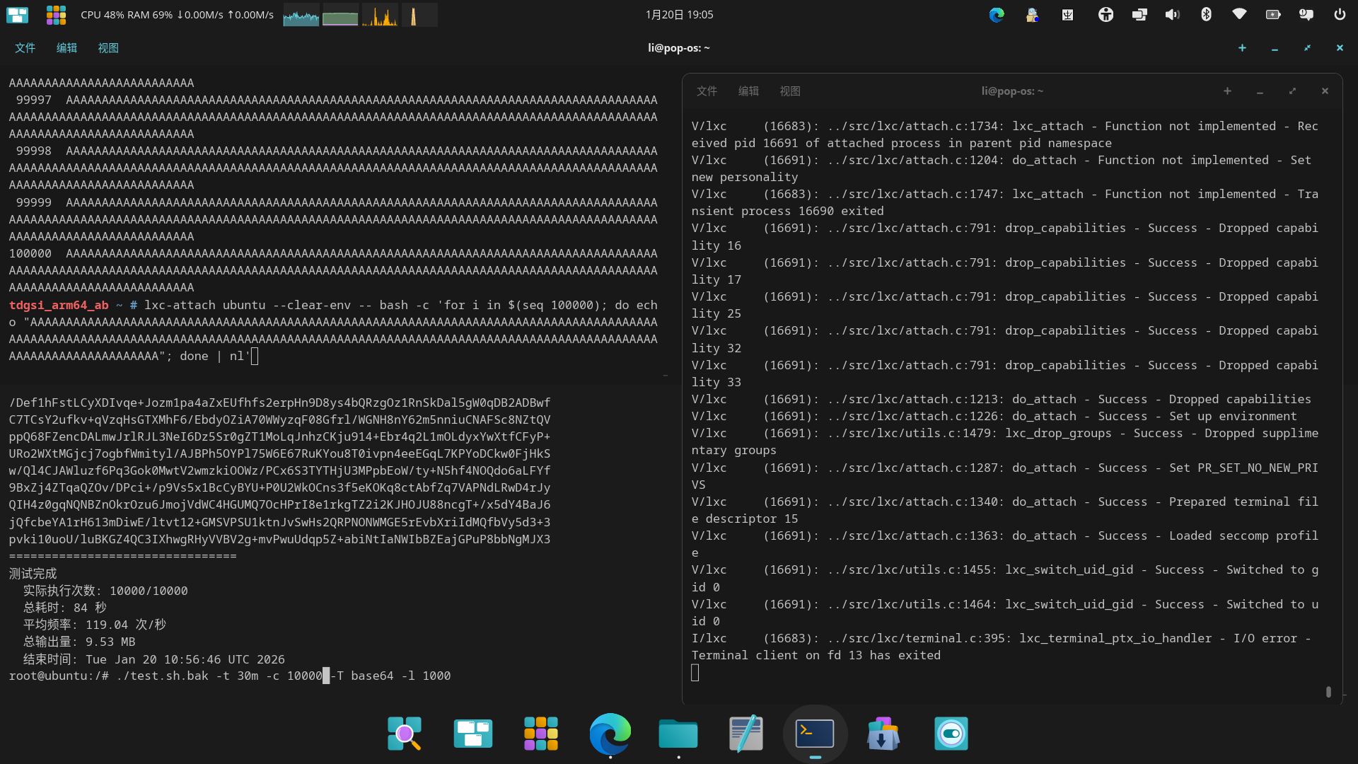

Hi @mfenniak ,
Just now, I tried to simulate your environment for some tests. Is your connection to the VM ssh based?
If so, I use the adb shell to simulate remote connections and limit the CPU to 50% (my arm64 8 cores CPU). Limit the bandwidth to 8Mbps (1Mb/s). It was not until the CPU was fully loaded for 8 minutes that the short write was finally repeated.
Let’s simply reproduce:

In logcat, Try again is returned first. 5 seconds later, poll() detects a timeout and fd has disconnected the Broken pipe. Finally, all subsequent write() returns -1 and set errno to I/O error. However, in the syslog, lxc does not return errno for this section. I cannot make specific judgments.
PID: 16420 CMD: lxc-attach ubuntu -- bash -c 'for i in $(seq 1000000); do echo "A...A"; done | nl'
W/lxc     (16420): ../src/lxc/terminal.c:352: lxc_terminal_ptx_io - Try again - Short write on terminal r:209 != w:208
W/lxc     (16420): ../src/lxc/terminal.c:352: lxc_terminal_ptx_io - Try again - Short write on terminal r:1024 != w:0
W/lxc     (16420): ../src/lxc/terminal.c:352: lxc_terminal_ptx_io - Broken pipe - Short write on terminal r:1024 != w:-1
W/lxc     (16420): ../src/lxc/terminal.c:352: lxc_terminal_ptx_io - I/O error - Short write on terminal r:1024 != w:-1
I/lxc     (16420): ../src/lxc/terminal.c:410: lxc_terminal_peer_io_handler - I/O error - Terminal client on fd 16 has exited
W/lxc     (16420): ../src/lxc/terminal.c:792: lxc_terminal_delete - I/O error - Failed to set old terminal settings
PID: 15503 CMD: lxc-attach ubuntu -- bash ; ./test.sh -timeout 30m -count 100000 -Type base64 -length 1000
W/lxc     (15503): ../src/lxc/terminal.c:352: lxc_terminal_ptx_io - Try again - Short write on terminal r:1024 != w:248
W/lxc     (15503): ../src/lxc/terminal.c:352: lxc_terminal_ptx_io - Try again - Short write on terminal r:1024 != w:0
W/lxc     (15503): ../src/lxc/terminal.c:352: lxc_terminal_ptx_io - Broken pipe - Short write on terminal r:1024 != w:-1
W/lxc     (15503): ../src/lxc/terminal.c:352: lxc_terminal_ptx_io - I/O error - Short write on terminal r:1024 != w:-1
I/lxc     (15503): ../src/lxc/terminal.c:410: lxc_terminal_peer_io_handler - I/O error - Terminal client on fd 16 has exited
W/lxc     (15503): ../src/lxc/terminal.c:792: lxc_terminal_delete - I/O error - Failed to set old terminal settings
