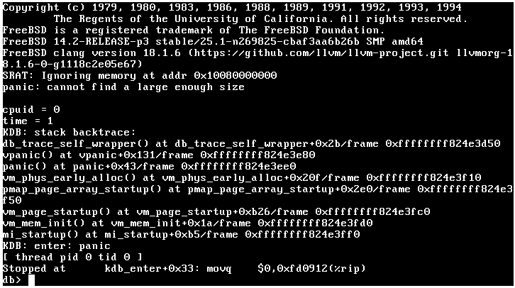

We have some FreeBSD VM (OPNSense 25.1 / or PFSense 2.8.0) that we use. When we switched from Incus LTS 6.0.4 to Incus 6.14 the FreeBSD VMs do not boot anymore with more than 2 GB RAM assigned. For every other OS, no problems.
If it is more (e.g. 4 GB) the FreeBSD VM throws the following error:
Reducing the RAM to 2 GB or below, the FreeBSD VMs function as expected. I tried it with two fresh debian trixie bare metal installations on the same host with fresh OPNSense and PFSense installations. When using LTS and more than 2 GB RAM not problem, when using 6.14 the above crash happens.

Start the VM. The error from section “Description” occurs on Incus 6.14 with more than 2 GB RAM, not on Incus LTS 6.0.4.
Any Ideas what could cause this?

Can you try setting raw.qemu.conf to
[memory]
maxmem = "65536M`
I wonder if it’s the 1TB max hotplug memory which is tripped FreeBSD somehow.
Thanks for you fast reply. Adding a file /run/incus/NAMEOFVM/raw.qemu.conf with the content
[memory]
maxmem = "65536M"
and then stopping and starting the VM again does not help. I also aligned the values with “4096M” and tried replacing the whole raw.qemu.conf with the content of qemu.conf from the Incus 6.0.4 install.
No success :frowning:
This approach will fail by design as Incus rewrites the file on every start of the instance. You need to edit your instance configuration (incus config edit <instance-name>) and add the value there. You might need to add raw.qemu.conf as it might not exists.
You are right, Instance options - Incus documentation describes it very clearly.
running incus config edit VMNAME and adding the following
  raw.qemu.conf: |-
    [memory]
    maxmem = "65536M"
solves the problem :white_check_mark:
FreeBSD VMs now booting up perfectly fine with > 2 GB RAM on Incus 6.14.
Thank you for your fast support!
Given some of the weirdness we’ve had with calculating those memory amounts, there’s a good chance I’ll be introducing a limits.memory.hotplug to control the amount of hot-pluggable memory so we can tweak that without having to use raw.qemu.conf.
