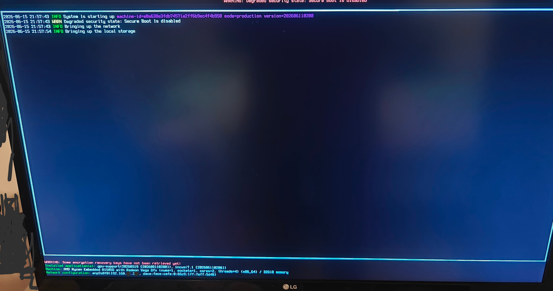

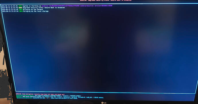

Looks like I need help with installing gpu-support for AMD (HP t640 device AMD Ryzen Embedded R1505G\Vega GPU).
IncusOS 7 is installed successfully, then hangs on loading gpu-support extension.
Last msg on display is “Bringing up the local storage”, and then display goes off.
