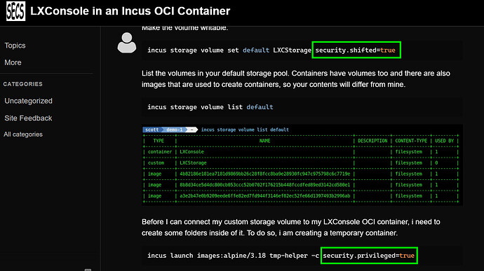

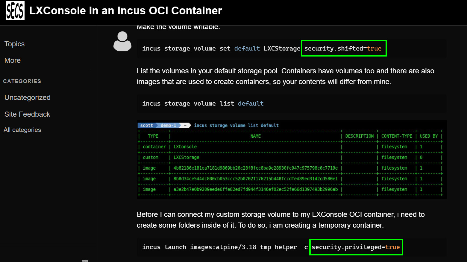

I see that Scottibyte also uses shifted true when a container is in privileged mode.

security.shifted doesn’t really make sense when security.privileged it used as security.privileged makes it so the container doesn’t use a uid/gid map at all, so by definition, there’s no need to shift anything.

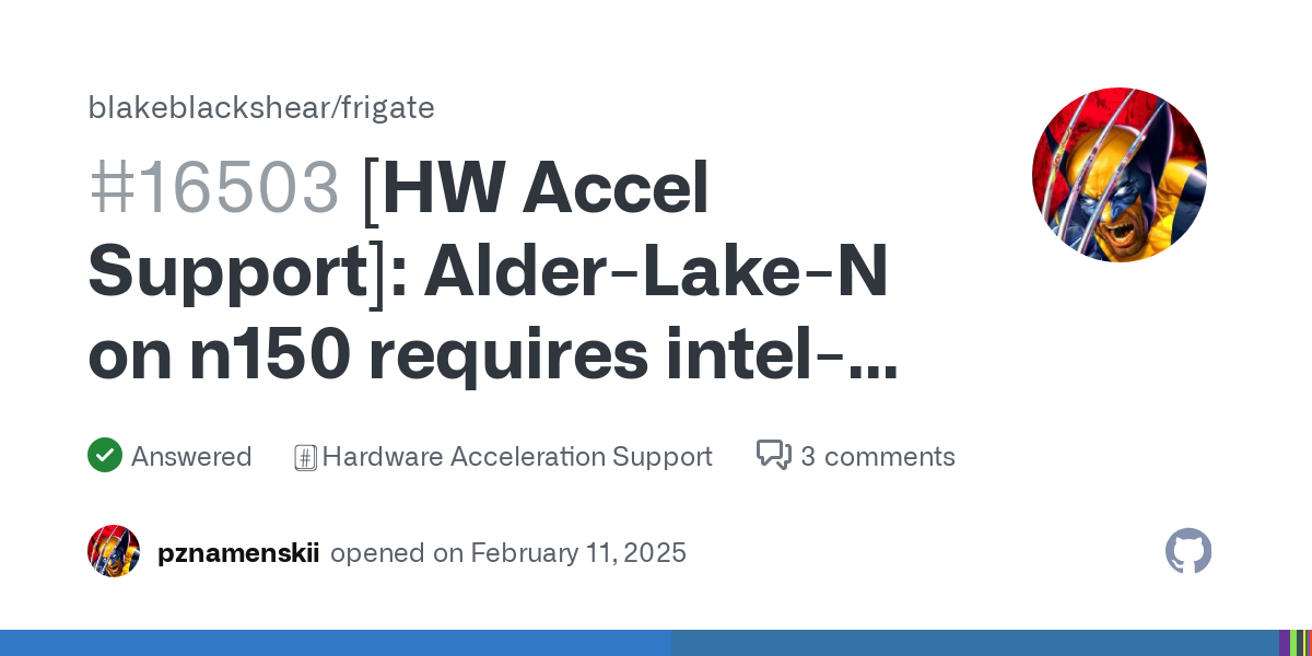

Can you use HW acceleration on the host?
See this thread on the hardware aspect, [Solved] VAINFO:libva error: /usr/lib/dri/iHD_drv_video.so init failed / Newbie Corner / Arch Linux Forums
Okay, by sharing the logs—especially the one about the driver version—I just realized that the drivers weren’t the same version between my Arch host and my Debian container. I just tested with an Arch container, and everything works now.
I don’t even need to add the group ID. It work.
