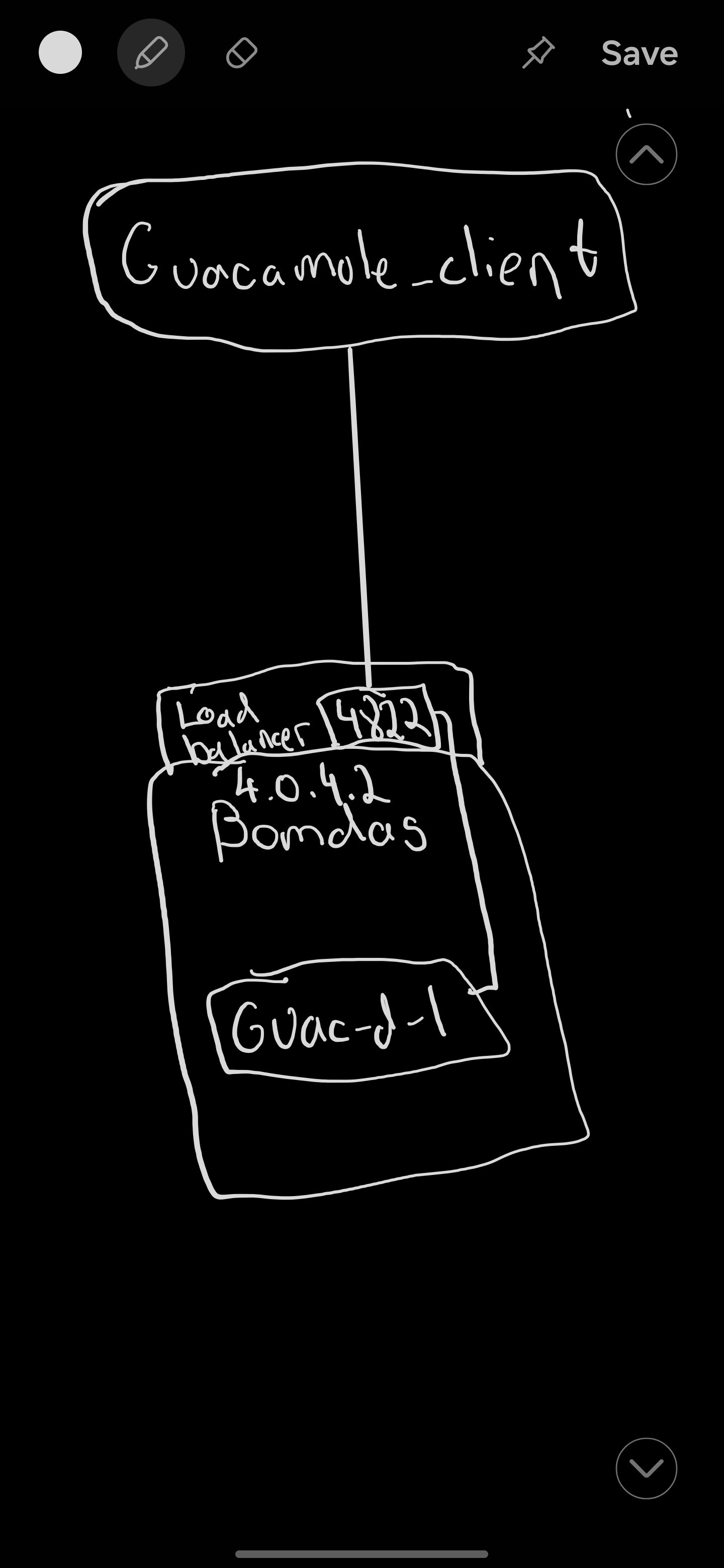

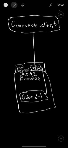

Now my final method that i want to achieve is the following…
I want to create 3 guacd containers in the incus network… so for bomdas network i would have.
guacd-1,guacd-2,guacd-3

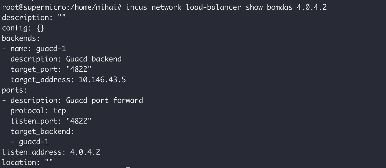

Since guacd works by having guacamole-client connect to its port on 4822 i created a load-balancer on bomdas (with uplink 4.0.4.2)
And put all guacd containers to port forward 4822 as target_port and listener_port on 4.0.4.2 as the listener address … so now if im outside the incus network i should easily be able to connect to 4.0.4.2 and access port 4822 without issue.
It doesnt work… and id like to understand how can i figure out why it doesnt work ? From the logs i gathered on guacamole-client it doesnt seem to make the connection to guacd, and guacd doesnt see any incoming attempts.
Any help with this would be absolutely wonderful and id greatly appreciate it.
this is a representation of what id like to achieve for this…

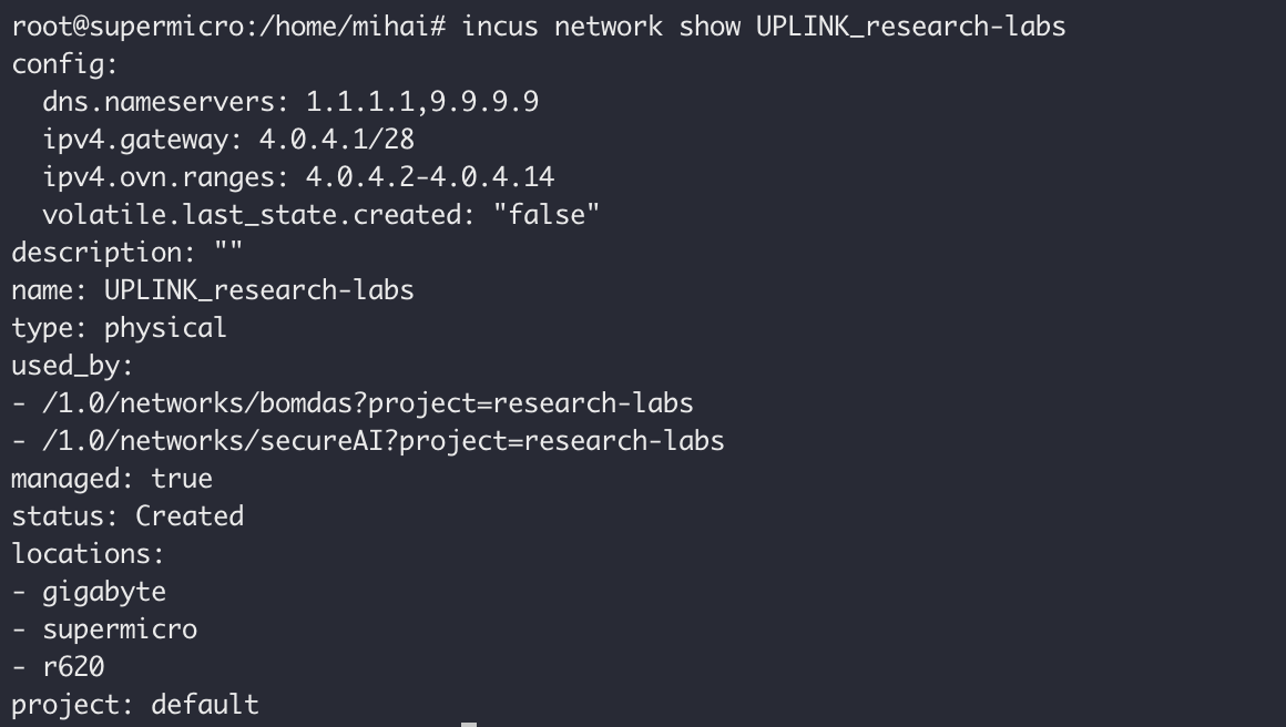

Here are my settings as well for UPLINK network and ovn network and load-balancers…

this is the UPLINK i created for that interface

and the load-balancer
