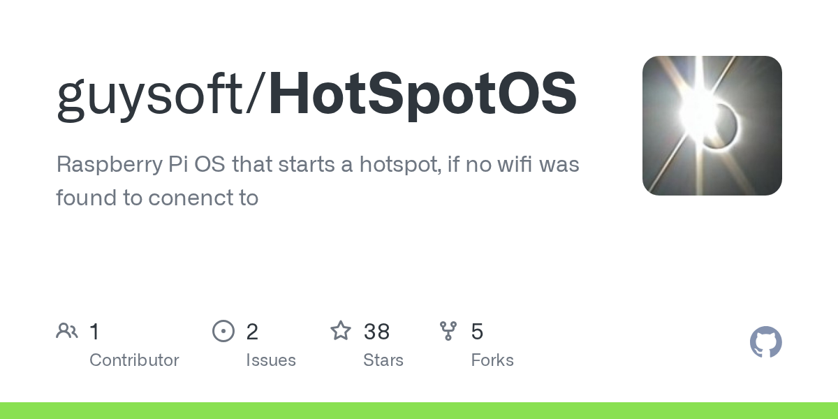

I was just gping through some pld research from within the past 3-5 years . . .
I knew I came across something.
Maybe this could have OpenWrt?
I hope this helps. Or at least is a stepping stone in tge right direction . . .
