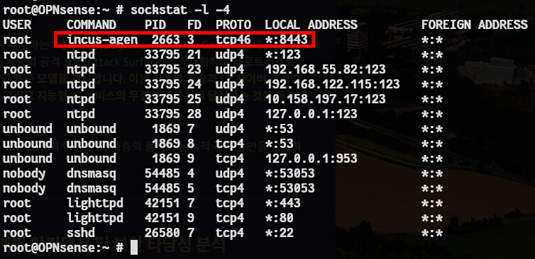

Step 5 - Service Start and check port
service incus-agent start
sockstat -l -4

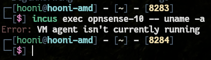

Step 6 - Try communication
Gemini excuse is because of agent.conf.
I don’t think agent.conf is not existing FreeBSD. So It is not concern.
We are argued on it. So I need professional advice.
It’s all what I have done with Gemini.
Could you share your hand for me to use incus-agent on opnsense?:sweat_smile:

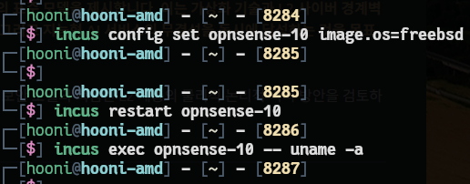

Nah, Gemini’s spitting nonsense, as usual.
Did you set the image.os configuration key on your instance? On Incus 7.0, you can set it to something containing opnsense (case-insensitive), but on Incus 6.23, it needs to be set to something like freebsd.
But note that support for FreeBSD derivatives hasn’t been tested yet.
Thanks for your advice.
It’s work. ^^*

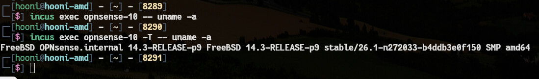

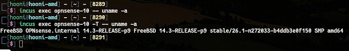

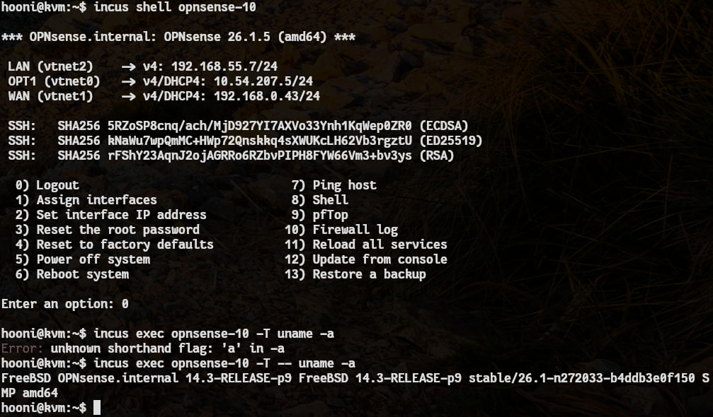

As a side note, I encourage you to run non-interactive commands with -T, as you may not see any result without. This is needed because of a fundamental difference between how Linux and FreeBSD allocate terminals.

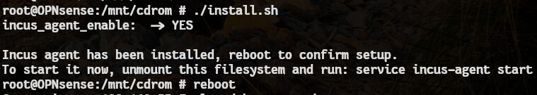

Wow, incus 7.0 is great.
Installing incus–agent on OPNsense is very easy.

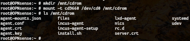

Step 1 : Add agent disk
incus config device add NAME agent disk source=agent:config
Step 2 : mount cd inside the instance
mount -t cd9660 /dev/cd0 /mnt/cdrom
Step 3 : execute install.sh
./install.sh
Step 4 : open shell
incus shell opnsense-10
incus exec opnsense-10 -T -- uname -a
Thank you for all your efforts.^^
