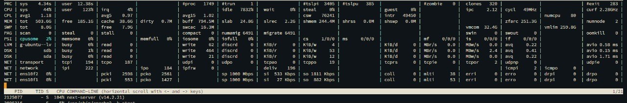

Hey, I am facing a issue regarding high memory usage by a container which is running next-js web application. I assigned 4gb RAM to the container by now when i checked the host usage it is showing high memory usage and upon debug I found that container is exceeding the memory limits. What is the way to restrict?

Right now there’s a cash and slab showing high numbers.
