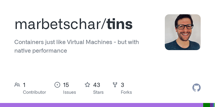

In case you want to experiment yourself
Feel free to clone the project from GitHub, as of now Ubuntu Focal and Ubuntu Bionic are the only two Desktop Environment enriched Distro flavours.

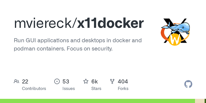

Interesting comparison (by mviereck, you already discovered his repo I read):

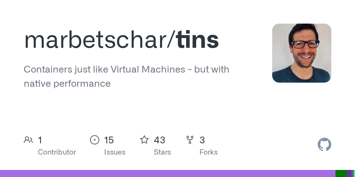

I have tried to use tins in a LXD container, that supports nested containers.
$ lxc launch ubuntu:18.04 tins --profile default --profile x11 -c security.nesting=true
Creating tins
Starting tins
Then, got a shell in there.
$ lxc exec tins -- sudo --user ubuntu --login
ubuntu@tins:~$ git clone https://github.com/marbetschar/tins.git
Cloning into 'tins'...
remote: Enumerating objects: 256, done.
remote: Counting objects: 100% (256/256), done.
remote: Compressing objects: 100% (166/166), done.
remote: Total 849 (delta 165), reused 176 (delta 88), pack-reused 593
Receiving objects: 100% (849/849), 820.42 KiB | 2.08 MiB/s, done.
Resolving deltas: 100% (531/531), done.
ubuntu@tins:~$ sudo lxd init
ubuntu@tins:~$ sudo apt install build-essential valac libjson-glib-dev libgtk-3-dev libgranite-dev desktop-file-utils
ubuntu@tins:~$ cd tins/
ubuntu@tins:/home/ubuntu/tins$ ./install.sh
The above instructions have two issues,
  1. The ubuntu user may not be a member of the lxd group, so add them manually.
  2. The PulseAudio socket location is hard-coded, so the container will fail to start. The code should look for PULSE_SERVER, if it exists, and use that location instead of the default.
By having a reproducible environment, it should be easier to develop.
