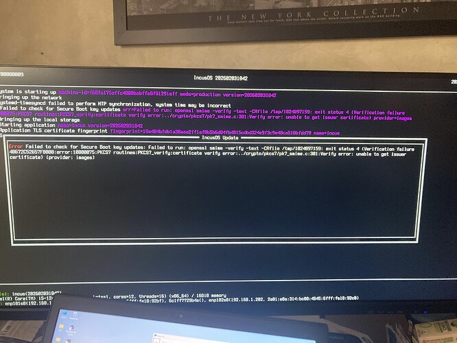

I had a “Secure Bios Violation” with AMI aptio (cf56pro) before but 3 clicks en keyboard let think error.
From this update of IncusOS, new version freeze the boot. Keep in mind the case like older geek (62) that install it with some previous error messages ;-))
Your ambitious to secure the servers, nas or homelab (laptop next with gpu pass through)) but appliance is great !
Version 202602031842 has a known bug ( Bad IncusOS update (202602031842) - #4 by stgraber ); if you reboot into the prior installed version of IncusOS it should pickup an update that fixes it and then your system should boot properly again.
I’m not sure what the “Secure BIOS Violation” was, but from the screenshot IncusOS booted correctly, so that means the Secure Boot certificates are installed and the TPM is working as expected.

I think that come from EFI check certificat with the AMI Bios in cf56pro.
