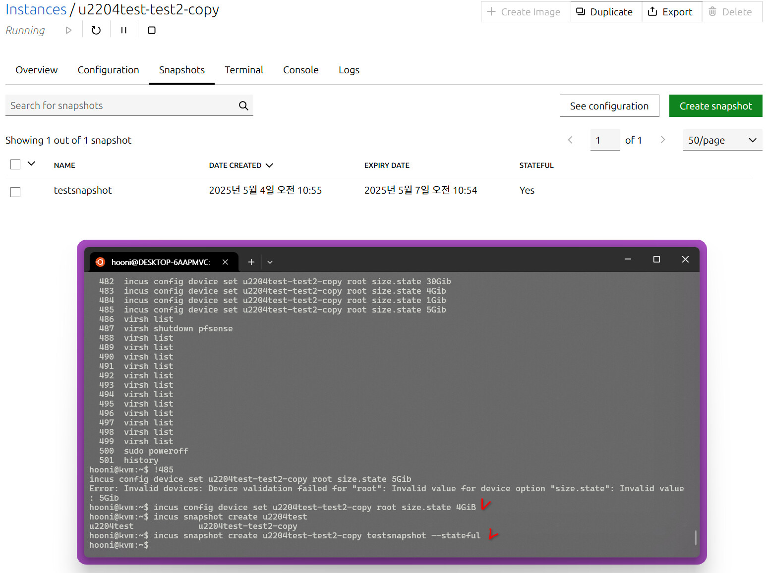

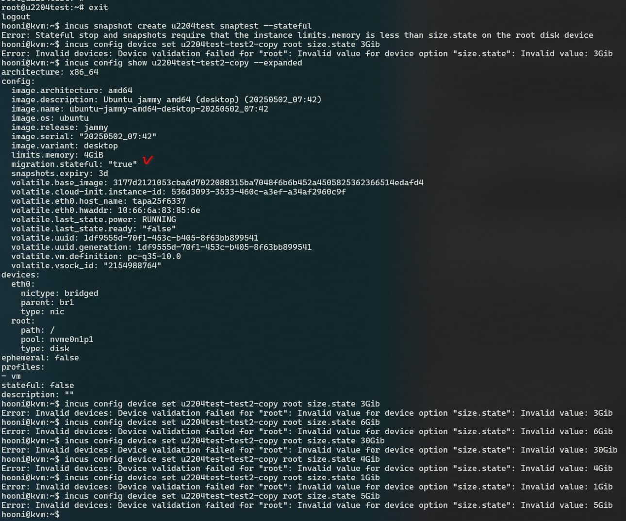

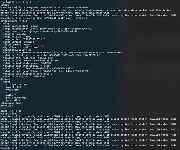

I’m trying to create a snapshot with the stateful option in a running VM.
The state of stopping VM to create a snapshot is not the problem.
But running VM, including some conditions.
migration.stateful, and size.state.
To set up size.state, what size and how to set up, I would like to know.
The image below is what I have done.
Gib isn’t a valid unit, GiB is.
Wow, I am so happy. :joy:
Because I was almost there.^^;
And, after the setup of size.state, the snapshots work fine in the running state of the VM.
