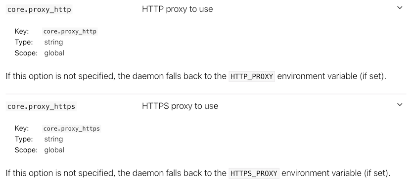

The incus documentation is here: Incus documentation
Type “proxy” into the search box. This will lead you to settings core.http_proxy and core.https_proxy
It does say it will pick up HTTP_PROXY and HTTPS_PROXY, but I presume those have to be set in the environment that starts the incus daemon (e.g. from systemd unit file) - setting them in your shell before doing an incus init won’t make any difference.
Hence I think it’s easier to apply those incus configuration settings directly.

I was using HTTP_PROXY and HTTPS_PROXY, and incus just ignore my setting.
I succeeded to pull image after set core.proxy_https and core.proxy_http.
