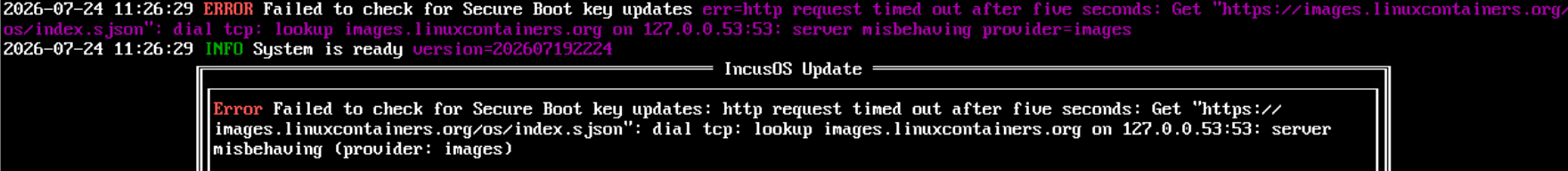

Status VM Installation: Installation starts after recreating the VM. I guess that I started the VM too early last time.
Currently it fails to query the remote keys (like in any enterprise environment). I guess I will find some documentation for this.

Right, you mentioned the system is completely offline. Installing in that kind of environment is slightly more involved.
IncusOS itself doesn’t actually include Incus or any “primary” application out of the box.
That gets downloaded on first boot which is failing in your case as you’re in an offline environment.
In offline environments you need to use a secondary drive that includes the full update from the image server so it can install from there. We actually have some built-in logic in the image customizer but it’s not currently exposed in the web UI. I’ll see if I can easily surface that so you can grab the second ISO and get that machine fully installed (you’ll need to attach the second ISO and then reboot to have it picked up).
The download website now has an option under Advanced which allows you to download the required secondary image.
