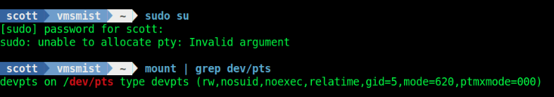

The really insidious problem occurred after rebooting the host which is the Ubuntu 24.04.3 LTS server. After a reboot:
mount | grep devpts
reveals devpts mounted with ptxmode=000
devpts on /dev/pts type devpts (rw,nosuid,noexec,relatime,gid=5,mode=620,ptmxmode=000)
Worse yet:
ls -l /dev/ptmx
reveals that the symbolic link is GONE!
lrwxrwxrwx 1 root root 13 Aug 15 20:10 /dev/ptmx
I have started from scratch rebuilding Ubuntu and reinstalling Incus 5 times now and each time this happens. It happens right after incus starts.
I don’t have to tell you that a corrupted PTS results in no ability to either ssh or sudo.
