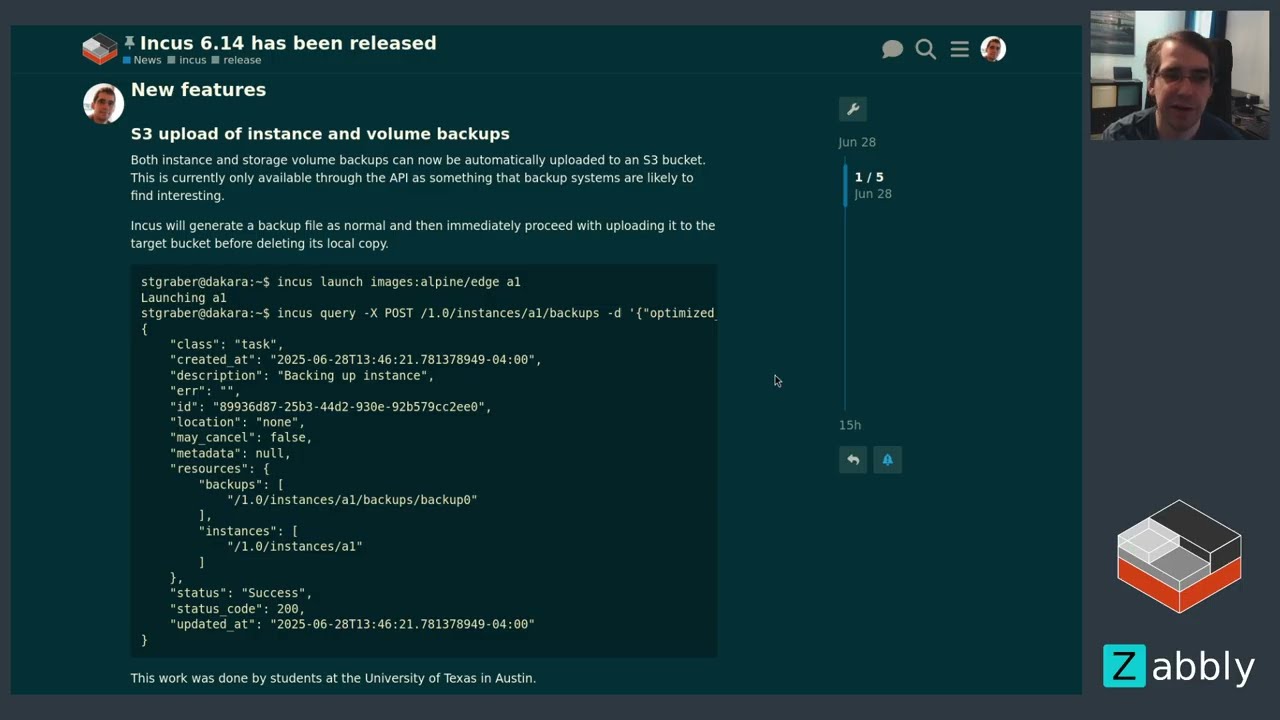

S3 upload of instance and volume backups
Both instance and storage volume backups can now be automatically uploaded to an S3 bucket. This is currently only available through the API as something that backup systems are likely to find interesting.
Incus will generate a backup file as normal and then immediately proceed with uploading it to the target bucket before deleting its local copy.
stgraber@dakara:~$ incus launch images:alpine/edge a1
Launching a1
stgraber@dakara:~$ incus query -X POST /1.0/instances/a1/backups -d '{"optimized_storage": true, "target": {"protocol": "s3", "url": "https://storage.googleapis.com", "bucket_name": "incus_backups", "path": "my-backup.tar.gz", "access_key": "ACCESS-KEY", "secret_key": "SECRET-KEY"}}' --wait
	"class": "task",
	"created_at": "2025-06-28T13:46:21.781378949-04:00",
	"description": "Backing up instance",
	"err": "",
	"id": "89936d87-25b3-44d2-930e-92b579cc2ee0",
	"location": "none",
	"may_cancel": false,
	"metadata": null,
	"resources": {
		"backups": [
			"/1.0/instances/a1/backups/backup0"
		"instances": [
			"/1.0/instances/a1"
	"status": "Success",
	"status_code": 200,
	"updated_at": "2025-06-28T13:46:21.781378949-04:00"
This work was done by students at the University of Texas in Austin.

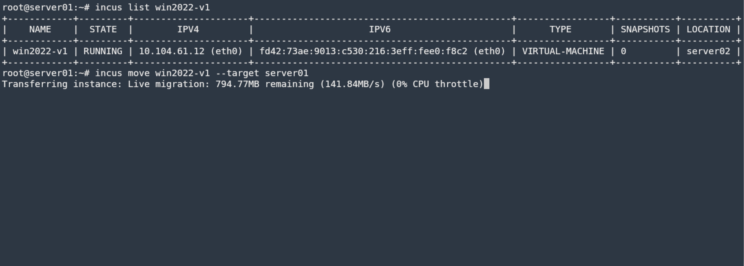

Live migration tweaks and progress reporting
To reduce the migration time for VMs that very actively modify their memory, we have made a few tweaks to the memory transfer logic.
Incus will now more aggressively throttle the CPU of VMs being migrated starting with a 50% throttle after the first attempt and going lower and lower as changes are still detected at a high rate.
On top of this, Incus will now provide memory migration progress.
