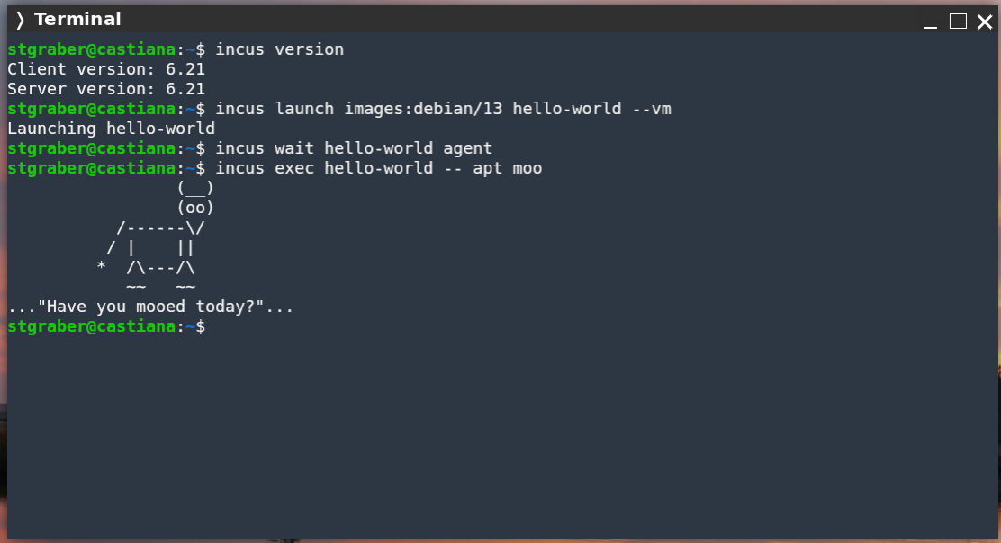

incus wait command
A new incus wait command has been introduced which currently allows waiting for a few different things to happen to an Incus instance:
  • The instance has reached a specified state
  • The VM agent is ready
  • The instance has acquired an IP address
This may get further expanded in the future to add additional common conditions.
stgraber@castiana:~$ incus launch images:debian/13 v1 --vm && incus wait v1 agent && incus exec v1 -- echo "Hello world"
Launching v1
Hello world

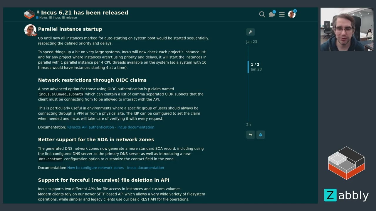

Parallel instance startup
Up until now all instances marked for auto-starting on system boot would be started sequentially, respecting the defined priority and delays.
To speed things up a bit on very large systems, Incus will now check the instance list and separate instances with boot priorities/delays from those that don’t. Those that don’t are then batch-started with one parallel instance start per 4 CPU cores, those instances with priorities or delays will then be started sequentially as normal.
Network restrictions through OIDC claims
A new advanced option for those using OIDC authentication is a claim named incus.allowed_subnets which can contain a list of comma separated CIDR subnets that the client must be connecting from to be allowed to interact with the API.
This is particularly useful in environments where a specific group of users should always be connecting through a VPN or from a physical site. The IdP can be configured to set the claim when needed and Incus will take care of verifying it with every request.
Documentation: Remote API authentication - Incus documentation

Thanks for just another cool release!
Does incus wait make use of /1.0/operations/{id}/wait or some other specific API?
No, just a busy loop checking the state in the API every 5 seconds.
We could use the /1.0/events API to monitor some stuff like the status= conditions, but for everything else, we need to poll.
