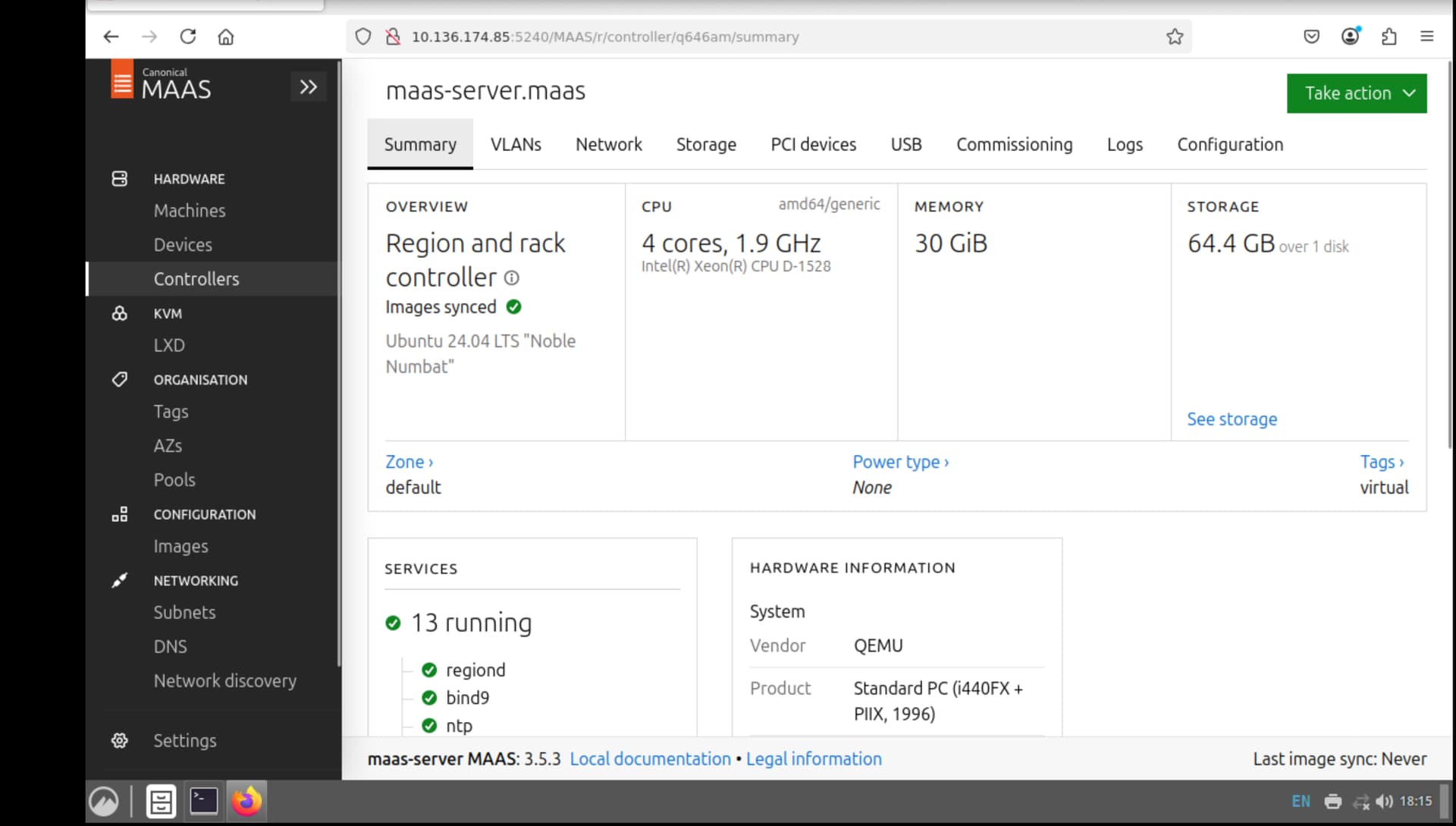

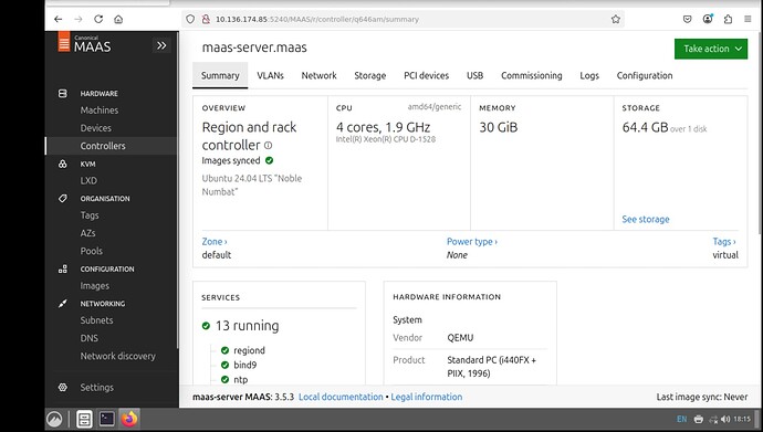

Created an Ubuntu24.04 VM with incus and installed snap+multipass on it. Looks interesting though. Will try to play around with maas.yml with incus
I give up on maas.yml
Will stick with incus + incus webui inside ubuntu vm for running simple labs with nested vms and containers.
I’m getting around to it now, will post a solution if I’m successful
